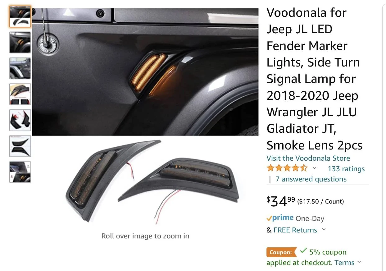

You can wire these however you please. They provide 3 wires: 1 ground, and a lead for each of the amber and white lights. I plan to wire the amber to my blinker so they blink with them, and then wire the white to my courtesy lights so they turn on when I unlock my JT. You could also wire the white or amber to a switch so they just turn on whenever you decide to switch them on, which could be great for camp/work scene lights.
I would like your opinion. I have attached a PDF of the wiring as I understand it for my '18 JL Sport, no LED package which means no factory DRL. The PDFs are from the wiring diagrams available elsewhere on this site. Let me know if I'm close. Thanks.

Installed some cheap ones from Amazon today with new fenders. Just wired them as turn signals as they’re pretty bright.

An update on my install, I got the DRL portion of this light wired to a switch on my trigger six shooter wireless switch system. One of the lights quit working after less than six hours. I have ordered a replacement from Amazon that should be here sometime this week. The turn signals are working fine on both, and I checked all my power connections to make sure that power was still going to the light itself. Fortunately I ordered additional fender clips so I won’t have to wait on those as well.

Installed today, could not get the DRL to work, but I didn’t really care about that anyway. The turn signals are cool though..
make sure to buy extra clips, you will break some off when removing the fenders. I recommend getting at least 10.
https://www.justforjeeps.com/68395634aa.html
GemPro Side Marker Light LED... https://www.amazon.com/dp/B09HKGN1WM?ref=ppx_pop_mob_ap_share
I ended up wiring the DRL to a switch on my Trigger Six Shooter plus so I could turn them on/off whenever I wanted to.
Another note, I had to replace the drivers side because the DRL (White) light failed after less than 2 hours of usage and only 12 hours on the Jeep...
That one looks a bit different. Can you share a link to which one you bought?
