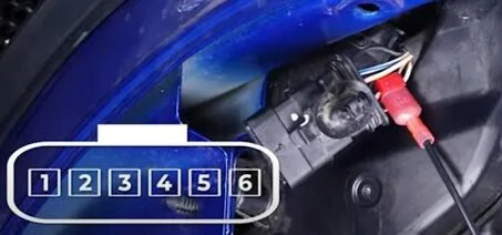

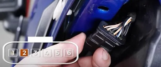

This is from the installation video. There isn't a whole lot of room there for a splice and I wouldn't want it that close to the connector. I don't plan on changing out the fenders, so I guess alternatively I could splice into the harness coming from the fender.
