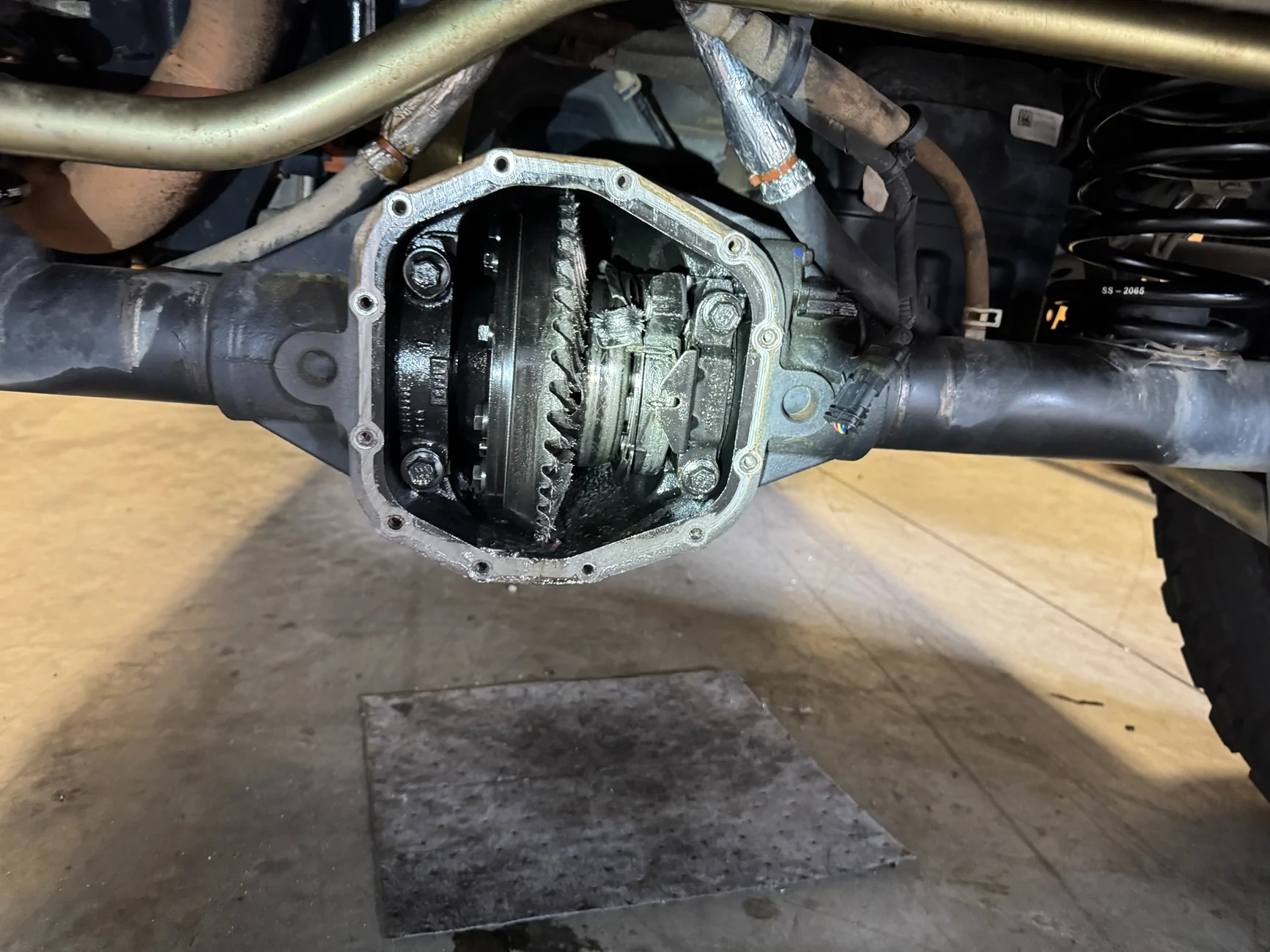

Well, my hand has been forced, lol. My wife pretty much drives her a 0 or WOT, and she blew up the rear diff this weekend.
I'm going to stay with 4.88 since the set should be a little stronger, but towed it over to the shop to get regeared this morning.

Gonna swap the rear for a 392 Full Float M220.
Didn't want to risk reusing anything after it looked like this. 🤮

Full float rear and 4.88s are in. I dumped my MC covers and skids and went to Yukon Hardcores.
I did drive the Jeep from the shop to the dealer for the flash, drove fine but did not have ABS, TC, or Cruise.
I don't drive the JL a ton, but the 4.88s seem like a decent choice, I think the 5.13s would be solid option as well.
I did notice a marked improvement in regen braking with the new gears.
