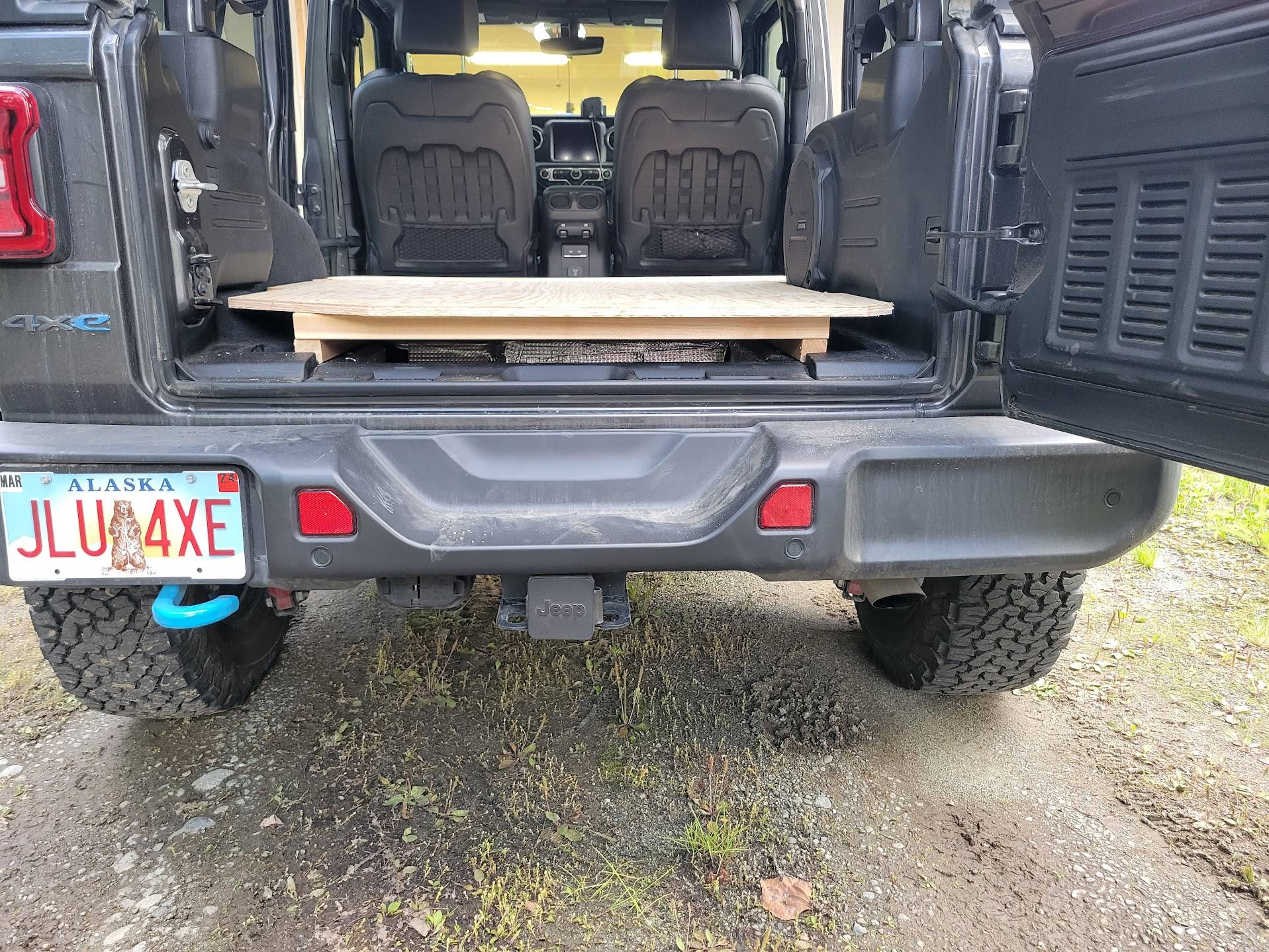

Well that's very nice looking!
There's less clearance on the driver's side due to the gate latching mechanism. I think that's why the stuff has to go on the passenger side. Yes, the other Jeeps have that too, but the seatback hump eats up space in the 4xe.
I made my own full seat delete platform, but would be really tough to make a retail solution for it. It's easy enough to drill out the welds for the brackets that hold carpeted trim piece, but in front of that are stout seat mounting studs sticking straight up 2" over the extra sheet metal hump behind the battery. This is where I used 2x2 (1.75") pine to frame my platform out, with 5/8" plywood on top. This elevates it quite a bit. Could go lower, but then the studs would be sticking out.
