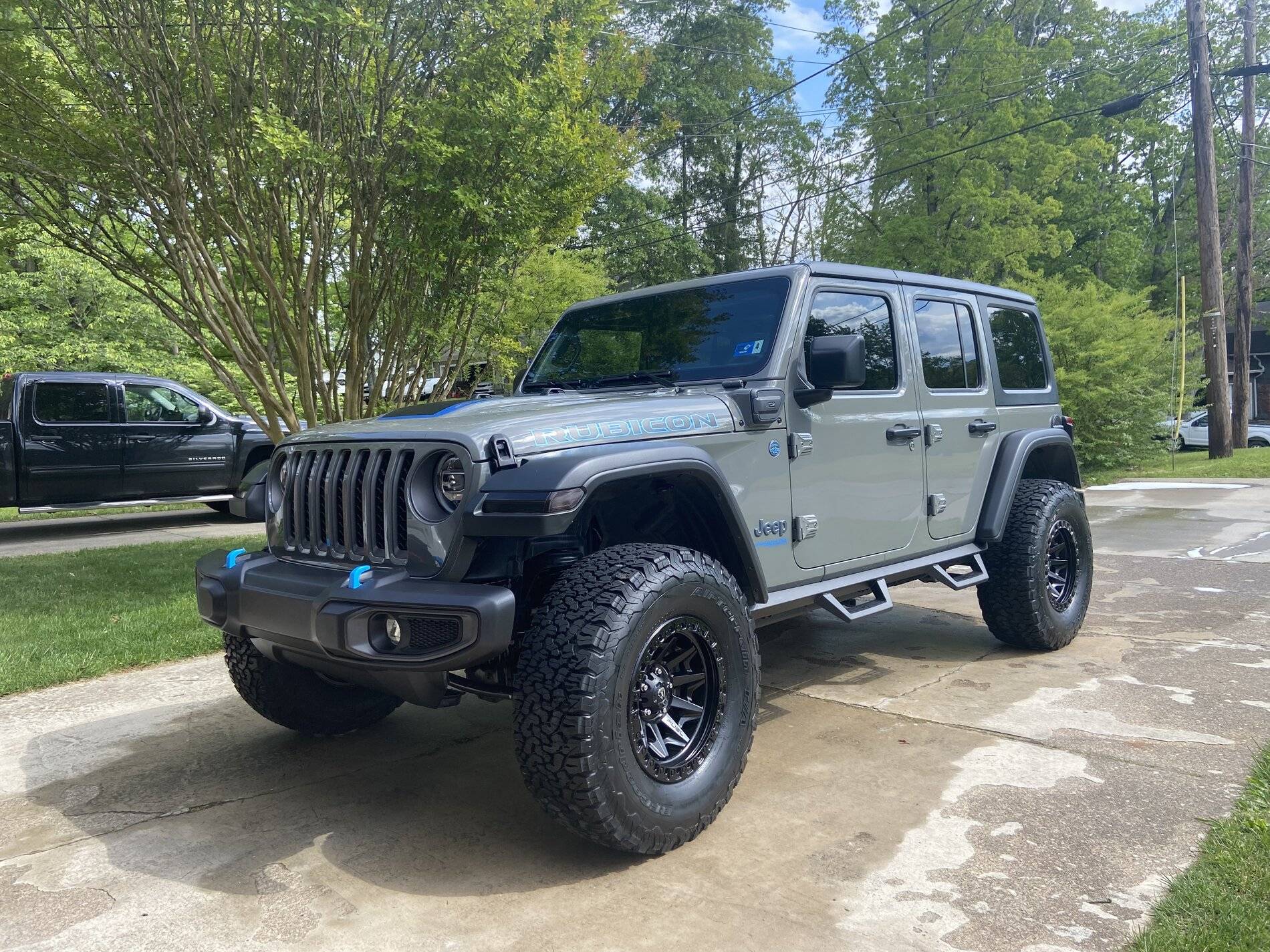

Now that looks like a real lift. Ive got 35s as well but mines
is about an inch shorter (that's what she said ?)
I like the look. I am running 315's on my 4xe too. Maybe its just the angle but are you running spacers?

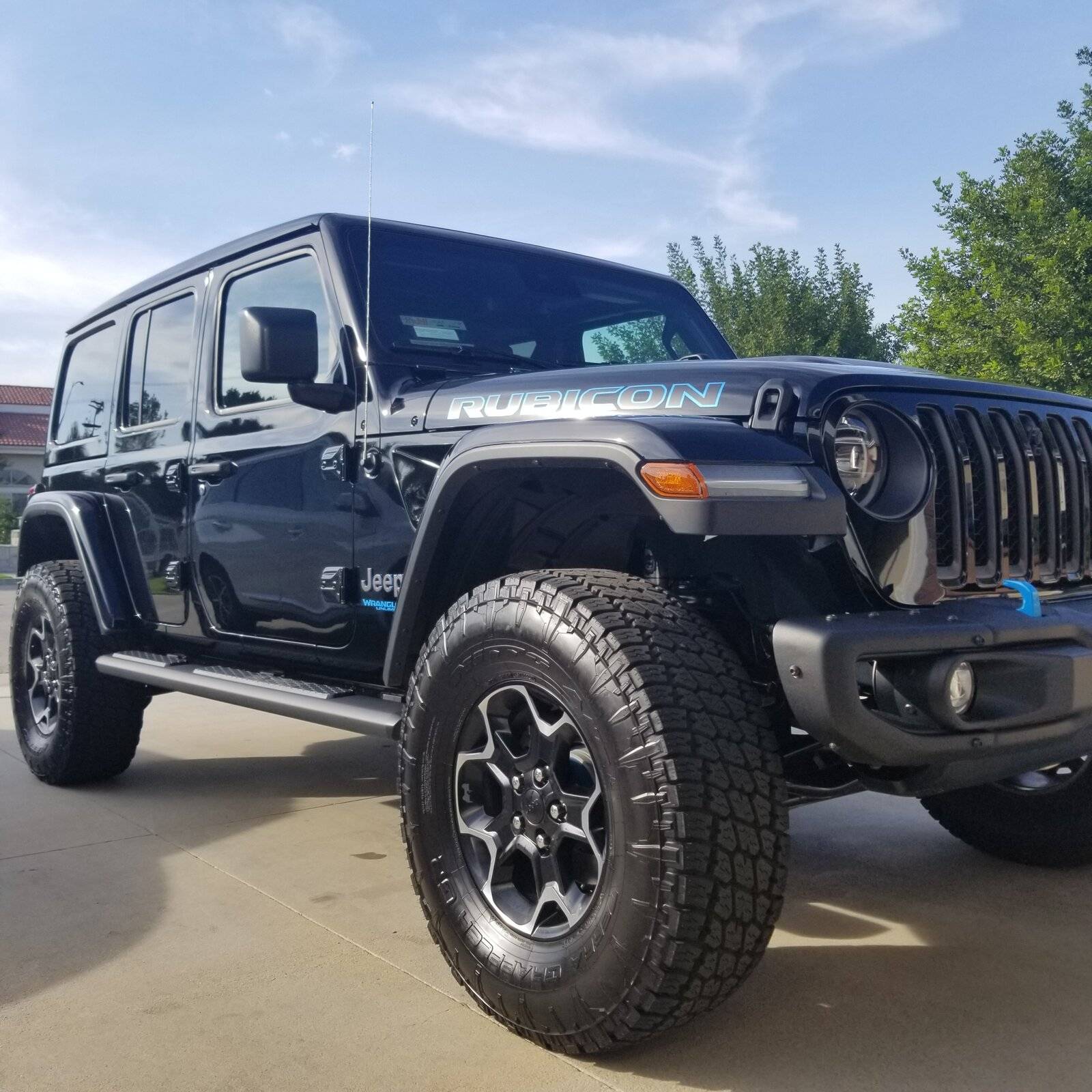

Do you mind measuring from the top center of the tire to the inner wheel well? Best I could tell, stock is about 7.5” so I’d expect yours to measure about 10” in your case.
Can you also confirm that the dealer installed the 4XE 2” lift with no other modifications like spacers or something?
Just thought, Stock JLRU has 7.7 from top of thee 33" time to the bottom on the fender. If I have 10" after the lift but that is with 35's. so the tire took up another inch. That would tell me the dealer raised it 3.5" above stock.. right?
