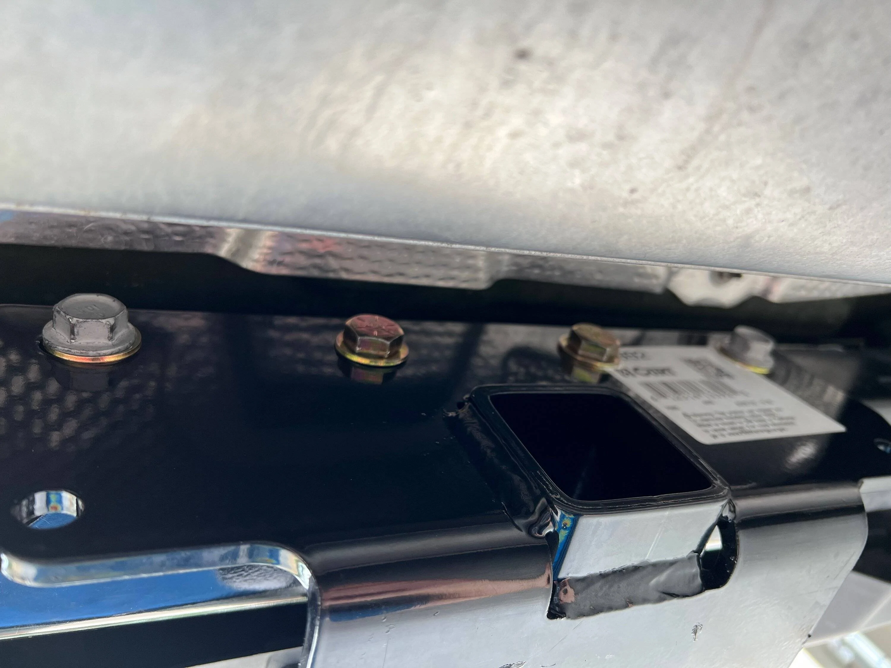

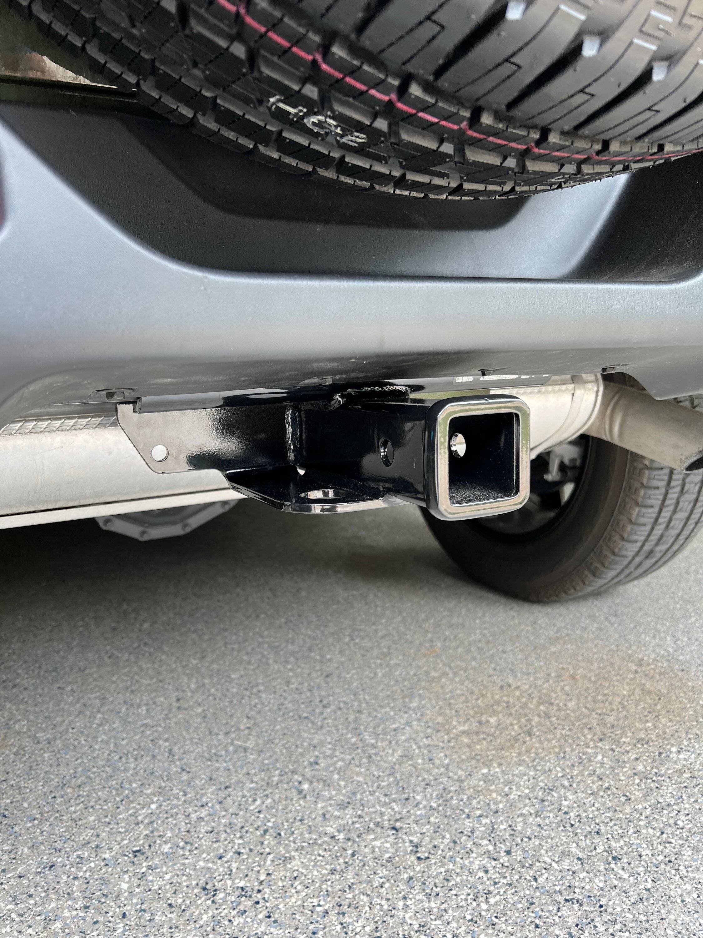

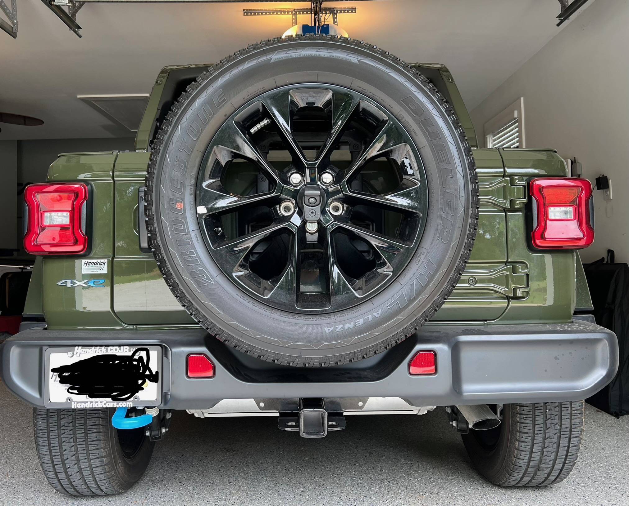

Installed the CURT 13392 Class 3 Trailer Hitch this morning. High quality product for racks or towing. I have a trailer I tow for lawn work as well as a carrier rack. It would have taken 15 minutes, but the bumper bar had a weld seam on the top rear that was blocking the fit. After a few minutes with my Dremel and a grinding bit I was good to go. I was able to leave the bumper spacer in place and reused the 2 bolts that were already there to match the integrated nuts. I combined with 2 from the CURT install kit for the empty holes. Bolts need to be torqued to 110lb.
