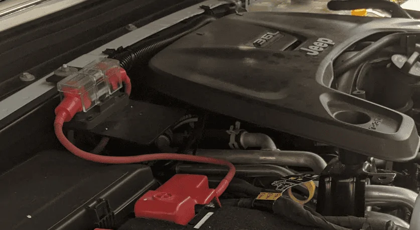

Here's a pic of the fused 6ga across the firewall:

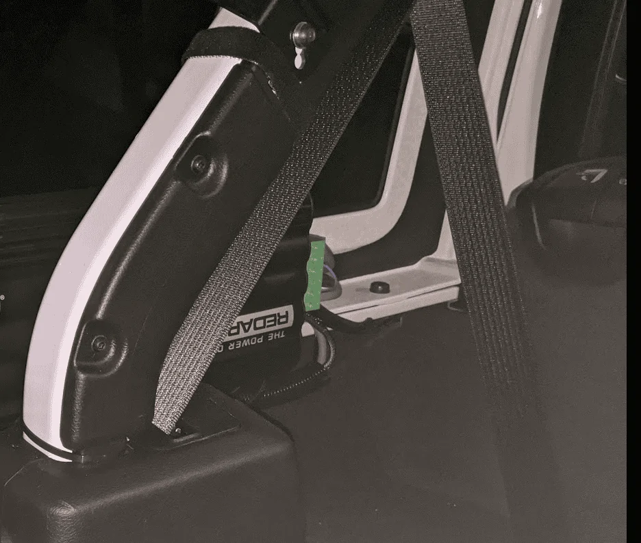

it runs to a Redarc BCDC near the wheel well:

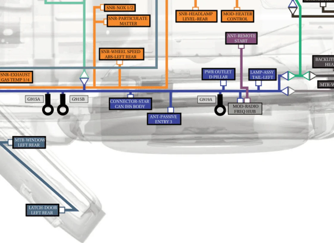

I decided to use the ground by the drivers side rear passenger seat, G915B, only need to remove a small amount of trim to get the carpet out of the way:

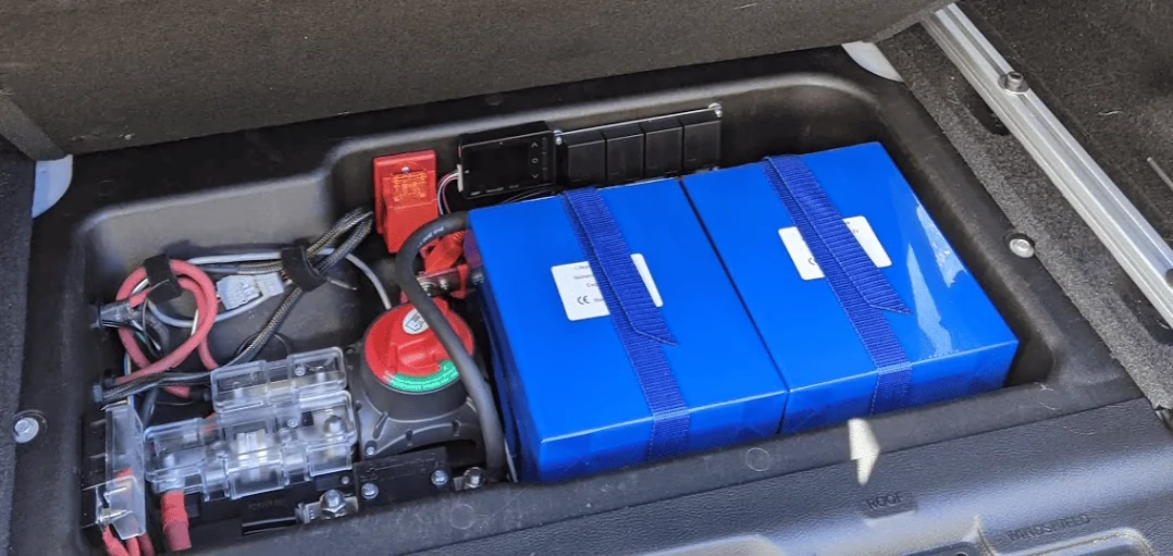

My first rev of the project (I have a battery in the under floor storage) I ran the wires inside the cargo area. I'm much happier with my current rev where I drilled a hole from the top of the wheel well and routed wires behind the inner wheel well and then used cable glands to enter the under floor storage compartment from underneath. I have a lot going on in the back corner where the hardtop washer/wiper connections are (hatch light, backup camera, compressor wiring) so let me know if you have any questions about running wires back there - I've had that big trim piece off about a dozen times.
