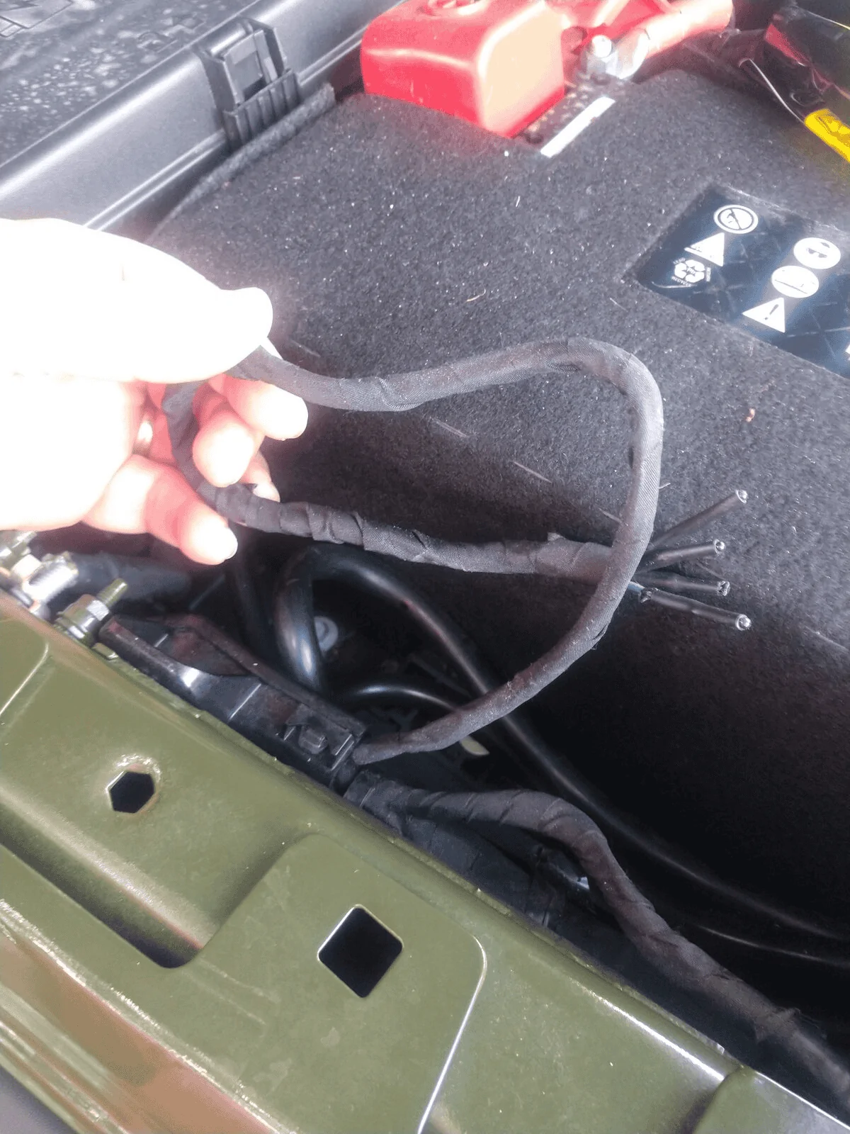

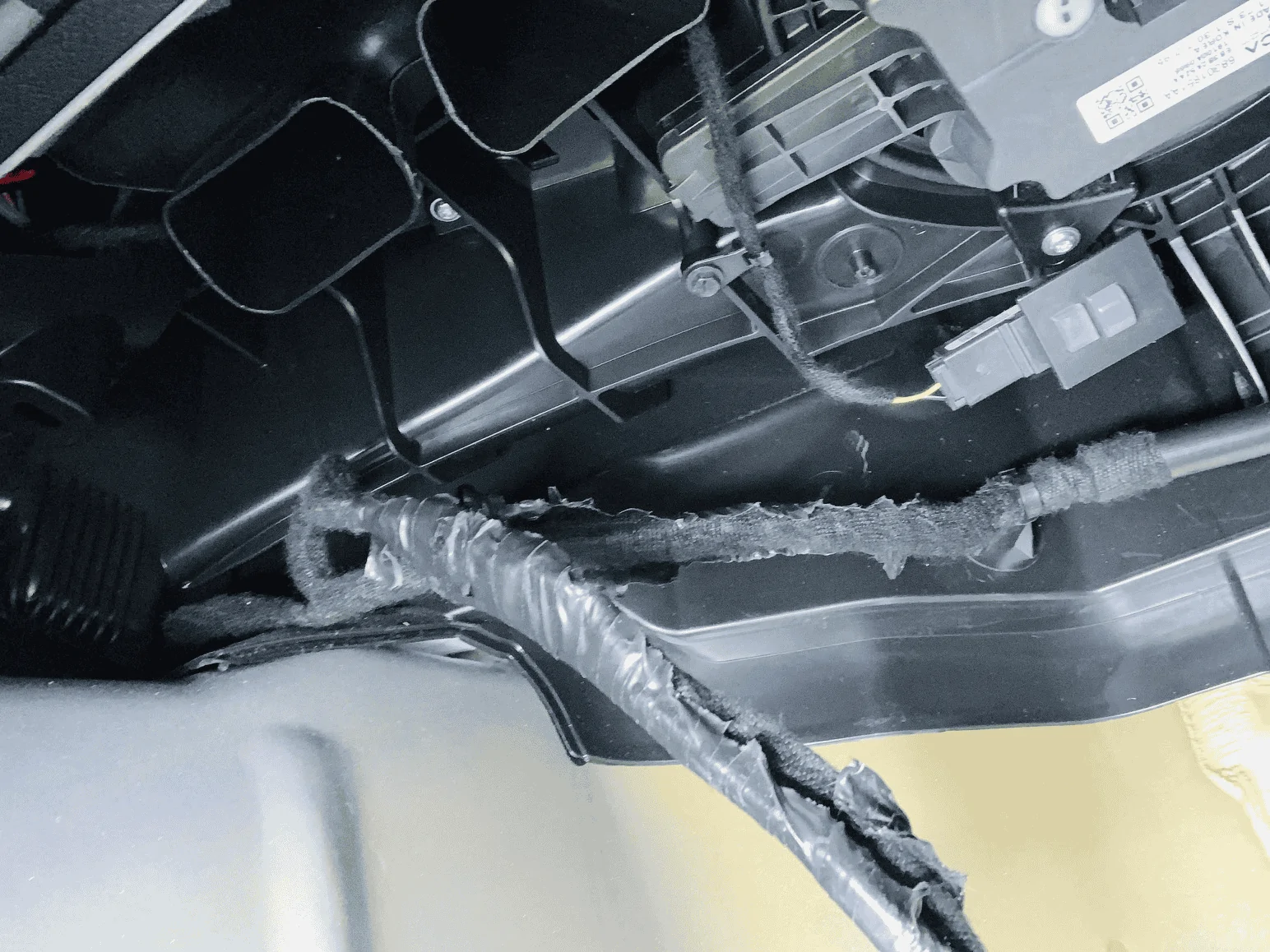

I just bought a 2024 Wrangler Willy’s and can’t figure out where to hook up anything directly controlled by the 4 aux buttons. Any suggestions?

Two options, one is by the battery under hood, the other is in the passenger footwell. Footwell also has IGN+ and B+ available. 1 and 2 are 40 amp relayed, 3 and 4 are 15 amp relayed.
IIRC they are taped up, look for a wire run that just ends.

I believe there pigtails both behind the glove box and in the engine bay near the battery. You should be able to find many youtube vids on how to hookup.

If you have the installed aux buttons from the factory there are leads on the passenger side up behind the glove box and some in the engine compartment down by the battery.
Pretty sure there is something in the manual if nit youtubs has plenty of vids.
Also, IGN+ and B+ are 10A
