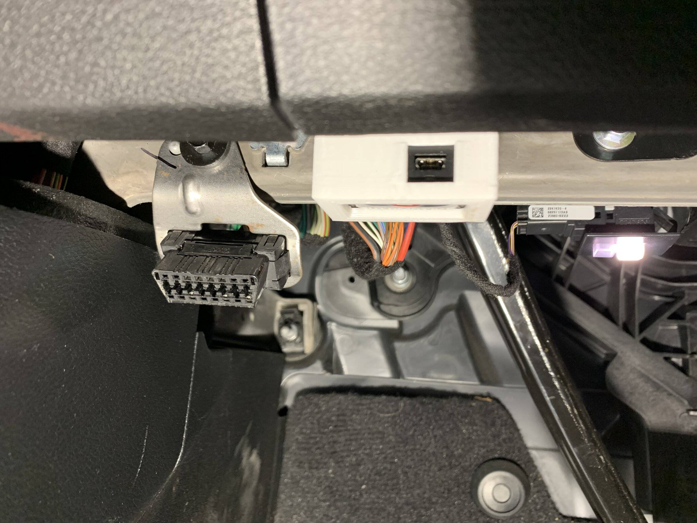

No more fooling with Velcro or Zip Ties when you go to remove the Tazer JL or when you go to put it back in place, behind the plastic panel.
The one I've shared allows the Tazer Mini to slide freely up and out of the holder, and is within reach without removal of the kickplate. There are no clips in the design (by design) and no need to cut any ties when mounted on the lower bar as indicated.

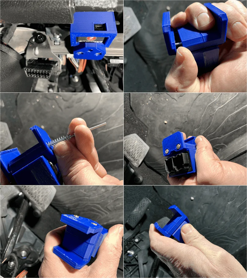

As described. A "phone holder" style spring-loaded clamping mechanism that allows for zero bolts/cable ties.
There's a bend in the lower bar -- specifically the bar closest to the diagnostics port -- where there's ample purchase for the jaw depth.
Jeep Wrangler JL 3D Designer Section for 3D Printers tazer-spring-clam
Top left - ideal mount spot.
Top right - compression springs pull the jaws together.
Middle left - compression springs used: 7/32x1-1/4 (Qty: 2) and the thread rods (4-40 x 2)
Middle right - view from top - inserts for #4 nuts.
Lower left - another view of the jaws, closed.
Lower right - another view of the jaws, showing depth.
USB port with blinken lights still viewable.
Tazer Mini pulls out easily, leaving the holder in place for quick cable change, etc.

Tweaked a bit.
Since the main holder bay that cradles the Tazer doesn’t actually rest against the mount bar anymore, there’s no harm in dropping it down for even easier access, yet within the reach of the wiring that connects to the Tazer.
Also dialed in the clamp height and compression strength.

With the kick panel in place. Blinkin lights & usb access just below the panel.

Well, @mazer ................ geeeez, I said "design it.... 3D print it"..... and you sure did..... I'm impressed..
IF I had that beauty, I would probably stick some fuzzy side Velcro on the plastic that grips the metal support of the JL... That would eliminate any chance of a rattle..
Would truly like to see that goodie in place.... Good for you!

The compression clamp is really tight, but not so tight that the holder can't be mounted/removed in less than a second. ;)
An anal-retentive OCD-type person might design a TPU (rubbery, flexible filament - like I used for the lugnut caps) covering for inside of the clamp jaws that would take care of that.

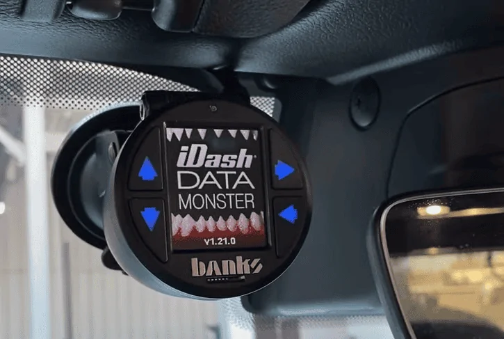

I don't suppose any of you printer folks have a Derringer and pod? I am curious if this screw to the right of it could be used as an attachment point for an arm for a forward mounting solution to keep out of the visor's range of motion.
If that's the rear-view mirror cluster (you have lane tracking?? mine has open space behind it where I have a dashcam mounted), then that looks to be (again, just judging from the image because I'm a Sport S guy) a plastic quick fastener that releases on just a quarter turn of the Phillips head.
If it's a plastic part, then there's not really a good chance of using that as any kind of mount point.

Yea I can only speculate at the moment, no wrangler in hand. I'll look for more tear down images, the gauge weighs very little though.
Have you seen the Aeroforce pod mount? It mounts up by the grab handle on the Driver side of the windshield. Info on that part and install. Its a really nice looking gauge pod, but for me the install took a bit of tweaking to make it strong.
