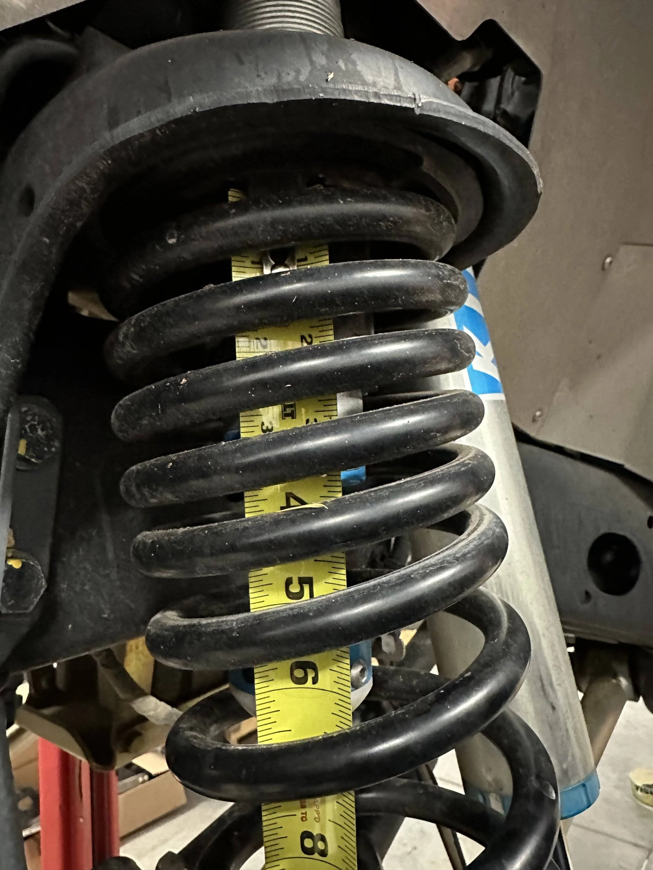

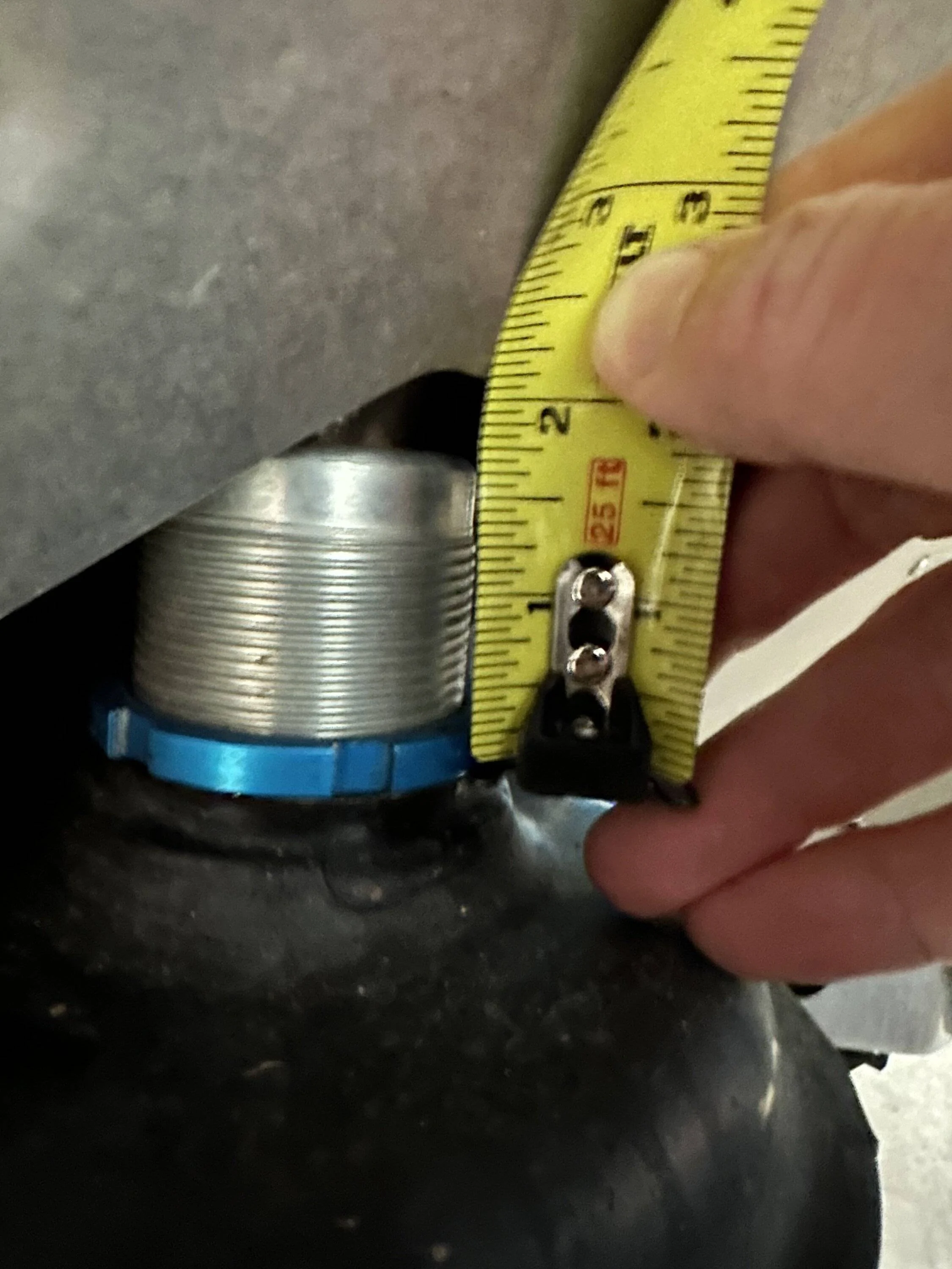

Dude you rock, thank you!!I wanted to expand my answer and give more useful information. Here are some pics and measurements. These are Metalcloak 3.5” 392 springs (same as JK 3.5” springs)

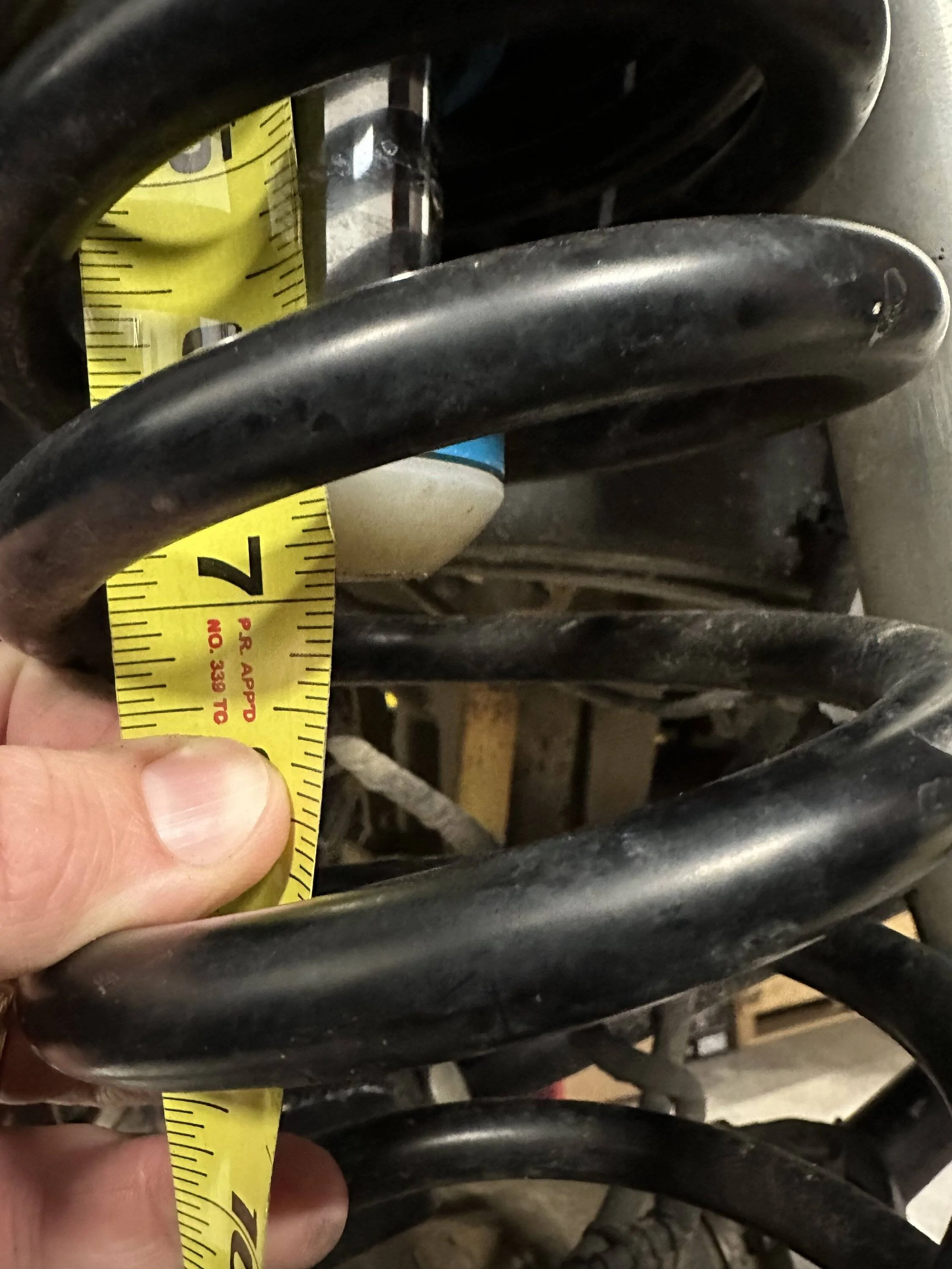

I cut the king bumpstop extensions down to 2” from the standard 3”. I have 3” of uptravel before they engage, for a total of 5” uptravel from ride height.![]()

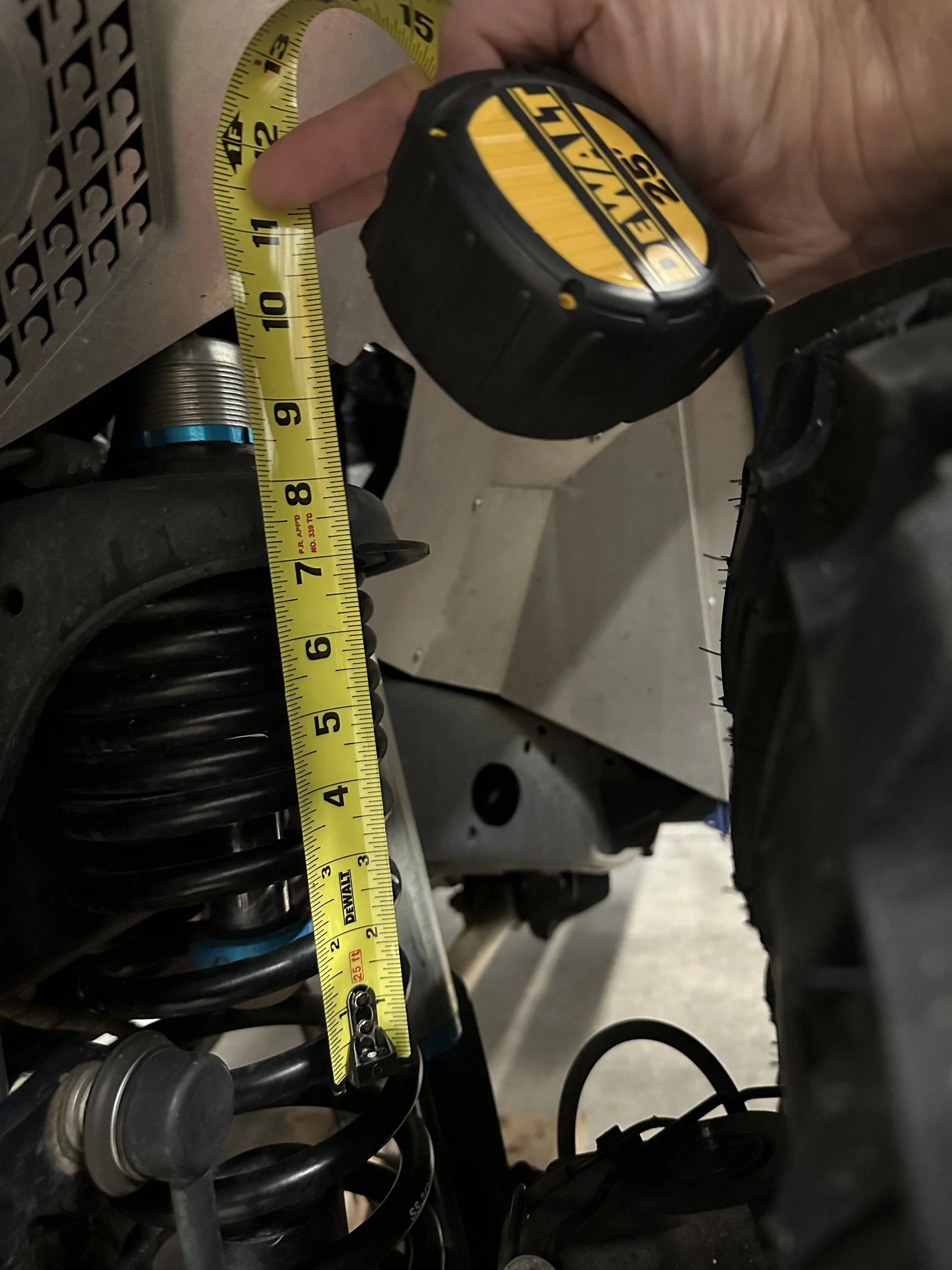

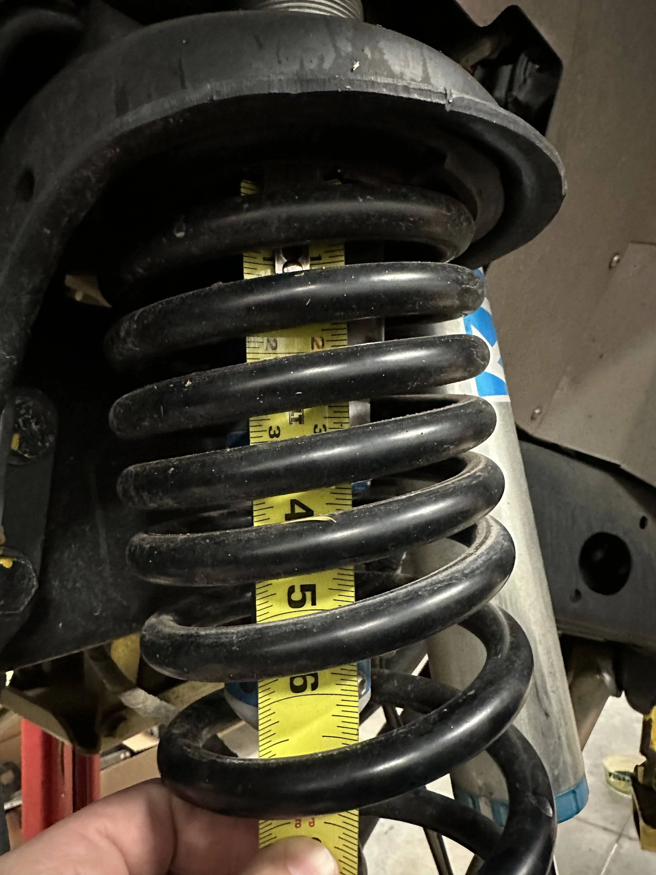

Roughly 7” from lip of spring bucket to bottom of extended bump where mine are set.![]()

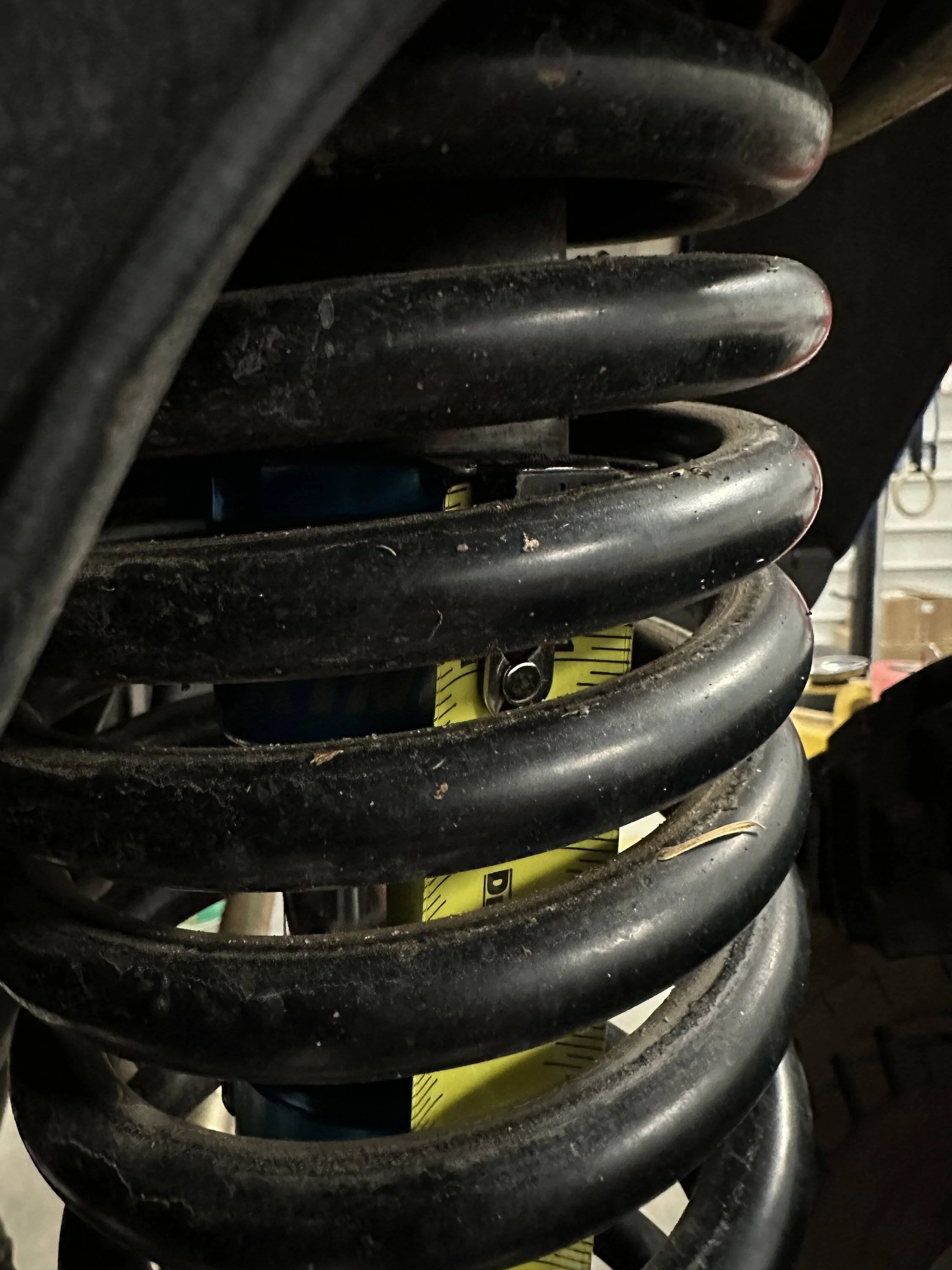

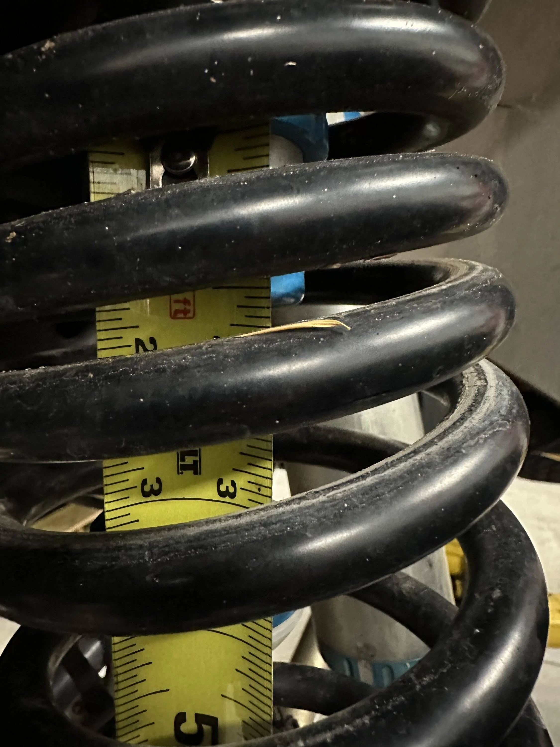

Almost 1 3/4” from top of frame to top of bumpstop![]()
