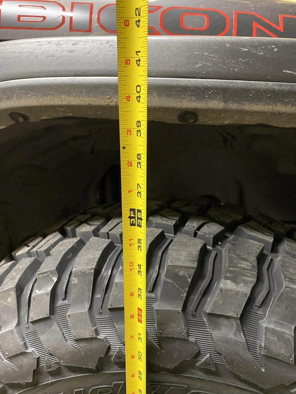

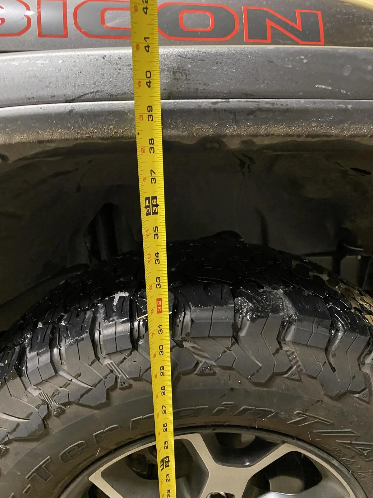

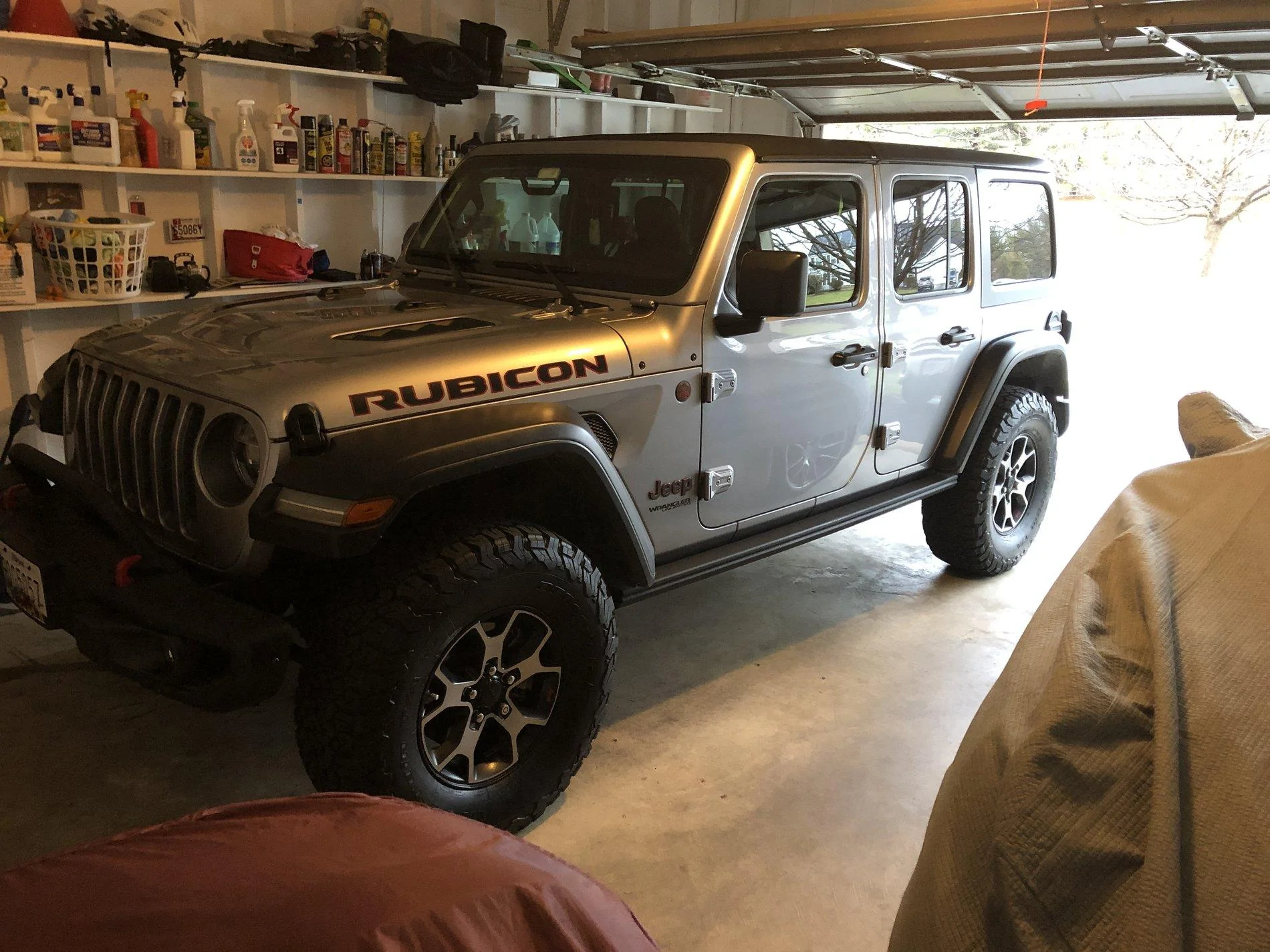

Here are a few picsSo just shy of the 2 year mark and 22k miles on my 2018 JLUR I decided to upgrade the tire size. I stayed with the BFs as I like the quietness, handling, and they were wearing perfect with rotations every 6K miles. I upgraded to the 315/70/17 mounted on the OEM rims. I now have about 200 miles and I have noticed a few things:
I welcome feedback from others that made the upgrade...
- Softer ride, JLUR is taller now noticed that when I cleaned the windshield
- Seems to handle even better on off/on ramps at speeds above 40 not sure why expected the opposite with a taller side wall
- 1st 150 miles felt like shifting wasn't as crisp and a bit sluggish, and down shifts took to long, and my combined mileage went from 17.9 to 15.7 to 16
- next 50 miles things adjusted and back to normal shifting and JLUR felt quicker, and combined mileage indicated 18.3 yesterday, Hmmm I did do one hard launch which chirped the tires and it felt just as fast to 60 mph not sure if that caused a change
- I noticed that digital speedo is 2-3 mph faster then the gps speed
- Called 3 jeep dealers, 2 said they can't do calibration other said I have to by a device, found a 4th dealer that will do it on Tuesday
- the tires look great on the Rubi, I have pressures set at 37 psi and it tracks straight and true (I did not have any steering issues before upgrade)

Did you have to do a lift for the tires not to rub. I have a 2018 RubiSo just shy of the 2 year mark and 22k miles on my 2018 JLUR I decided to upgrade the tire size. I stayed with the BFs as I like the quietness, handling, and they were wearing perfect with rotations every 6K miles. I upgraded to the 315/70/17 mounted on the OEM rims. I now have about 200 miles and I have noticed a few things:
Nope. Not with 35s on a Rubi. I have no lift and don't get any rubbing.Did you have to do a lift for the tires not to rub. I have a 2018 Rubi
Thank youNope. Not with 35s on a Rubi. I have no lift and don't get any rubbing.
Had dealer recalibrate for tire size today $129, I don't plan on making any other upgrades that would require and ECU change so it was cheaper to let dealer do it. Dealer claimed MPH was off be 3 mph before reflash, I did notice that the 2 screens for mpg are back to normal I averaged 23.5 mpg on the drive back home on the beltway at 60 miles per hour and 18.3 combined almost the same as with the 33s...Going to 35" from stock, your speedometer will now read 5-10% slower than you are actually traveling (Depending on what your stock tire size was). Also, your mpg will drop about the same percent. This is just an estimate, since mpg will also be effected by the weight of the 35" tires you purchased.
