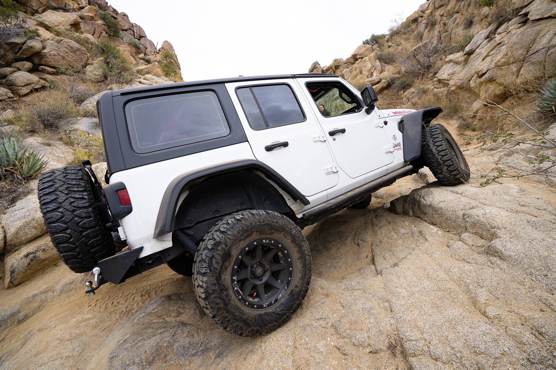

I'm one of the weirdos that actually likes running 32"-33" tires...but I'm not a hardcore offroader. Shouldn't someone get a well-matched lift for 35's? It seems with 35's being quite a bit heavier than stock Sport tires they might be harder on the OEM suspension's geometry? I feel that big of tires really needs components matched to serve the added weight/stress to maintain a decent lifespan of suspension & driveability of the vehicle?
Nope. Spacers work fine. Had em on my wife’s 18 JLU for 6 years until I traded it in
