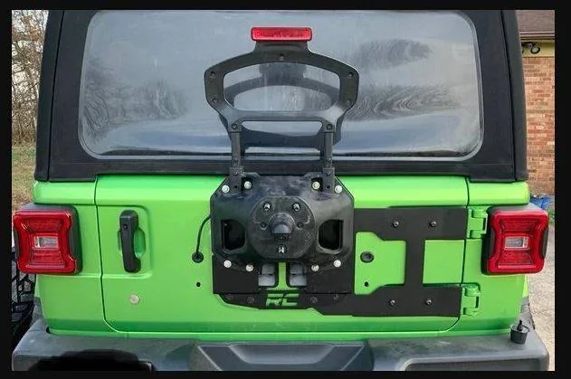

Anyhoos....I have a 2018 Sahara. when I put the 35's on, i figure it'll weigh...~100lbs. I know I will need a relocation bracket. Will i also need hinge reinforcement? What about the bump stops?
If i need hinge reinforcement, what one would you recommend? I see RC and Mopar have one that is also a relocation bracket, but I'm struggling at how they are reinforcement the hinges.

I run a black rhino Barstow and Toyo open country 35” tire. I use the RC relocation bracket and extended the spare tire bump stops so it is tight against the tire. No issues for the past 1 1/2 years running it this way. I wheel it regularly at Raush and AOAA as well as my kids hockey stuff constantly going in the cargo area. Haven’t had any issues with sagging or misalignment as of yet.

I know I'm going to need a spare tire relocation bracket whether it be RC or Smitty..going to need one. Question is, for tailgate reinforcement, I see there's a mopar one (it's also egregiously overpriced but I digress)...but it doesn't really support the hinges. Is that a legitimate concern?
Essentially, I am figuring my new spare will be about 110 lbs. Using the mopar tailgate reinforcment as an example, would that be sufficient enough to support the swinging or would I need something to support hinges as well?

With a 35” tire it’s not an issue to get the reinforcement. I don’t run any kind of reinforcement just the relocation bracket and extended bump stops. Most people on these forums have done the same thing. There are a few who will say you definitely need the reinforcement but it’s not many. There is a vast majority of us on here that have been fine running no reinforcement. Look through the threads and you’ll understand. If you go above a 35” tire that is a different story. I would definitely get some type of reinforcement them.
