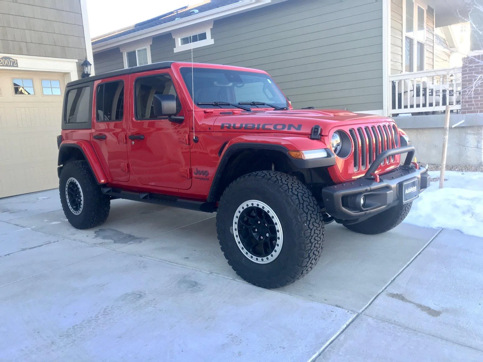

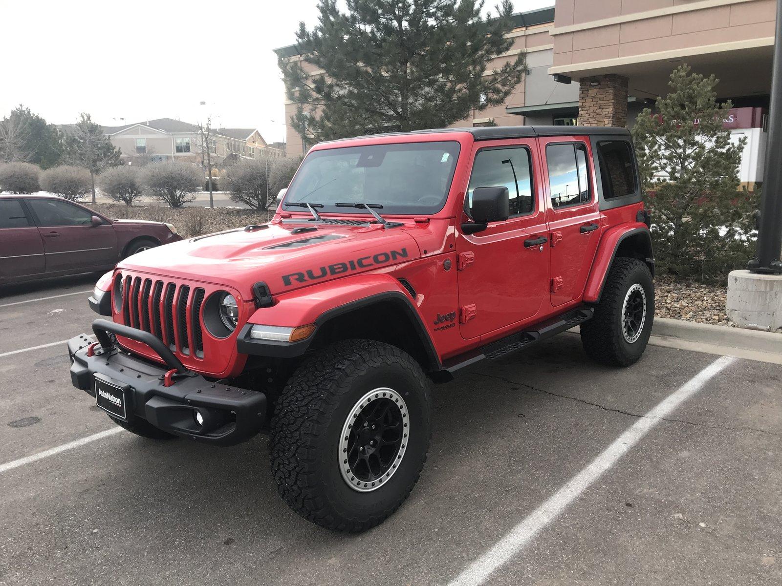

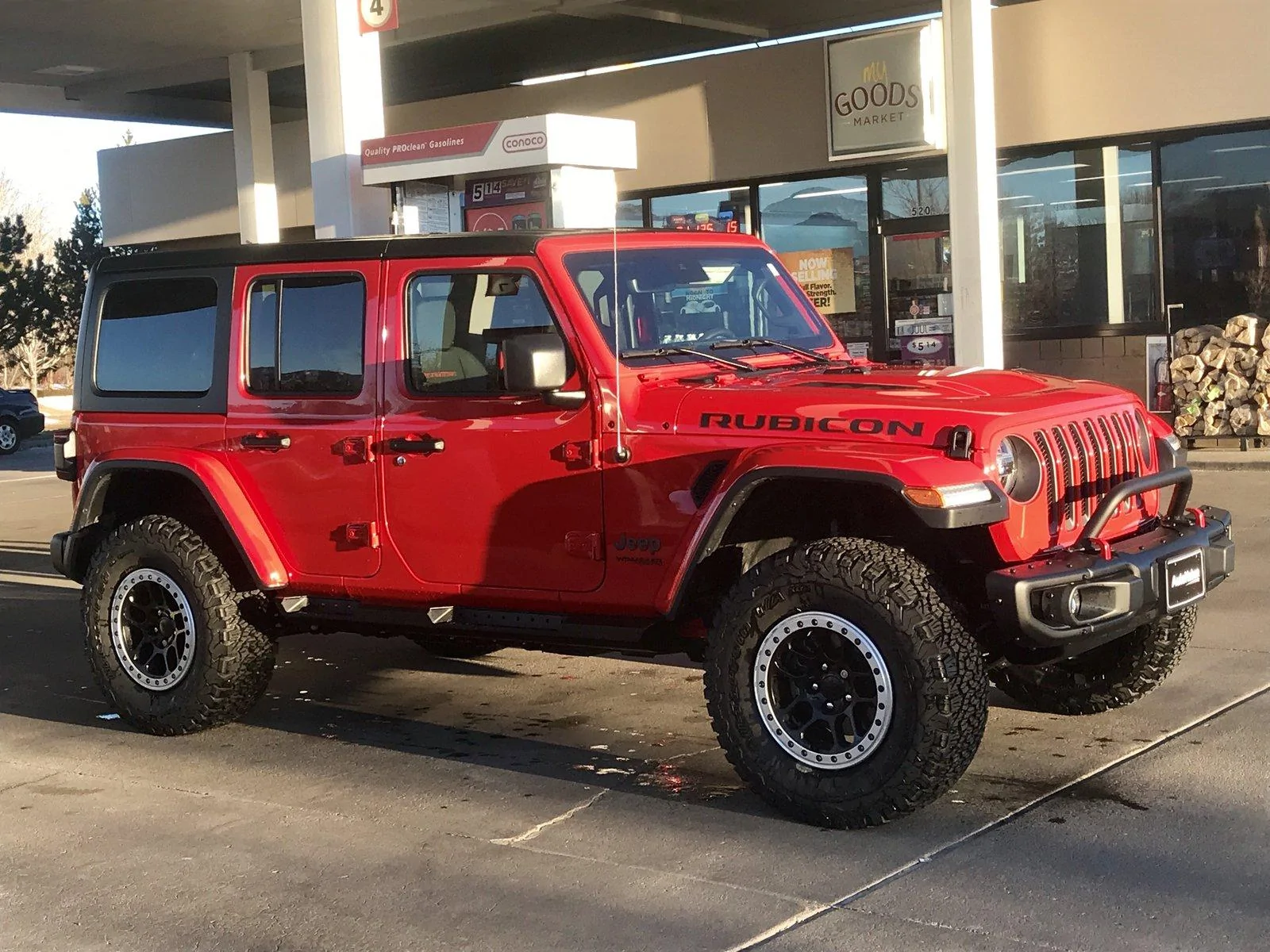

If it helps at all, these pictures are of the 315 KO2’s on the Mopar beadlock capable wheels, and the Jeep has teraflex 1” coil spacers. Thought it might be of interest considering it’s the same wheels you will use and has a coil spacer, although .5” shorter than you mentioned.
Rides great and steering feels great without additional modification. I haven’t experienced any rubbing off-road yet.
Wow, you Jeep is awesome. Those KO2 don't look small at all. Do you happened to have a shot from the side? I'm curious how these tires would look like there. Also, did you stack two sets of 0.5" spacers instead? I couldn't find any 1" spacer lift from Teraflex.

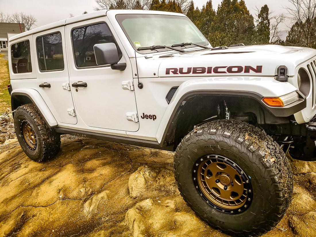

Thanks, your Jeep looks great. Do you mind sharing some pics? I'm also curious how the tire would look from a side profile.

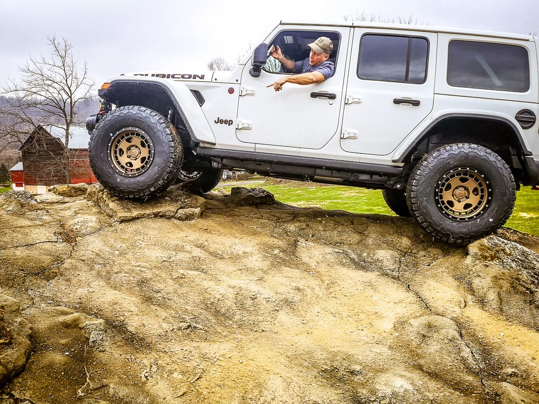

Here you go. I plan on also installing sliders and rack and still have enough room in the wheel well for that weight/compression.

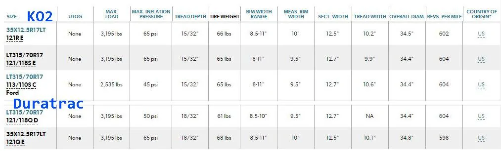

I've had both the KO2, and Duratrac, and loved both. The KO2 were on a Grand Cherokee, and the Duratrac were on a Ram. Both great tires, and handled snow/ice very well in addition to capable off road and good road manners. I'm looking at both of them for my JL. I'm equally impressed by both, so I'll be buying which ever has the best price.
As for sizes and weights:
BFG: 315/70/17 = 34.4 at 65 lbs, load C or E
BFG: 35x12.5r17 = 34.5 at 66 lbs, load E
GY: 35x12.5r17 = 34.8 at 68 lbs, load E
GY: 315/70/17 = 34.4 at 61 lbs, load D
As you can see both Goodyear and BFG offer both sizes you mentioned. The overall diameter is only .4" different at the most extreme (we're talking 1/4" of sidewall, which is likely undetectable). The weights are all pretty similar with the BFG settling in the middle at 65 lbs, while the Duratrac are slightly heavier or slightly lighter depending on which size you choose. I got all this data from tirerack, and have attached the following chart for easier comparison.
Thank you very much. The KO2s don't look small with a 1.5" Teraflex lift.

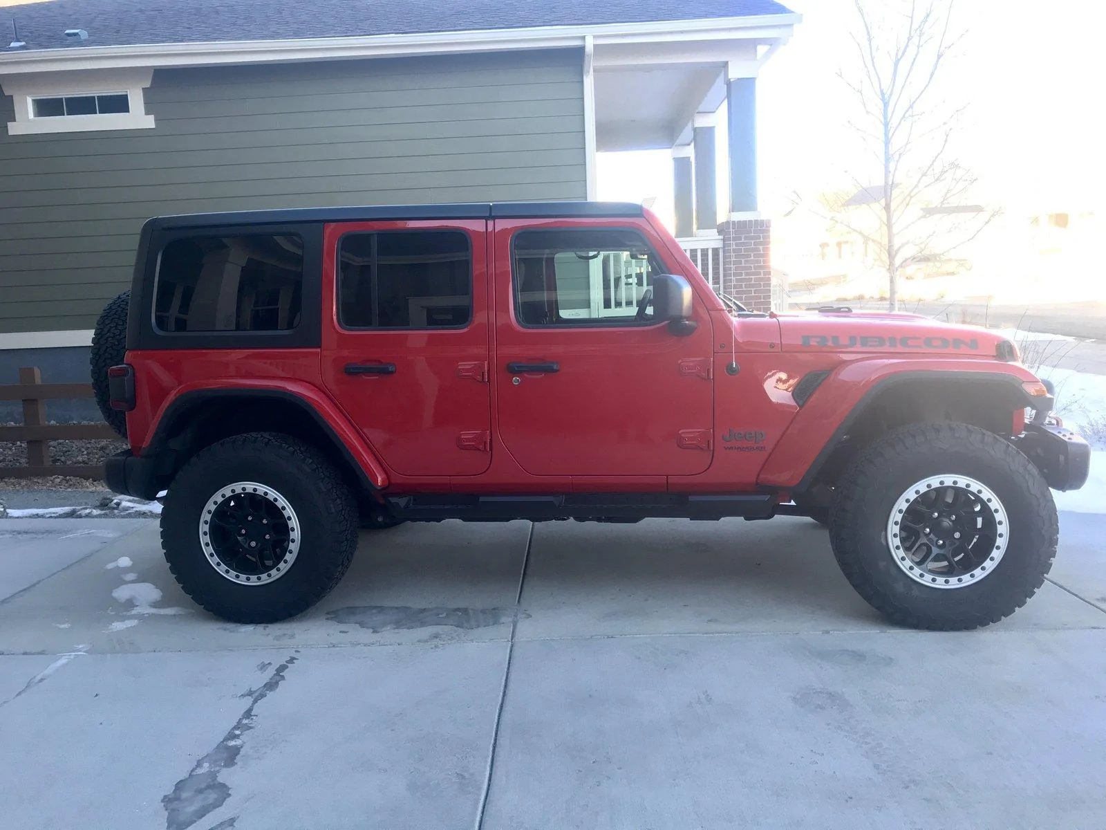

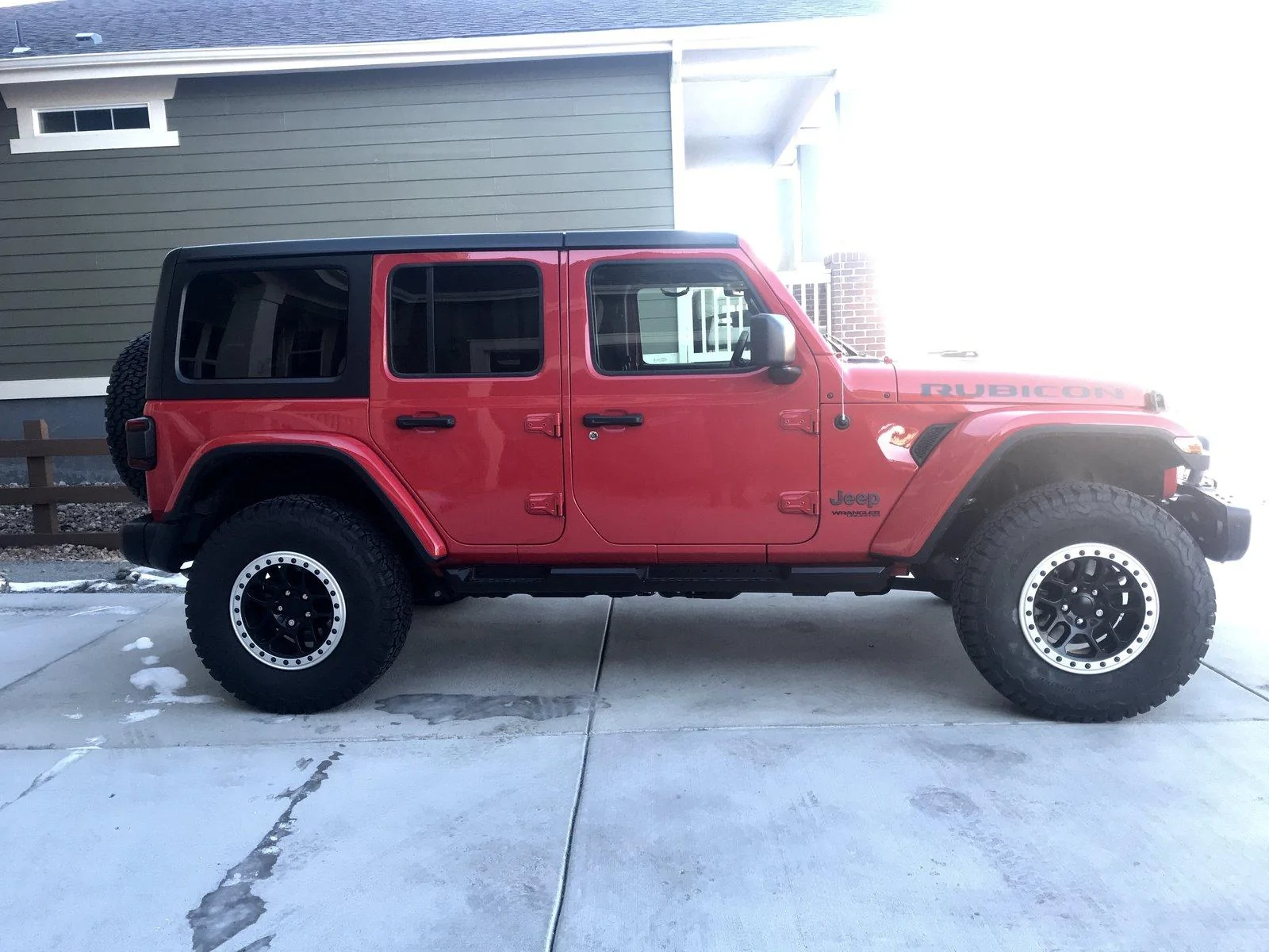

Here’s some side pics that didn’t turn out too good. Yes, I stacked two .5” spacers
Thanks! This is very helpful. Awesome looking Jeep!!
