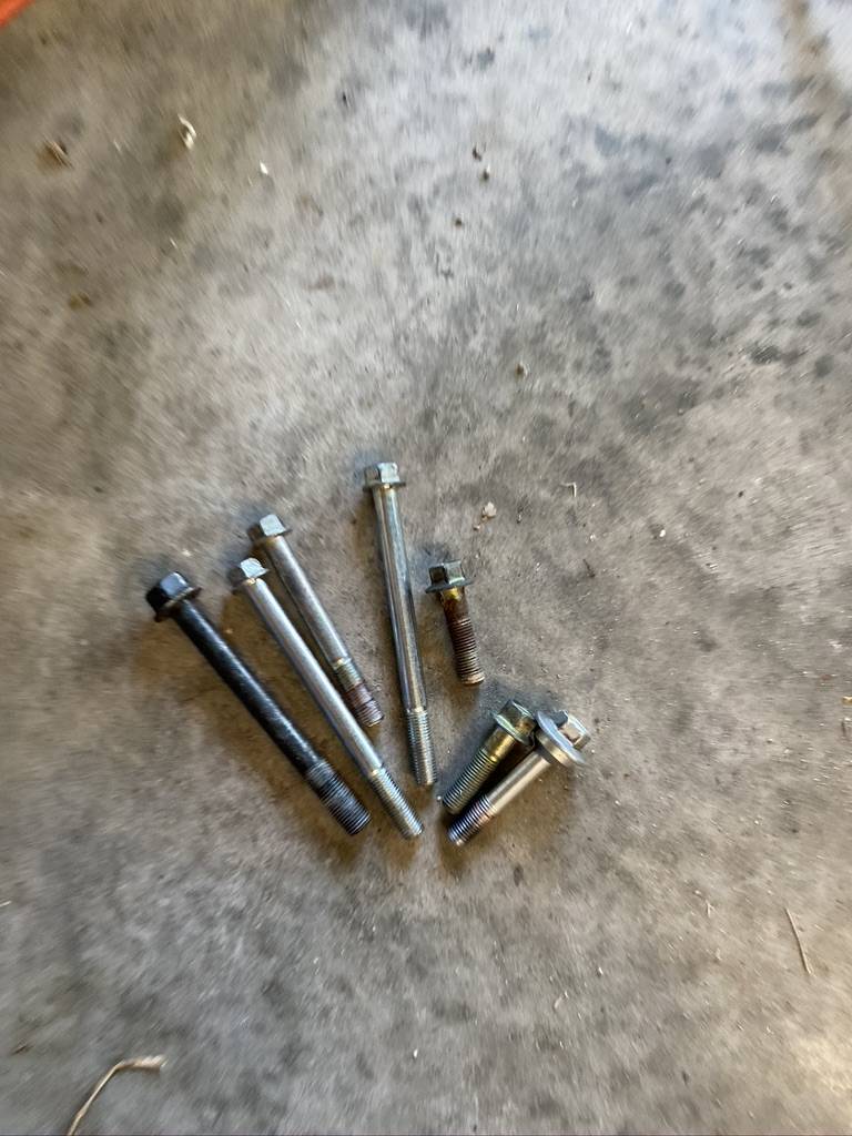

Great post, I've pulled valve covers off a few times. Done a few valve jobs on older engines back in the push rod days. I've done a few timing belts, various side engine sensors under the timing belt cover on Hondas.

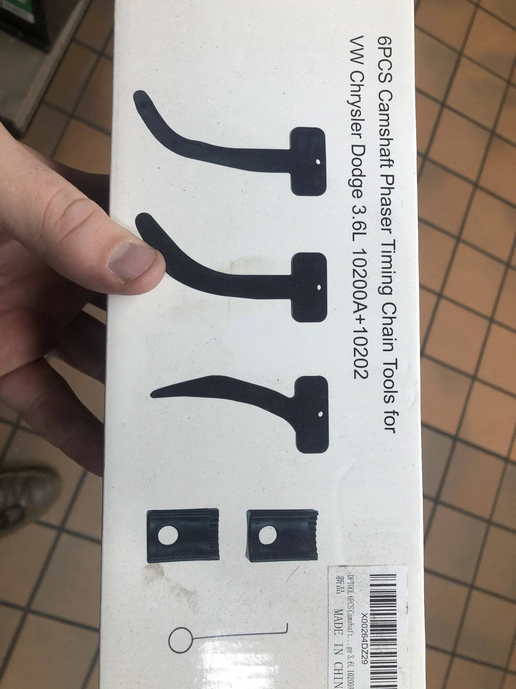

What are the "special tools" which hold "everything" in place on the 3.6 Pentastar? If I have a lifter problem after the warranty expires, I'd prefer to repair it myself. I like taking my time on engine work and order all of the one time fasteners which have a long lead time.
Edit: On my Odyssey timing belt job a few months ago every dealership could have had it done the next day. It took me 2 weeks because I waited for the one time bolts to come in. Here is my stack of "extra" bolts, each accounted for. The dealership wouldn't have replaced these with new.
Cheap Chinese plastic crap but it makes the job go much easier. No need to pull camshafts.

I watched a teardown video on the 3.6 last night. Crazy how much more complex this motor is than what I've seen in the past (small block Chevy, I-6 Toyota). I've never torn down a motor or worked inside one, but I am familiar, and some of the stuff in there is never seen before (oil separator inside cam?).
Also surprised to see that the cam/lifter issue I'm having is so common there's a set of tools to make the work simpler. Gives me ZERO confidence in this engine.

Cam locking tools exist for every engine ever made. They are an absolute necessity.
BullMoose1776
BullMoose1776
Bull
Feb 11, 2019
73
1,545
2,469
South Texas
Project Manager
Good clarity. Appreciate it.
