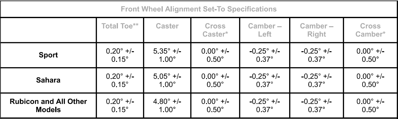

No, it's correct. Toe 100% has some impact on how the steering reacts to a bump event, a tire edge hit in particular. Example - toe way too far in, single tire impact on passenger side, outside of tire, such as catching the edge of a pothole or uneven road surface. The direction of force on the tire, and therefore steering too, is towards the driver's side. However, because the toe is in so far (improperly set in this scenario) the tire doesn't scrub off as much of the impulse as it otherwise would and transmits more of it into the steering. Effectively, it acts as though the tire is part-way into beginning a turn, making it easier for the energy to travel into the steering linkages, creating an opportunity for oscillation on the rebound. When toe is properly set, the tire is closer to neutral or, when slightly toe out (SteerSmarts for instance recommends slightly toe out), past neutral and the tire scrubs off some of the energy (remember, big chunk of vehicle weight is on the tires, so it takes a lot of energy to redirect them) of the hit as it has to be pushed from almost or past neutral before it can impart energy into the steering linkages.
Obviously I'm not stating that this is the entire reason to set toe properly, but rather that this is part of why there is a toe spec range, as it does have some impact to steering behavior, and DW is generally triggered by tire manipulation on an uneven road surface feeding into the steering linkages and causing oscillation, and having toe set properly mitigates some of the opportunities for oscillation that DW requires. Toe is also something that is easily adjustable without replacing hardware, so it is an easy recommendation to make.
Caster is more likely to be involved with DW than toe, yes, but it is not the only factor to ensure is set correctly. Factory specs vary by model for caster, up 6.35* at the high end or down to 3.80* at the low end:
Jeep Wrangler JL 2in Mopar lift concerns! (Solved) 1680808408655
Most people report best results above 5 and below 6.5, especially if you delete your FAD or have an aftermarket front axle, caster above 6.5 can (not will) get sketchy with driveline vibrations.
Generally speaking, most folks' DW (true, honest-to-God "I'm gonna shit myself! This is terrifying!" DW, not just a frustrating shimmy) will come down to ball joints, trackbar bushings/trackbar brackets, improper torquing of suspension/steering components (all rubber bushings must be done on the ground), or really low caster. BUT, that does not mean that there are not other factors that can influence how easily DW manifests. Toe falls into that category.

No, it's correct. Toe 100% has some impact on how the steering reacts to a bump event, a tire edge hit in particular. Example - toe way too far in, single tire impact on passenger side, outside of tire, such as catching the edge of a pothole or uneven road surface. The direction of force on the tire, and therefore steering too, is towards the driver's side. However, because the toe is in so far (improperly set in this scenario) the tire doesn't scrub off as much of the impulse as it otherwise would and transmits more of it into the steering. Effectively, it acts as though the tire is part-way into beginning a turn, making it easier for the energy to travel into the steering linkages, creating an opportunity for oscillation on the rebound. When toe is properly set, the tire is closer to neutral or, when slightly toe out (SteerSmarts for instance recommends slightly toe out), the tire scrubs off some of the energy (remember, big chunk of vehicle weight is on the tires, so it takes a lot of energy to redirect them) of the hit as it has to be pushed from almost or past neutral before it can impart energy into the steering linkages.
Obviously I'm not stating that this is the entire reason to set toe properly, but rather that this is part of why there is a toe spec range, as it does have some impact to steering behavior, and DW is generally triggered by tire manipulation on an uneven road surface and having toe set properly mitigates some of the opportunities for oscillation that DW requires. Toe is also something that is easily adjustable without replacing hardware, so it is an easy recommendation to make.
Generally speaking, most folks' DW (true, honest-to-God "I'm gonna shit myself! This is terrifying!" DW, not just a frustrating shimmy) will come down to ball joints, trackbar bushings/trackbar brackets, improper torquing of aftermarket components (all rubber bushings must be done on the ground), or really low caster. BUT, that does not mean that there are not other factors that can influence how easily DW manifests. Toe falls into that category.
