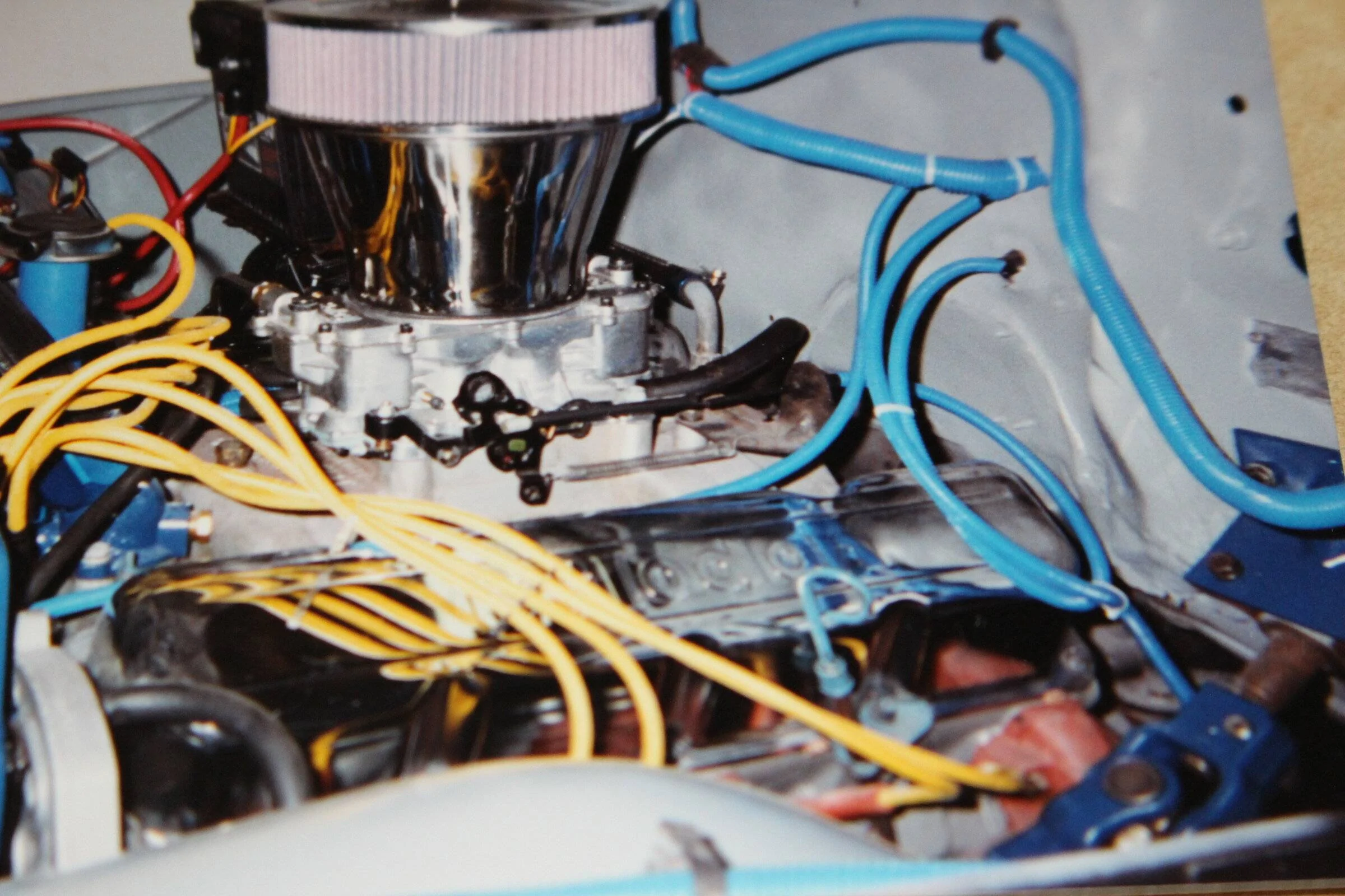

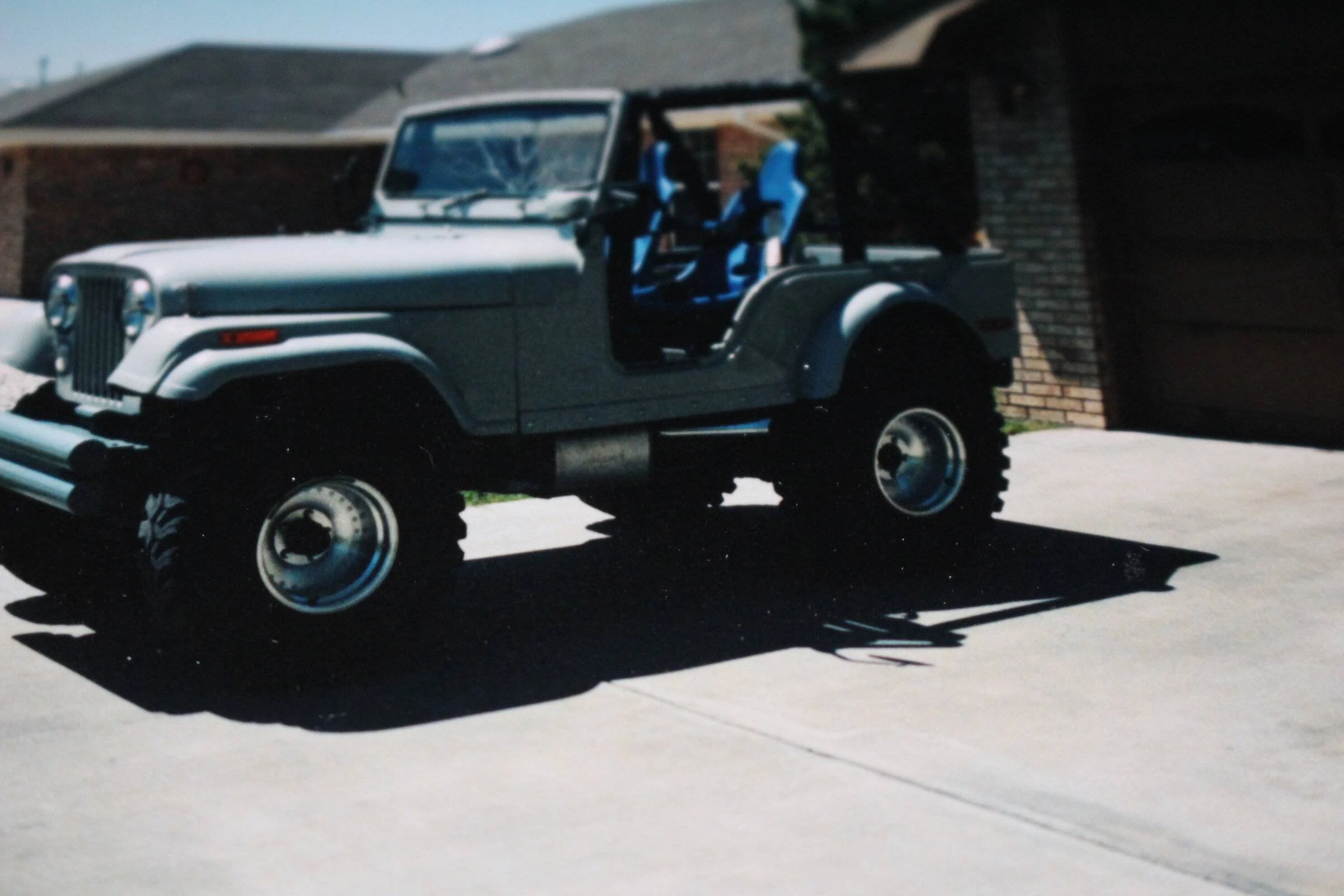

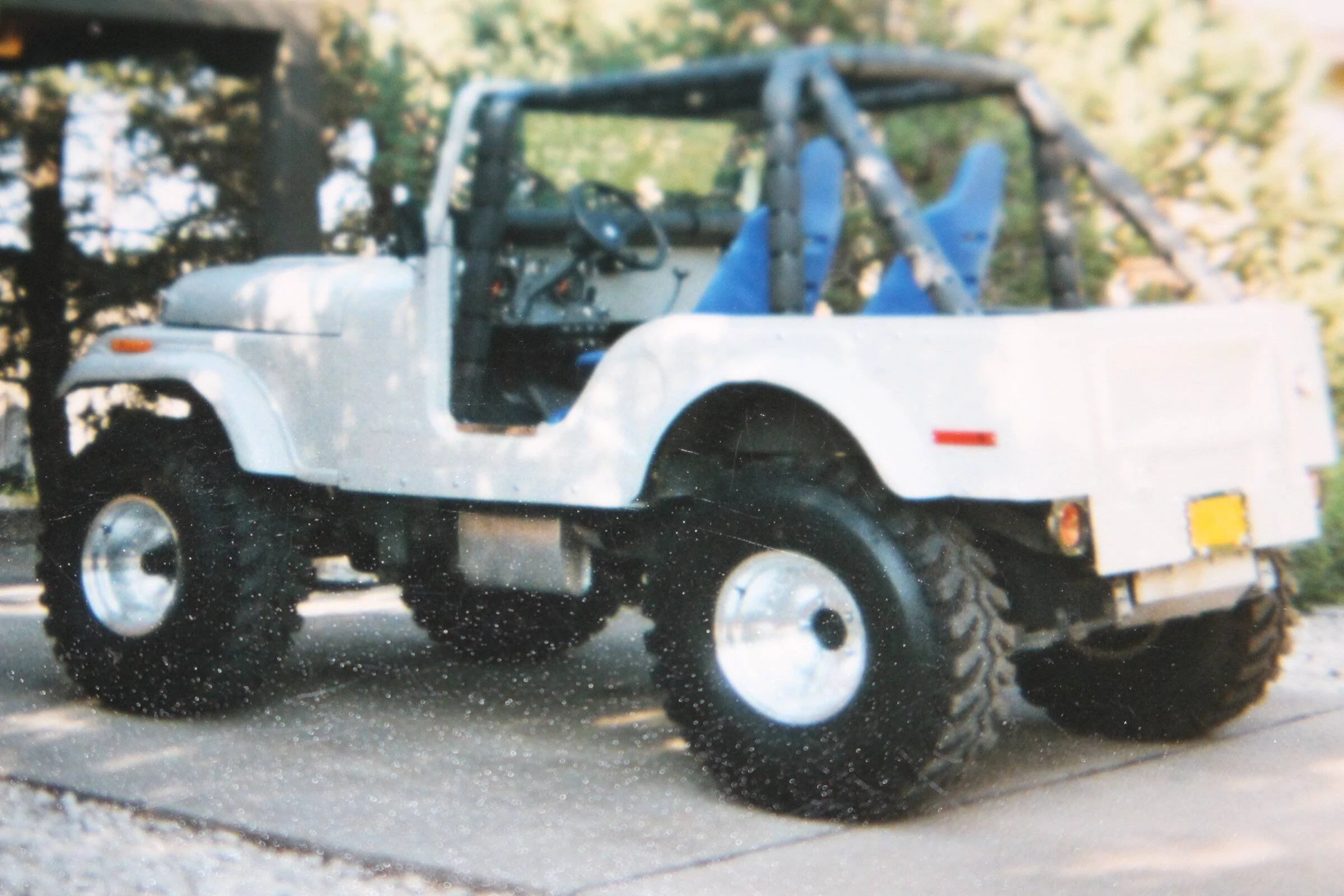

Yeah, I did a frame off restoration on mine, put an AMC 401 V8 from a Cherokee (balanced & printed), Disc brake front end kit, front shackle reversion, Ford T19 compound low transmission. It was a fun time! Started out Black and ended up almost Sting Gray, lol
Oooops, sorry this thread was about tires, those are 35x14.5x15 Denman Ground Hawgs, load rating unknown :(

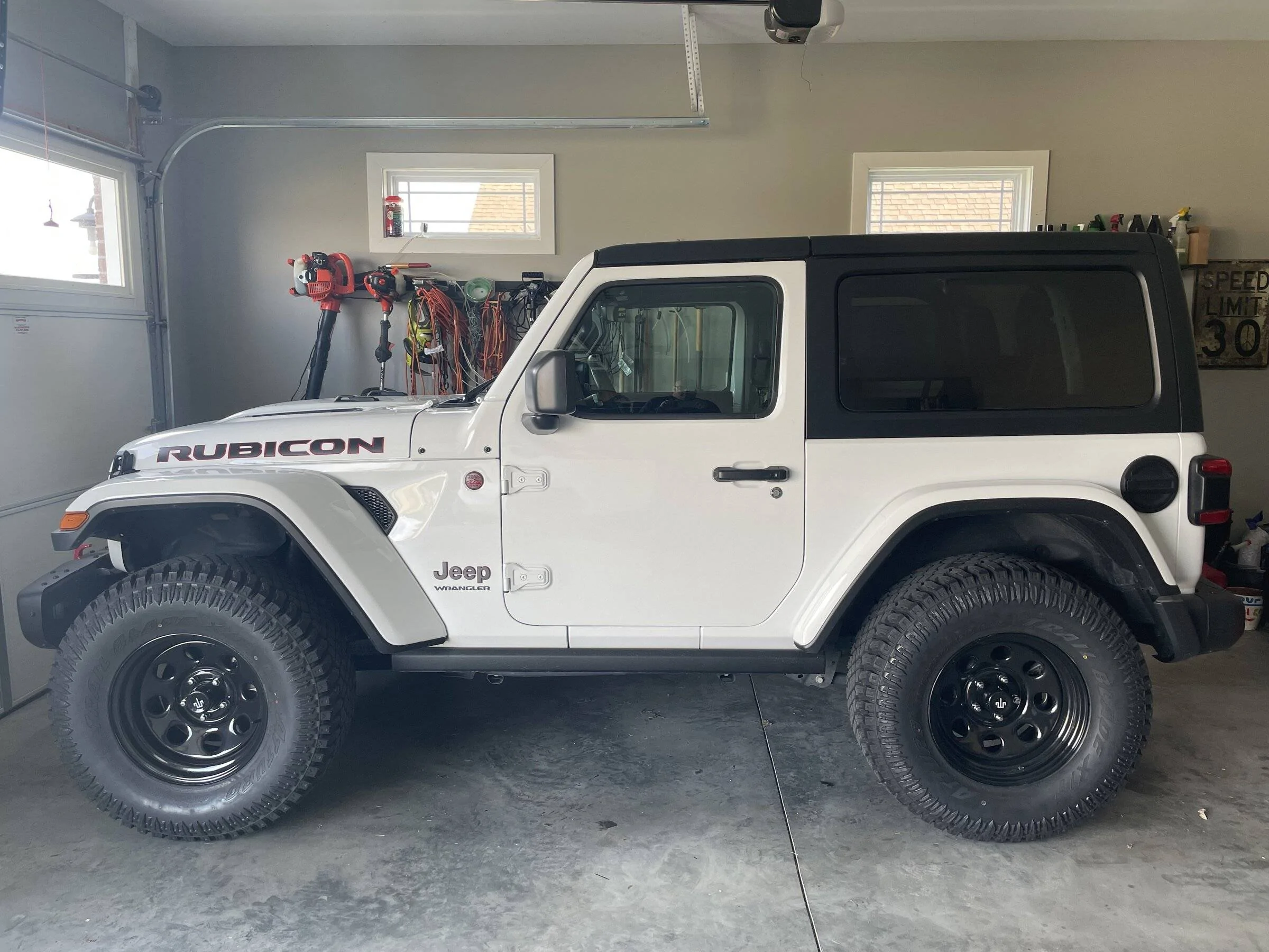

Jeep Wrangler JL 2DR ride on Load E tires vs Load D/C tempImagePRtl6E
I have atturo 35's XT's (load E) on mammoth 17inch steel wheels. The ride isn't horrible but you can feel the road a bit more than the stock 33 bfg load C . I have a little roughness in the floorboard around 48-50mph but im not going to sweat it.

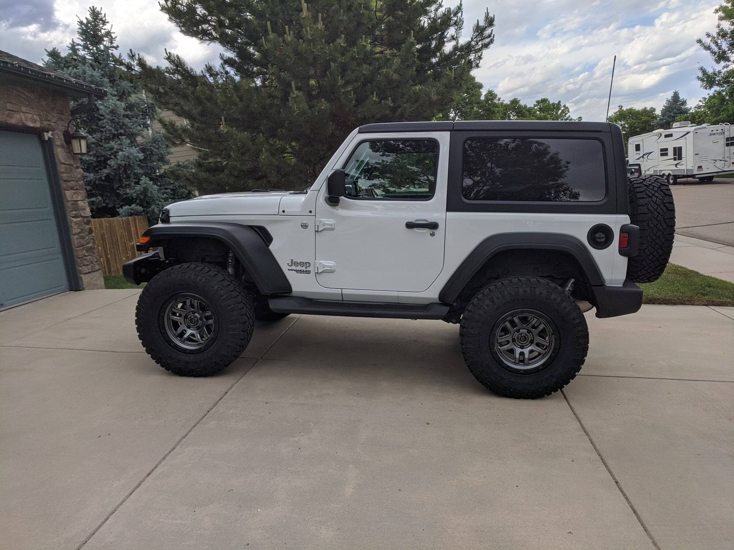

Jeep Wrangler JL 2DR ride on Load E tires vs Load D/C IMG_20200605_180738
Mine are 35x12.5x17 Goodyear Duratrac Wrangler All-Terrains, E-Load rated.
I love them. Normally ride at 15 off-road and 37psi highway. I know everyone prefers lower psi when on-road but the 'Chalk Test' is best near 40.
I live in Colorado, this is my daily driver and I enjoy every minute when driving it (anywhere). It's by far the most fun vehicle I've ever owned.
You can ride on whatever rubber you can rationalize but grip, durability, snow rating and shear enjoyment are my primary concerns. The E rating just happens to be a bonus.
