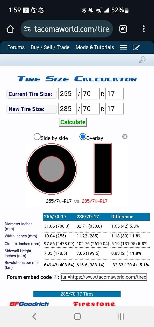

Looking at a killer deal on Bridgestone ats 2557017
What would be the main difference other than a hair shorter? Have stock sports right now
2657517
Any shots or comparisons please?
I have reviewed to toyota site that has them overlayed just looks a hair smaller than the Rubicon stock.
Jeep Wrangler JL 255 vs 285 Screenshot_20241029-135910_Chrom

Is over an inch and an half shorter "a hair" to you?
I'd think you'd want to use what you currently have as the baseline. Note that if you change diameter you'll most likely want to also recalibrate the computer's settings. That (a device or trip to a relationship) needs to be part of your budget.

The only thing that tire has in common with what the OP is looking at is width. It's 1.5" taller. It's an MT vs an AT. Apples and oranges.

You're measuring width, not height. 255 is 30mm narrower than 285. 255 and 285 have nothing to do with the height (until you include an aspect ratio and wheel size).

You need to include the entire size listing when comparing tires. The 255 and 285 numbers by themselves are only the width. Need to at least verify the aspect ratio (the next number, usually something like 70, 75, 80, etc...). For example a 255/85R17 is taller but skinnier than a 285/70R17.
