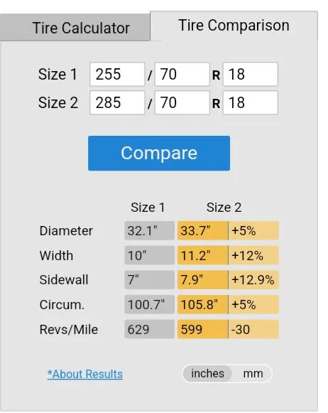

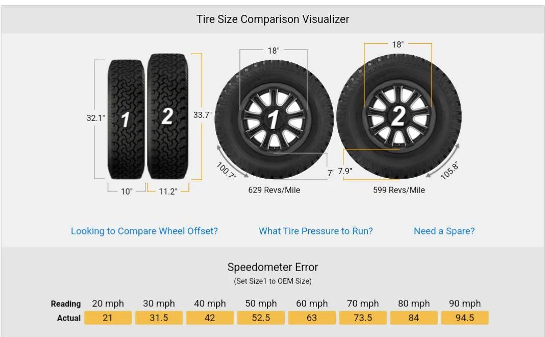

Stocks are 255/70R-18
Looking at 285/70R-18
Bone stock. Will they 1ork?

diameter side should be fine, wideness on what you plan to mount this original rim ?
I run 275/70R18 on stock wheel no issue on my side.

Stock rims. I believe they are 18x7.5. Thanks

Bone stock. Will they work?
Most, including myself, go with 275/70R18. That being said, they should work, but you may have some clearance issues with the spare and rear bumper. Also, you will need to recalibrate your vehicle (Tazer, JSCAN, ECRI, etc.) for the change in tire size, otherwise your speedometer will be off and your transmission will not shift properly (if automatic).
