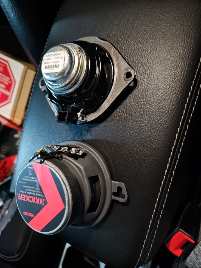

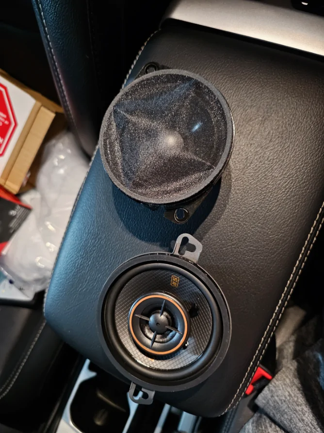

I replaced just the 3.5" with Kicker KS in the dash and sound bar along with some polyfill and the vocals and highs really perked up. I was even able to keep the EQ flat and have the system sound pretty good.
If you replace the speakers and get metra adapters, be sure to double check the polarity, as some had them swapped.
