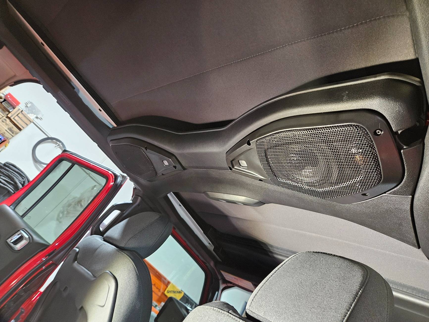

So I’ve recently finished upgrading the entire audio system for my 2024 Willys… well, everything except for the soundbar.
I disassembled the entire dash, tapped into the speaker output from the head unit using the Metra LOC-CHH3 T-harness (works great !), ran to a new line output converter, then to a 5-channel amp before running all the wiring back to the factory speaker wires in the front. Replaced the front dash speakers with 2-way 3.5” speakers (with an inline HPF crossover), and used the Metra pods in the knee panels to replace those speakers with 6.5” coaxials.
I then used a Jeep JL passenger-side Skar Audio 10” subwoofer enclosure (happy with this as well), with a new 10” DVC subwoofer, powered by my 5-channel amp.
Everything sounds great! I have the standard (non-amplified, no subwoofer) sound system, and it was TERRIBLE. Now my complete audio system sounds AMAZING!! Well, everything except for the stupid soundbar….
if you didn’t know, Jeep redesigned the soundbar for the ‘24s. None of the JL soundbar pods/adaptors work for the ‘24, and I’ve been waiting about a month for SOME KIND of solution to hit the market. But still nothing.

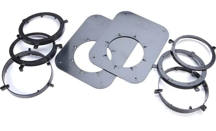

Ok so I was thinking about using the Metra Universal (82-4600) 6.5” adaptor bracket, and cutting the adaptor to fit inside the soundbar enclosure.l, and install a 2-way 6.5” speaker in either side. But it dawned on me that I would only have about a 1/2” clearance if using the factory speaker grille. And 2-way 6.5” speakers have a top-mount clearance of over a half inch. Sooooo shit.
Ok so my NEW plan is to use the universal 6.5” adaptor, but drill a smaller hole in it in the side, and install COMPONENT 6.5” speakers—a separate 6.5” woofer, with a separate 1” tweeter. The component speakers I’m looking at only have a 1/4” top-mount depth.
In theory, I think this is a solution that will work, while maintaining the factory look (always a priority of mine). But before I buy everything and start drilling/cutting into my soundbar, I wanted to see if anyone else had any feedback. If you have any ideas,

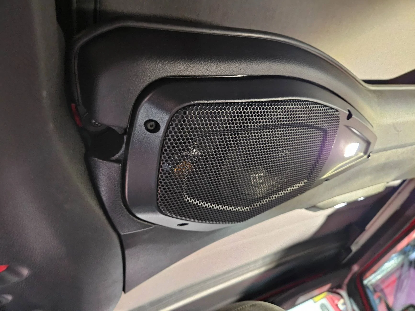

In reading all of the treads I could find on this topic, not one person was completely satisfied with their sound bar upgrade. Most were disappointed, including those who installed 6.5" speakers in 2023 and older Wranglers. Part of the issue seems to be the soundbar itself. It is a lousy speaker enclosure.
Jan 27, 2024
Honolulu, Hawaii
2020 JLU Sahara
You’re right about the disappointment. Not only is it a fairly bad enclosure, the stock soundbar gets such little power from the already weak amp that I think any investment just isn’t worth it. No matter what you put up there, it will sound tinny. I put 6x9s into mine and regret it.
Putting kickers in the dash was amazing though!

This may not apply to you if you're planning on upgrading to a larger size speaker, but for anyone looking to swap out the standard 4" speakers in the roll bar, you'll need an adapter for them to fit. I found this out the hard way. These speakers come with an adapter that will allow them to work so I've ordered them plus a set of 2-way 3.5" speakers for the roll bar.

For the record, I wouldn’t recommend doing ANYTHING with the soundbar—AT ALL—unless you’ve already done all the things I’ve already done:
Tap into head unit, run to line output converter.
LOC to 5-channel amp. Dual stereo outputs (front and back) back to head unit speaker inputs.
Replace dash and knee panel speakers. 3.5” 2-way speakers in dash with in-line high pass filter (900hz+); 6.5” speaker in knee panel using Metra pod.
Sub output from amp to 10” DVC subwoofer.
Only after doing all THAT, would I recommend screwing with the soundbar speakers. I don’t expect any great results from upgrading the soundbar, personally I was just hoping that the separate 6.5” woofer would boost some of the (lacking) lower mid-range.
