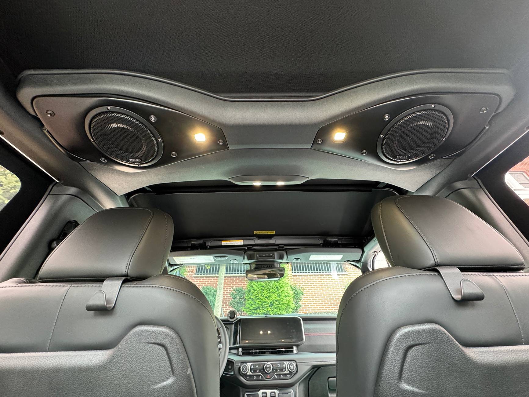

Quadratec is the only one that I have seen. It comes with a 5.25 Kicker.
I'm currently making my own speaker adaptors for a 6.5 and a tweet.
Search for 14133 3017 | Quadratec
Cagle
Christopher
Jun 3, 2024
211
1,046
Reno
2024 JLUR-XR
This is their description.
Better Sound: By using computer optimized sound ports that are tuned specifically to match Kicker Speakers you will get increased efficiency, better bass response & lower distortion for cleaner sounding music.
Plug & Play: No cutting or splicing wires are needed for installation, simply remove your old speakers plug in the new ones and reuse the factory speaker grills.
Direct Replacement: These speaker kits are engineered to seamlessly fit the factory sound bar mounting locations, preserving the original look of your Jeep.
*Note: Will Not Fit Jeeps With Factory Subwoofer
This is the only soundbar part that I have found in my research. I stopped looking about 45days ago.
Yes, I ripped apart everything :) The stock amp is still there but not running any speakers.
I'm working on the bar now then I will be done.

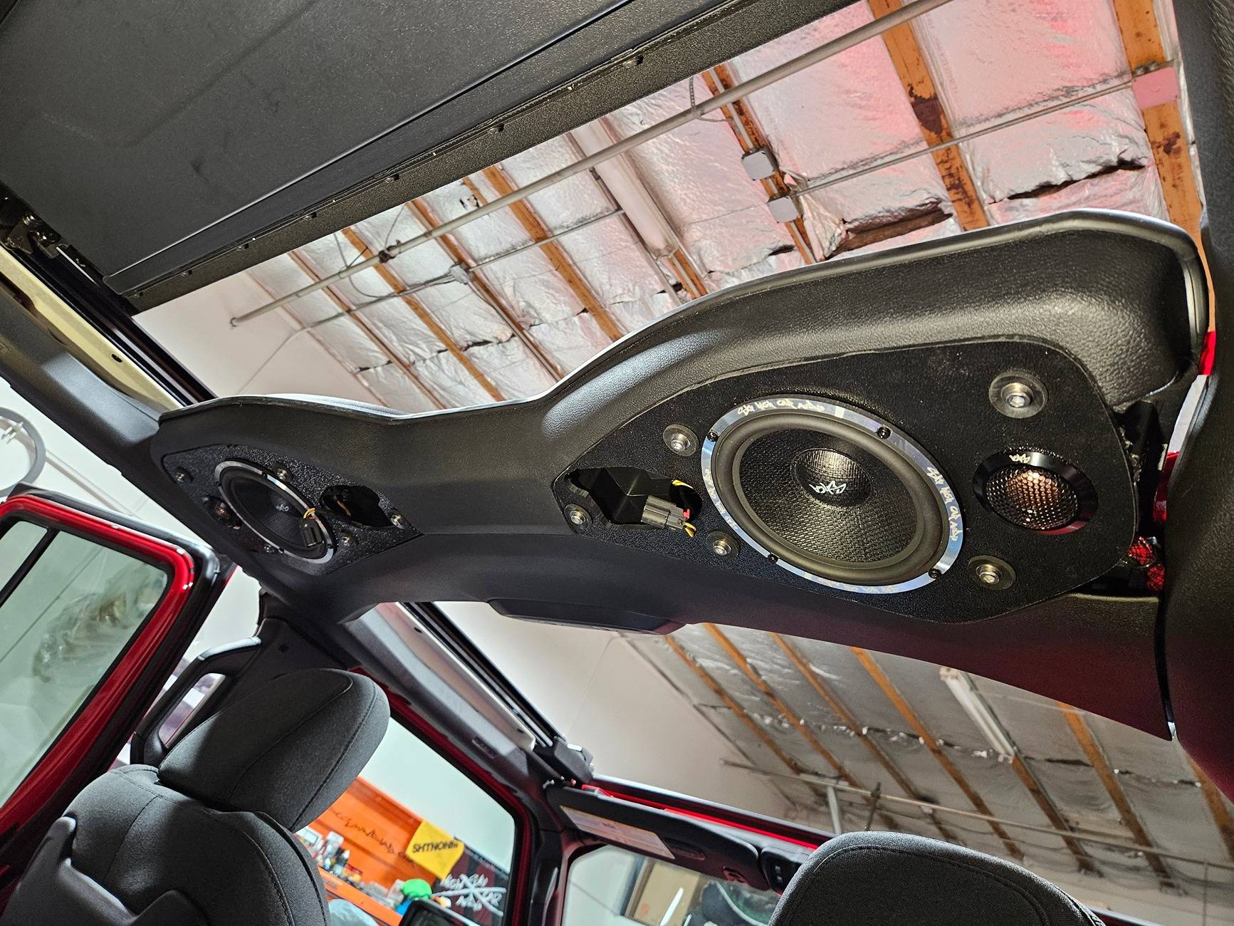

I just made my own adapters
How’d you go about making your own adaptors? I was debating getting some 1/4” ABS plastic to cut a customer adaptor, but I don’t think I’ll have enough clearance with the factory speaker grille
You are correct. I used 1/4" and then I used 1/2"for a spacer. I'm a slacker, I just need to get longer screws, then it will be finished. I guess I could have frenched them in. I had enough room in depth.
I just made a templet out of 1/4" MDF and used a flush cut bit.
Jeep Wrangler JL 2024 Soundbar options 20240608_091823
Jeep Wrangler JL 2024 Soundbar options 20240629_113922
Thanks for the advice and the photos! Definitely helpful.
