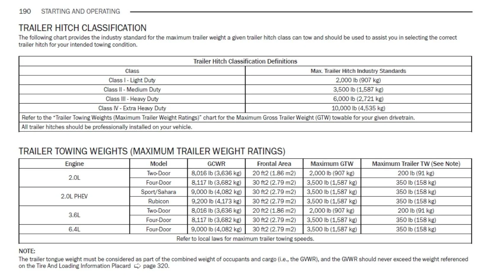

Also, if you download the ‘24 wrangler owners manual, there aren’t any wrangler configurations that have more than 3,500 lb towing capacity.

GMC-AT4, 2024 392 arrived 7/11
Right from the 24 Owners Manual
Jeep Wrangler JL 2024 392 tow capacity question 24 Towing
