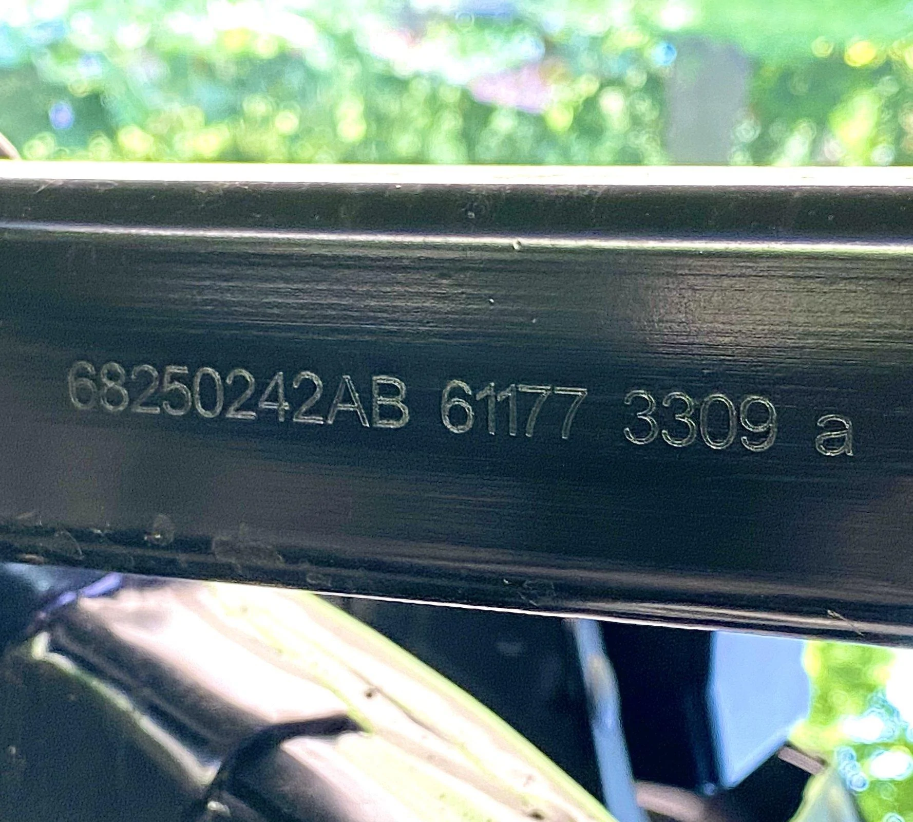

I'll see if I can get LCA part numbers on mine. Information is key!
-Steven
I was able to get under the Jeep today and get a at look the LCA's.
Here's the part number that's on my 2020 Recon.
As previously mentioned, my Jeep has great steering feel/feedback. Hope this helps.
