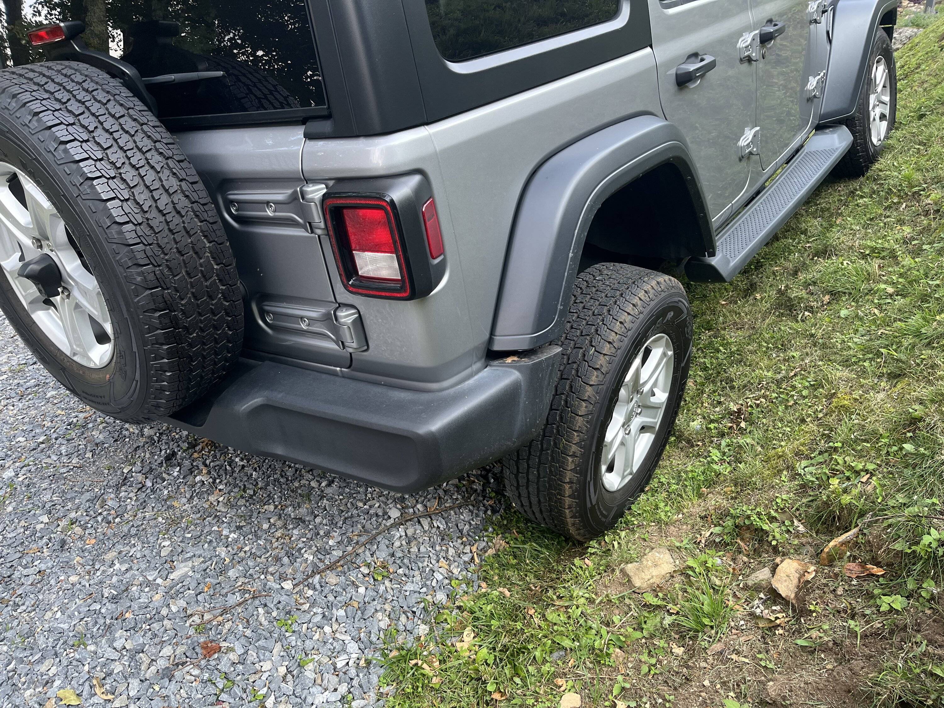

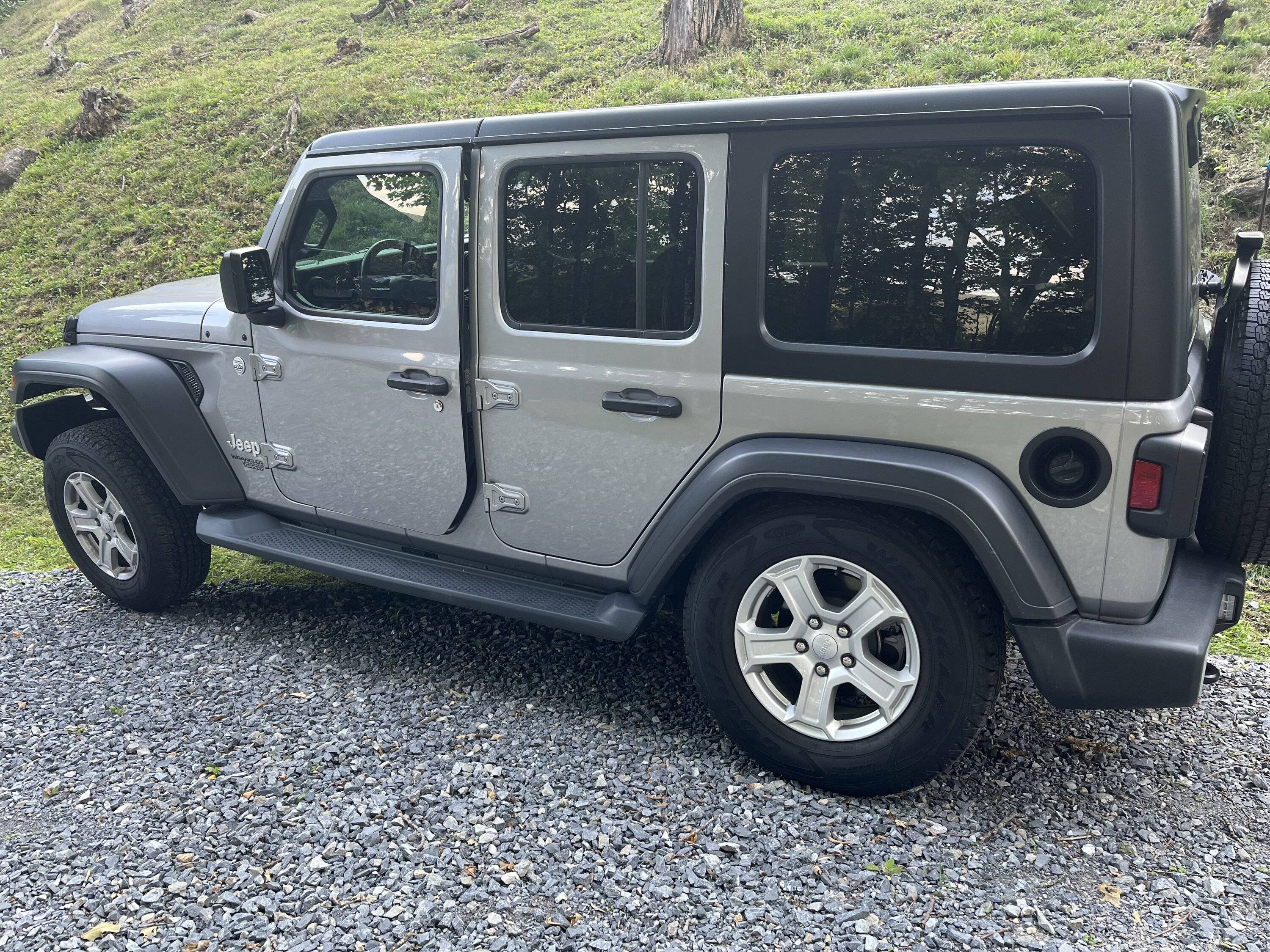

New to the wrangler and have been reading a lot on this forum. I purposely put my Jeep in this one rear wheel in air position in 2wd to see if I could get out. The tire off the ground just spun. Never felt the wheel with traction try to pull me out in reverse with BLD. I also tired the Ebrake easily increasing pressure but nothing. Did I do something wrong for this test? 4wd was the only way out.
Getting ready for winter and want to know what I may need to do to get out of iffy situations.

I could be wrong but I think I remember seeing somewhere BLD only works in 4 low

Well, maybe I was wrong and part of the other thread is correct. I redid my test in 2wd and in both forward and reverse. In both cases with one wheel of the ground, the wrangler was able to move. The wheel off the ground never stopped turning but the Jeep did move.

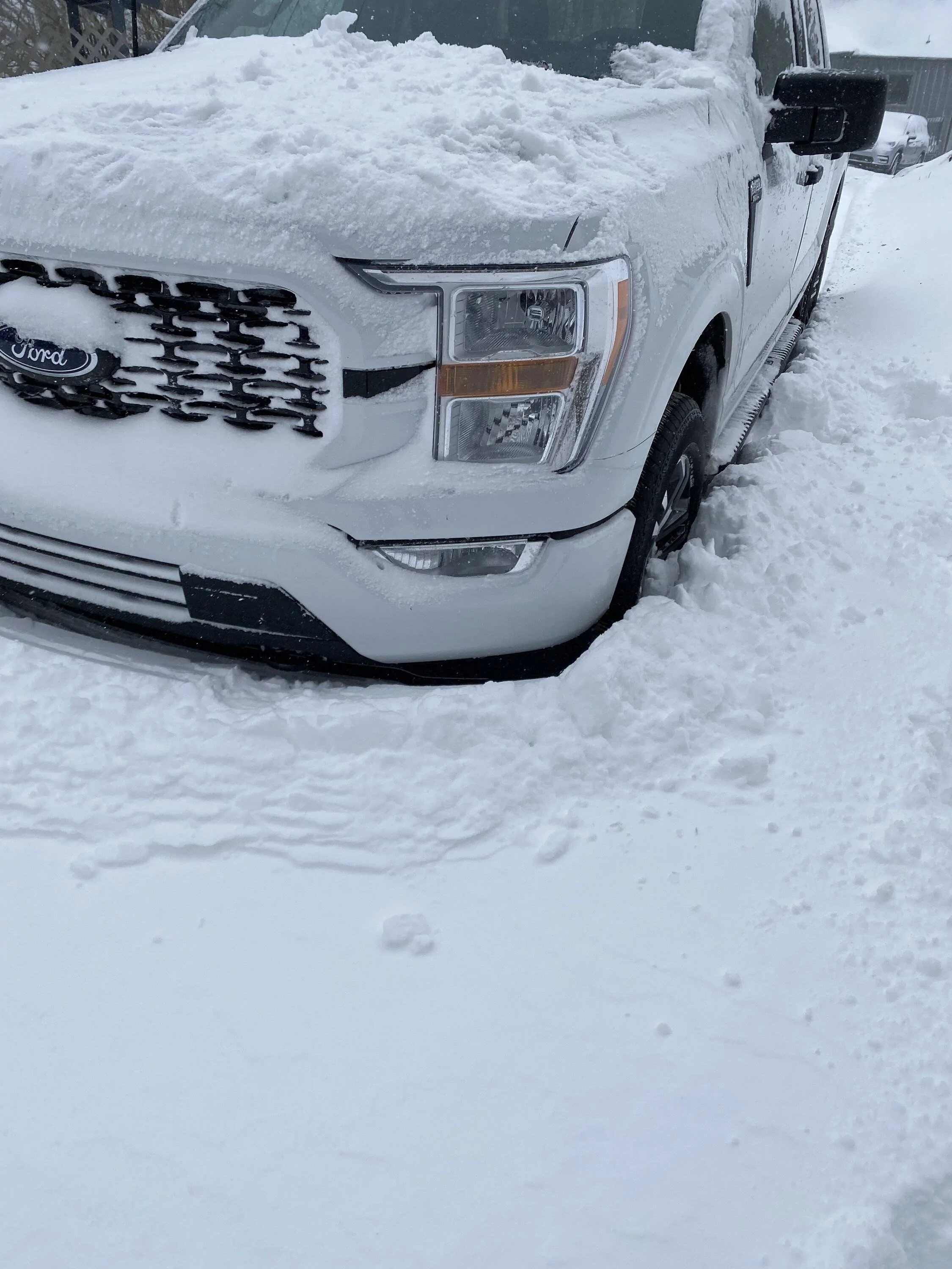

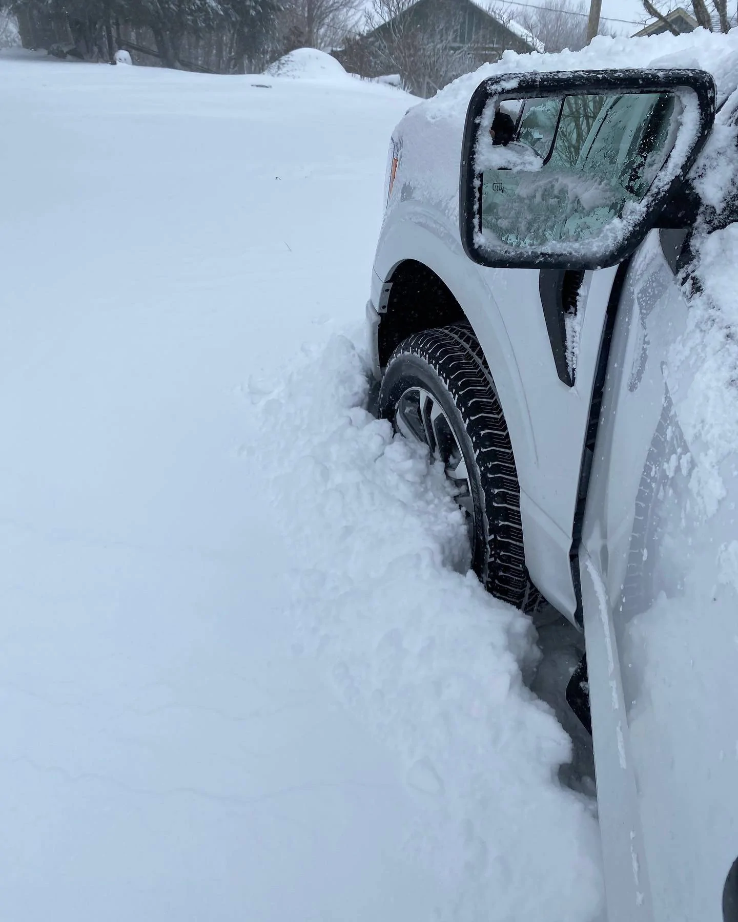

I appreciate your input so far. At our cabin in the upper elevations of TN, a big snow can hit quickly which is what I’m trying to prepare for. In 6 hours we got hit with the snow in this picture. My F150 4x4 with rear e-locker was stuck even with 600 lbs of sand in bed. Lucky we had my wife’s Subaru Ascent which cruised right through as if was nothing. Had to leave truck for a few weeks. Yeah tires sucked which was a big part of it
That's a good amount of snow about the same when I got stuck on wheeler pass out here near Las Vegas. I wish we got more snow, used to live in Colorado and before that the outer banks(ocracoke to be more specific)
We need more weather than just sunshine but I can't complain when I can drive with the doors off when it's nice out
