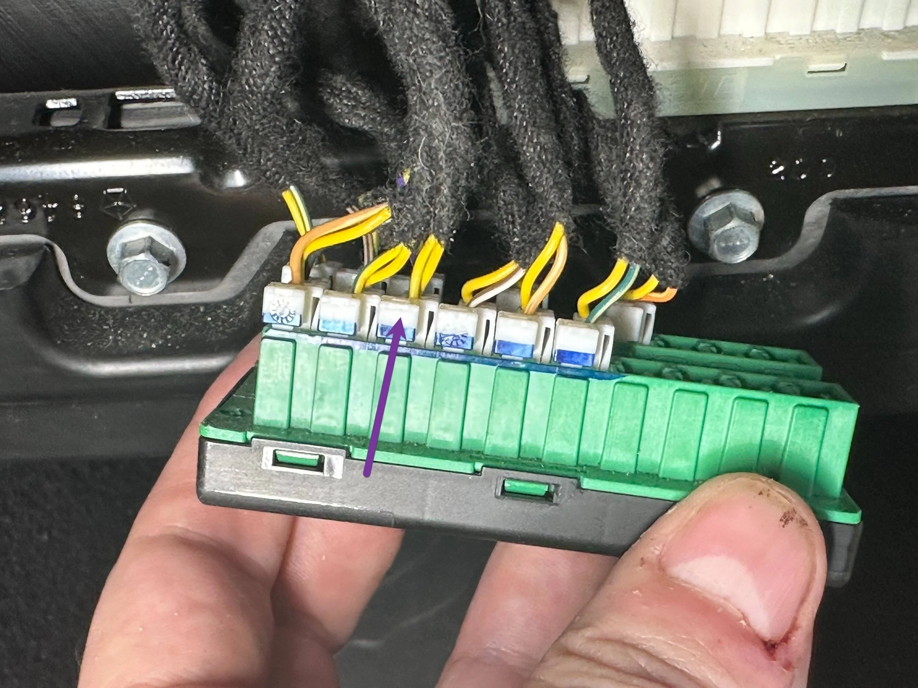

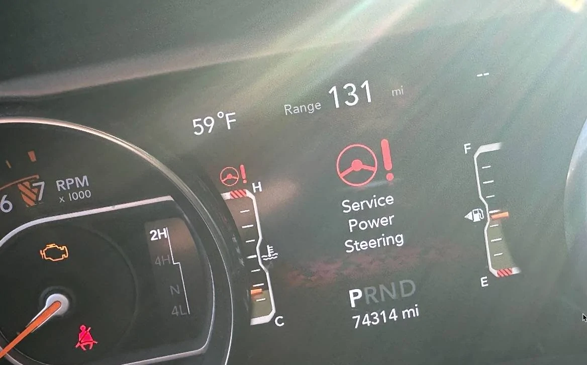

Today I started isolating each cable going to the 20-post can bus. Pull one pin....wait 2 minutes...does jeep get angry yes/no...then go pull negative to turn off jeep...put pin back...try next pin...i just about given up and then I pulled this one and jeep ran like normal. I now have a Service Power Steering message and red steering wheel light and service engine light. Going to look for wiring diagram to confirm this is power steeing connector. Assuming it is not sure if that is a faulty connector or power steering component failure.
