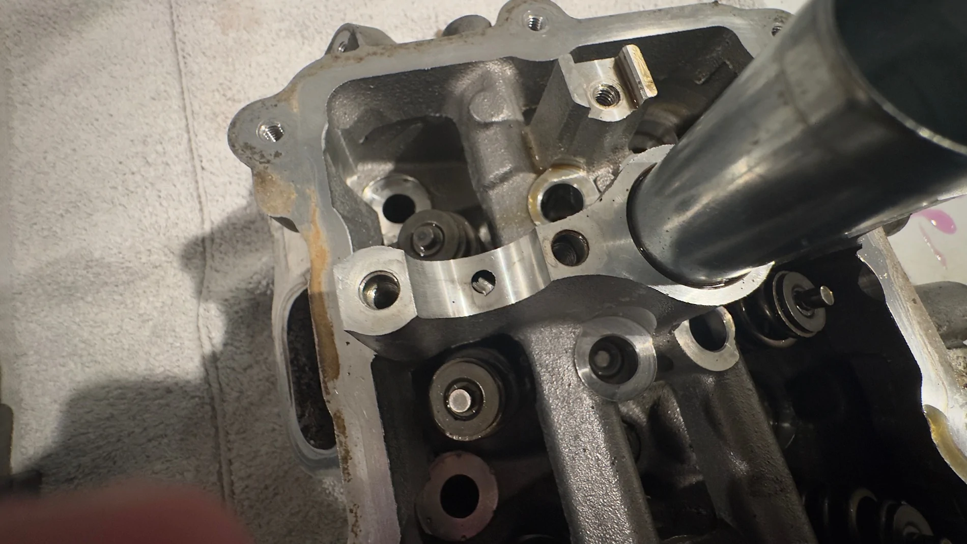

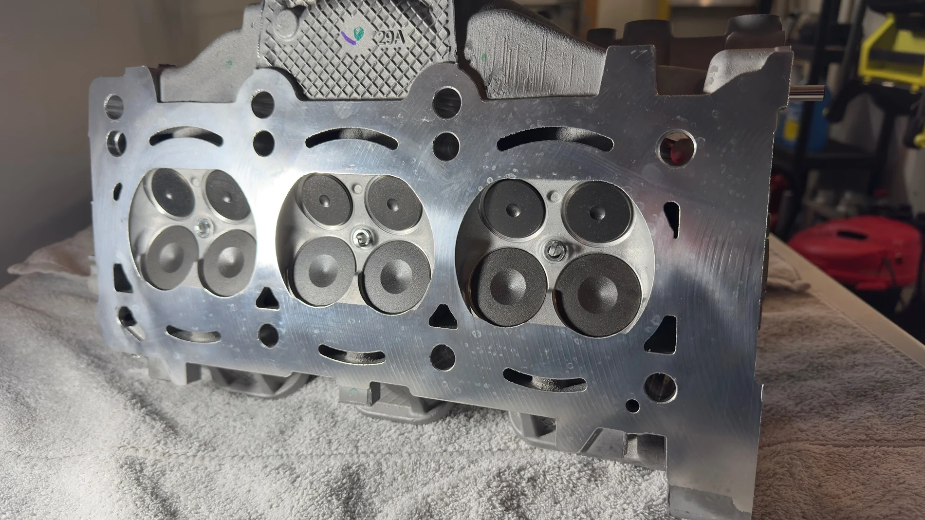

Correct! Never overheated here. Babied life. Had to replace cams and now one head gasket failed in ‘25. (I’m going to replace both banks’ head gaskets and cylinder heads) Tear down revealed 5 loose (er) head bolts. Inconsistent clamping force and I just had to send back a new right bank head that had a deck surface finish that was too rough. Like rough enough to create shadows when shining a flashlight at an angle on the deck. In the industry it’s called “waviness.” As a former automotive machinist, either the mill table was able to move up and down or the bearings were going bad in the milling/surfacer head. You look for three things. Flat. Smooth (RA, roughness average) but they have to have an uber expensive profilometer that some shops won’t have. No waviness akin to rumble strips on the side of the road. That head won’t seal.
I was looking at the used, left bank head and found an aluminum machining chip lodged in a cam journal. SMH
I’ll be removing all the galley plugs on these new heads, inspecting oil galleys, and blowing them out with compressed air.
