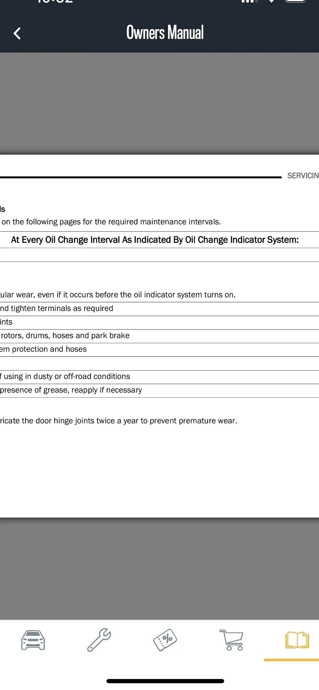

Don't go by the OLM, not your fault though, as Jeep has that feature and advises that owners abide by it.
Sludge from a bad head gasket is not the fault of the oil. Not checking your oil regularly and realizing there is an issue though is your fault, to a point. Everyone should pull their dipstick at least every other week. I check it weekly.
The only other thing that will sludge an engine are a lot of short trips, where the engine never gets warm enough. The block develops condensation which eventually contaminates the oil. If anyone drives a majority of short trips then make those oil change intervals sooner.
Out of curiosity, which oil and filter were you using and what where the mileages on the intervals? Did you keep a log that shows the date, miles and oil used? They should/might be able to scan the Jeep to show how many times you reset the OLM.
The OLM should take short trips and temperatures into its algorithm to count down the oil life faster in those conditions.
It does in a way, as it will time out at a year no matter what the miles are. No OLMs in any make of vehicles analyze the oil though.
