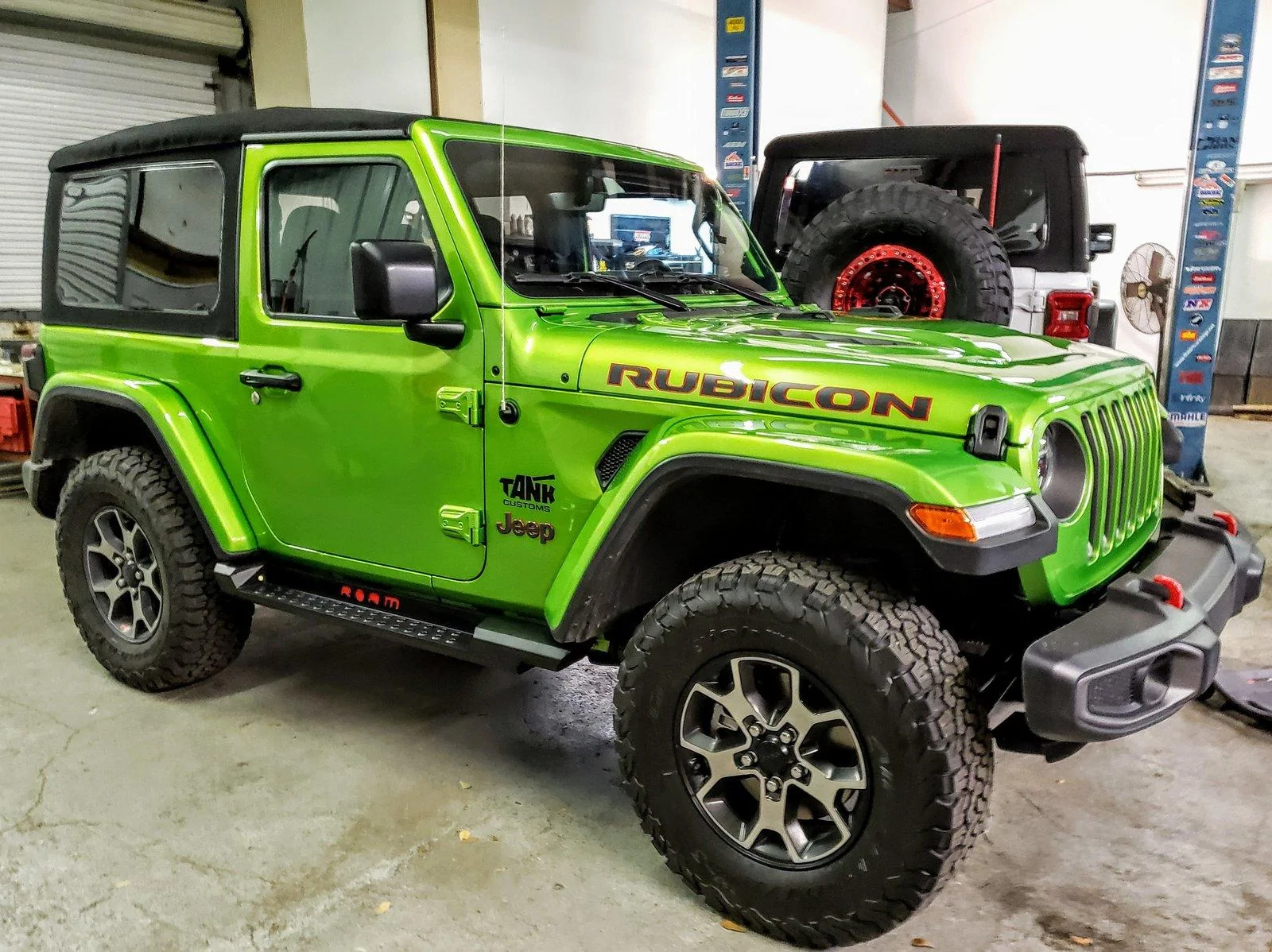

Smokin hot Rubicon!
A couple questions if I may please:
Your new wheels what are all of the specs on them offset etc? Great look!
The KMC’s, are they raw or do they have a protective coating on them? Aluminum?
Do you know the exact weight of the wheel and tire together?
Tires Happy with them?
Link to where you purchased above wheels?
Where did you find your 69 phone mount?
Lot’s of questions but hey, that’s what you get for showing the “Eye Candy” LOL!!!

Wheel Specs: 17" x 9" 5x127.00 -38 3.50 MACHINED finished, they are Aluminum. I do not believe the have a protective coating.
Tires 37x12.50x17 Yokohama Geolander G003 M/T. Very happy with the tires. I daily drive and a quiet tire was important. These are pretty quiet and ride well.
Beadlock wheels are very heavy, I didn't weigh them, but I knew they would be on the heavy side. Most beadlocks 45+ lbs.
Tires are right around 75 lbs each.
Im a partner in a shop, I ordered them through of our wholesale distributors.
Phone mount is from 67 Designs https://www.67d.com/collections/jl-...-mount-driver-edition-with-magmount-pack-jld2

is that the budget boost or coil spring lift?
It's the budget boost (Spacer lift) for now. They didn't have a spring kit for the 2dr at the time we placed the order.
We have a few different 2.5" 4dr Springs from Rock Krawler, Rough Country, and ROAM that we may try out. Our fear is the lift will be too high/stiff with 4dr based springs.

I thought the same thing....I put the rough country 2.5 coil kit for the 4 door on my wifes rubicon 2 door and it looks like a lowrider compared to this one.
