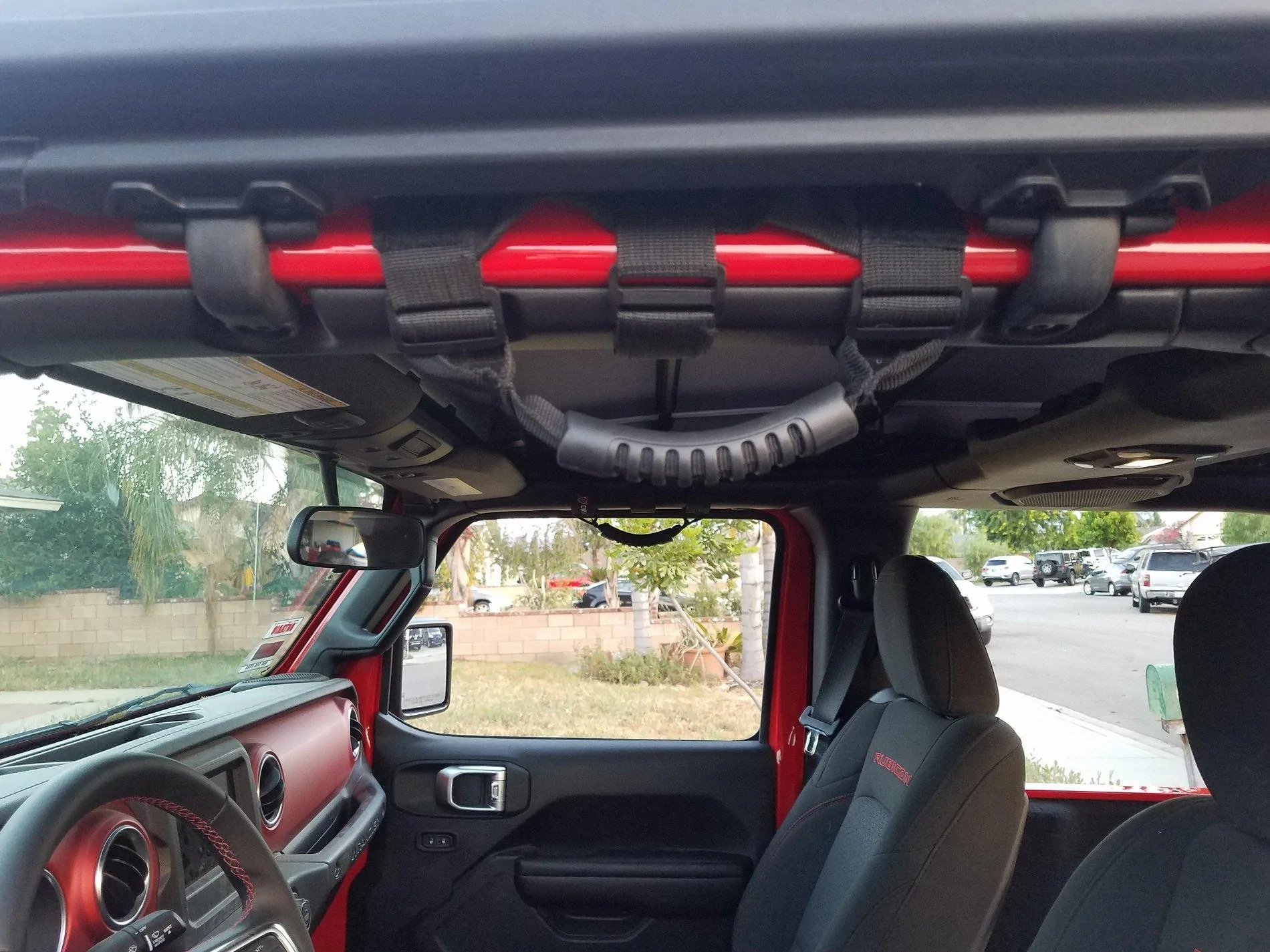

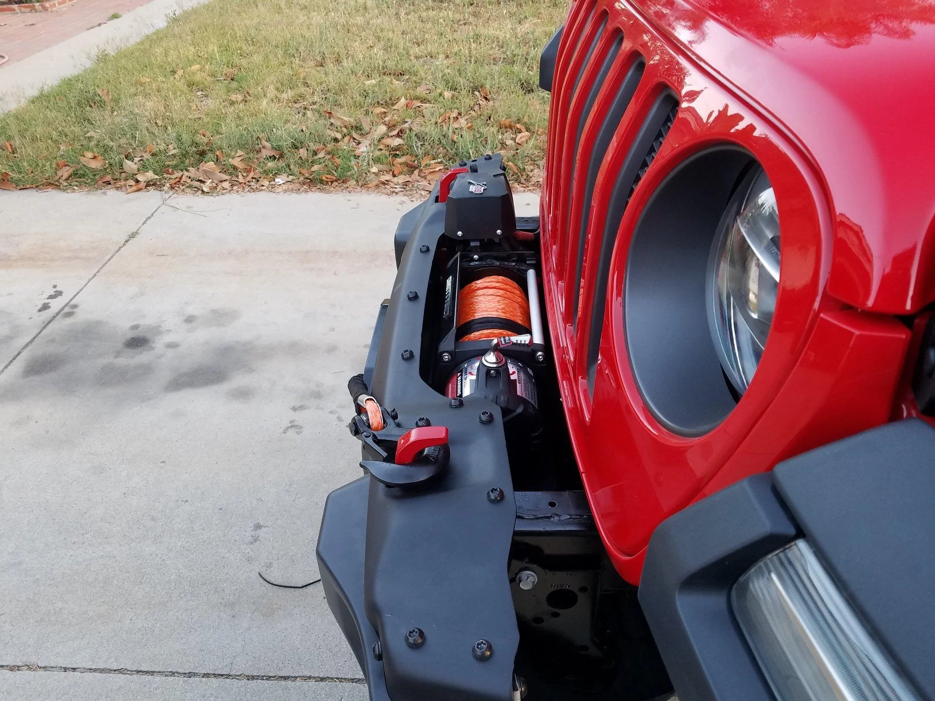

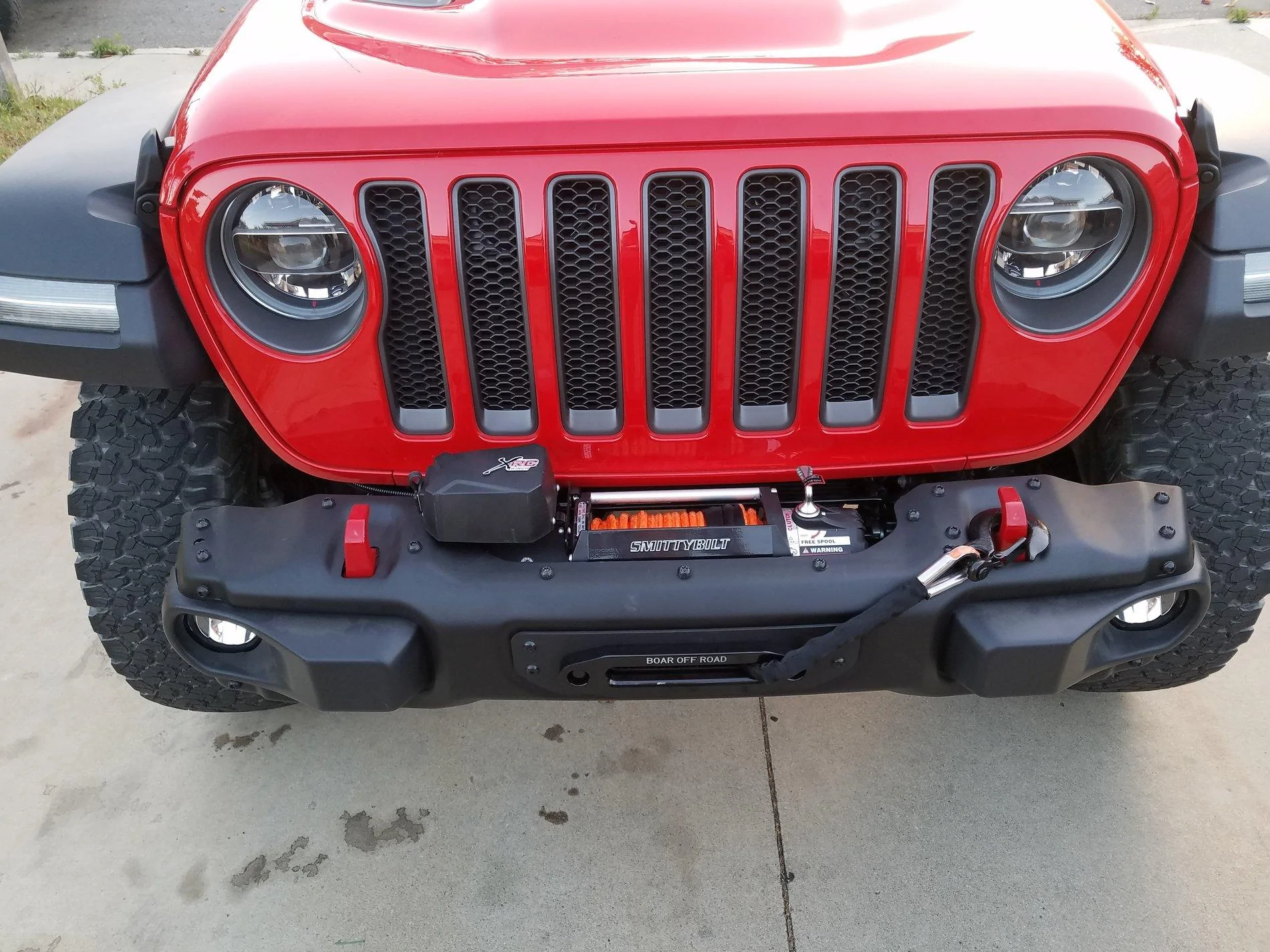

Todays mods. Smittybilt 9500 winch and grab handles. So used to the handles in the old jeep it was a must have. Missed em dearly on the trail yesterday.
I like how that winch tucks down inside the stock bumper or is that the steel bumper?

how come? what were the problems installing the winch? was thinking of getting the smittybuilt also.
actually it went in rather smoothly, some things of note: attach the ground wires to winch first or you will end up taking it out again like i did lol, also a center control box mount would have been easier, i just wanted to be different.
i wasn't expecting that either, it does sit in there nicely, thats the stock steel bumper
Cool thanx for the tips, is that the x20, or the xrc series? nevermind i see the label now
xrc 9500, with JCR mounting plate. One other thing. Have a buddy around, the mounting plate just rests in the bumper till its bolted to the frame so two guys to get it to the frame helps and leave all your nuts loose for minor afjustments, tightening only when you are satisfied
