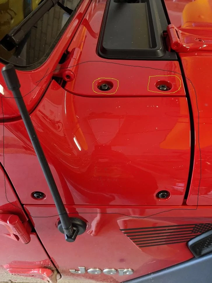

I had severe noise from that area. The small body panel that covers the area right behind the antenna was not flush. I loosened the torx bolts and adjusted it and that fixed the problem.
May not be your issue but worth a look. PM me if you need more info.

Would you please post a pic of the area. I am chasing multiple areas of noise and that is one of them.

Panel circled in black. It was obviously not flush. I believe I loosened the torx screws shown and moved it in so it was flush. Then retightened.
Dealer is full of crap. You shouldn't have noise like an open window. Yes at 80 mph the Jeep has some noise, more than many modern vehicles, but you should be able to carry on a normal conversation.

I have so much wind noise from the top right passenger side window that driving anything over 45 mph I always have to check to make sure the window is all the way up because it sounds like it’s either cracked open or just all the way down when it isn’t.
Check that body panel as pictured a few posts up.
