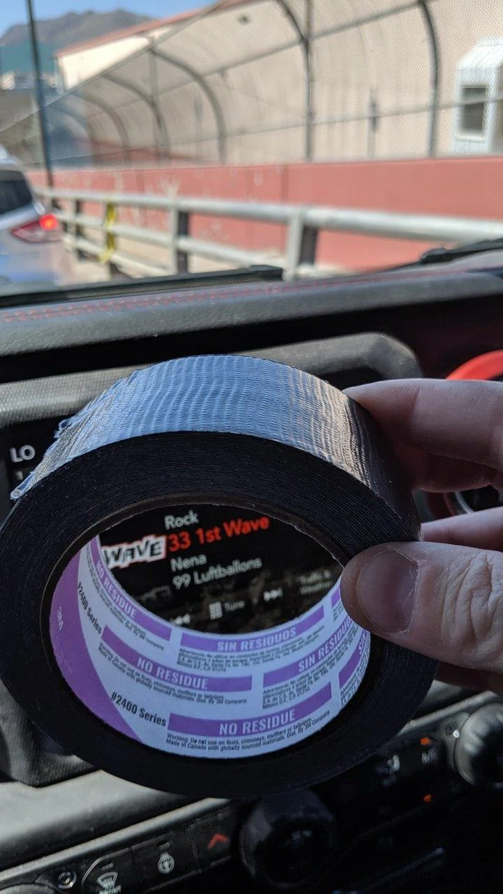

i hadn't even made it past page 2 of this thread when i went out and tried this. then reading page 3 and 4 it seems like a match. i don't have a whistle, but i have loud wind noise, more on passenger side. As diagnostic, i used 3M no residue duct tape (can't find at Lowes but amazon shipped it to me in 1 day). first picture here of sealing around the windshield i noticed a difference. I then applied it mirror image on driver side and across full top (nothing on bottom for the moment).
80% reduction in windnoise estimated..... give it a try. .... think i'll now look for the gaps others have posted...

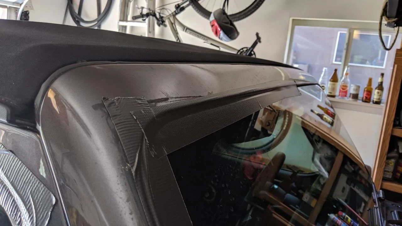

I've been struggling with this issue as well. Piercing loud wind noise that was hurting my ears, and preventing me from having any kind of conversation at all with my kids in the back seat while on the highway.
I tried all of the suggestions in this thread, such as taping along windshield, adjusting windshield, inspecting seals behind windshield, aligning freedom panels, etc. None of that helped.
In my case it turned out to be the little triangular plastic pieces next to the side mirrors. I put tape over the gaps around the edges and it was as quiet as a Mercedes Benz after that. Even my wife commented on how much quieter it was.
Looks like wind is hitting that side mirror and being pushed into the gaps behind those little plastic triangles, and behind that triangle is a bunch of huge holes that let air rush into the door near the A-pillar.
I ended up putting silicon under it to seal it, and it worked great. Try it out!
