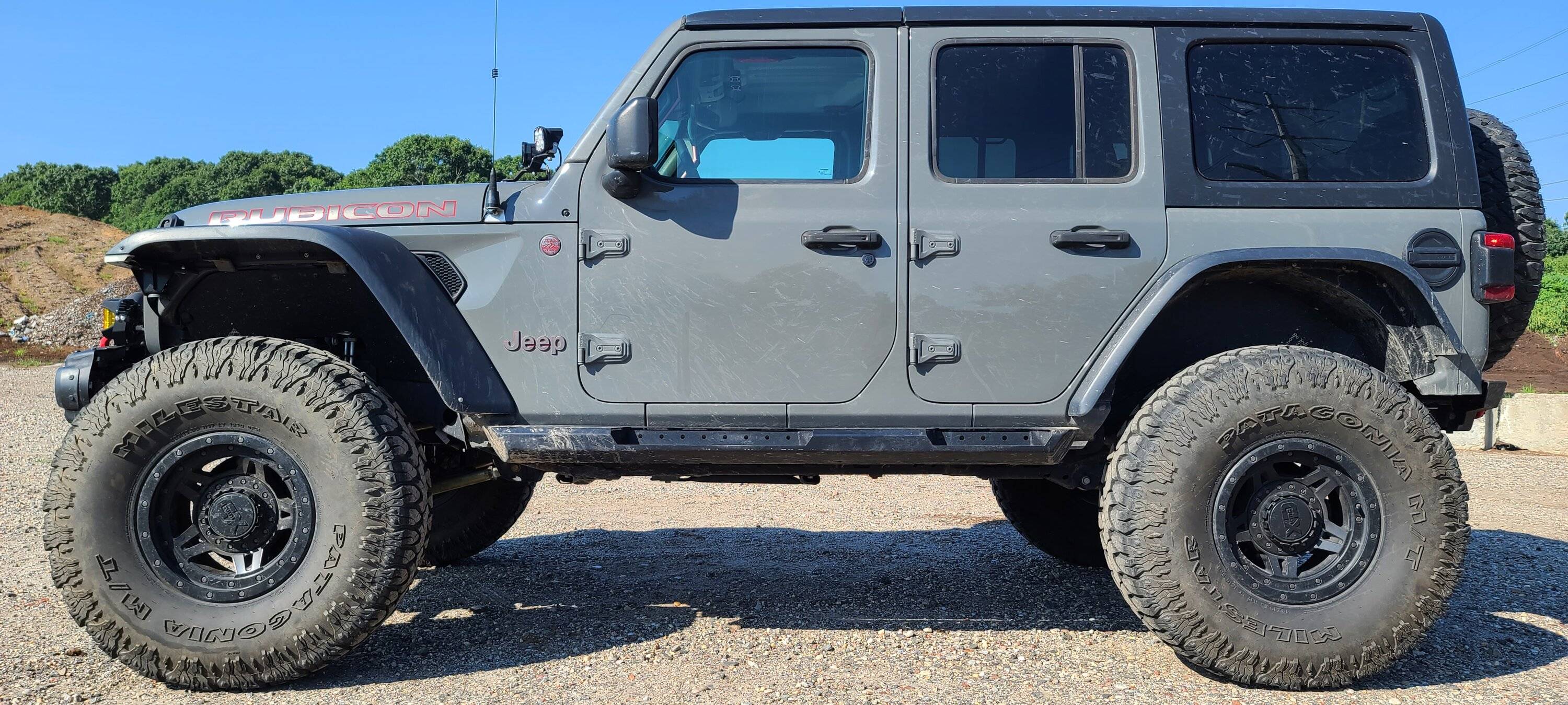

2019 JLUR Stingray 2.0 turbo
Even at sea level, the 2.0's low and mid range torque curve has proven to be resistant to too much performance loss when switching to larger tires.
Here's my 19 JLUR with the eTorque 2.0, 3.5" Gamechanger, and 38x13.5's. Still has the factory 4.10 gears and performs great both on and off road. The need for shorter gears is barely a blip on the radar.

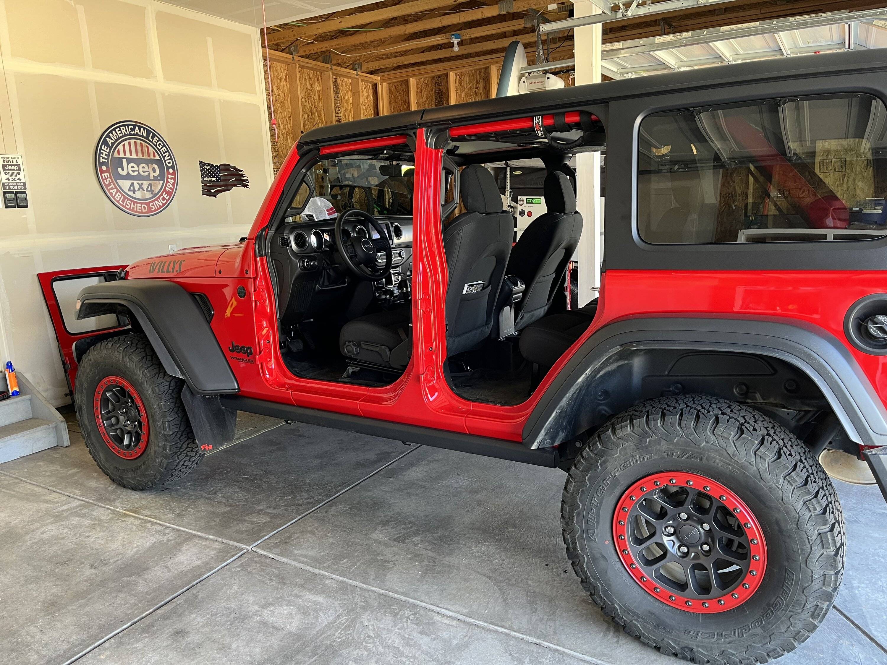

79 CJ7, 82 CJ7, 88 YJ, 2000 TJ, 2008 JKUR, 2012 JK sport, 22 Willys unlimited XR
Retired soldier/Doc
2.0 xr is a blast to drive with way more torque in the low rpm range compared to v6
