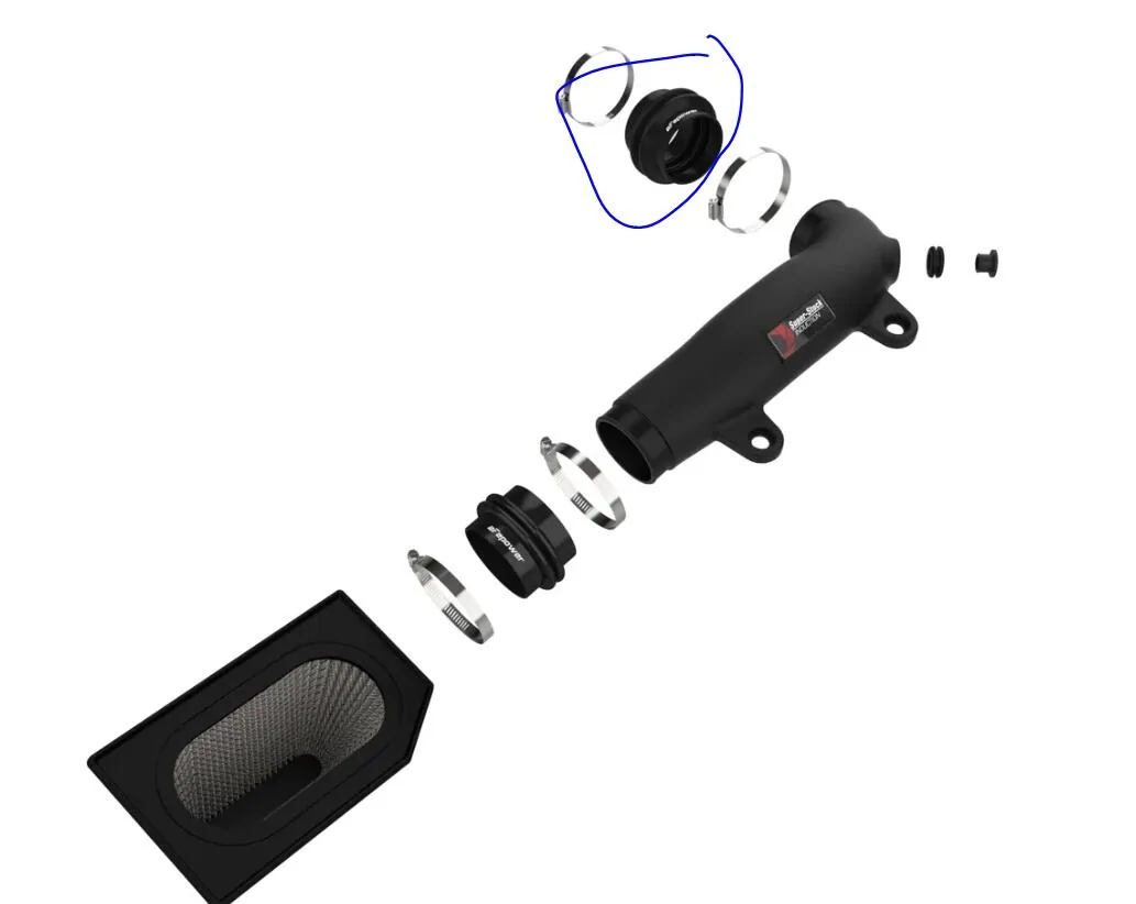

Well the AFE super stock kit pretty much replaced the tube streamlining the airflow as opposed to having multiple Chambers to go through. Still used the factory air box and everything else so not changing the setup very much
I'd think you could source a silicone aftermarket generic adapter to replace this, would that do it? Throw a caliper on either end to size.
EDIT: AFE has some options: https://afepower.com/products/universal-racing-products/couplings-couplers

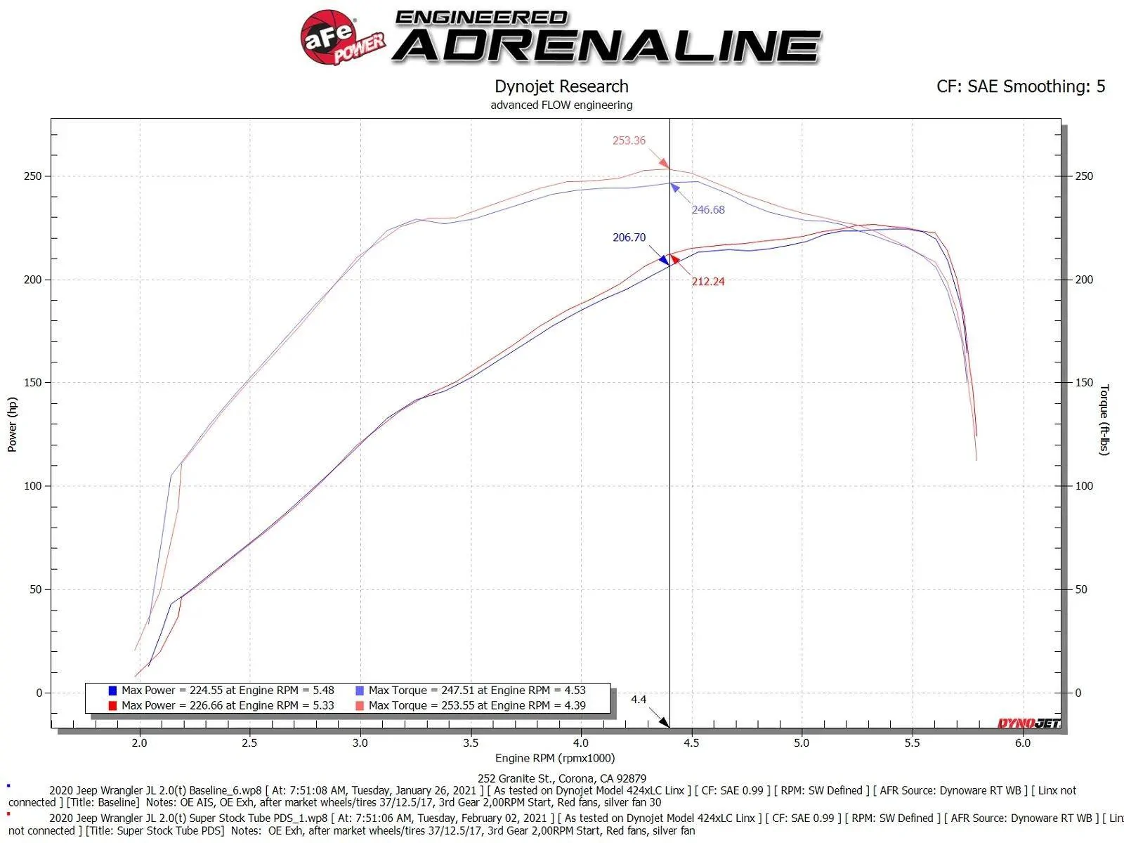

I run that filter as a drop in. I did not bother replacing the pipe. I live in Kalifornistan. So the pipe would not pass the arbitrary smog inspections as dictated by the state. Let me know if your butt dyno actually feels any real difference if you actually do get one. I am unaware of what the differences are in the 23- vs 24+ years on the 2.0L. That would prevent it from working or needing a different part.
They don't have dyno comps, but the filter doesn't appear to be the limit.
AFE shows stock filter flows 320 CFM, and stock assembly flows 280 CFM.
While the filter in space can flow almost double, in the Super Stock Assembly they measured 290/295 with their two filters.
The dyno sheet is probably butt imperceptible, minor difference up pretty high.
Looks pretty though, and looks like it maintains the factory water intrusion drain and air gap from the lower half of the air box.
