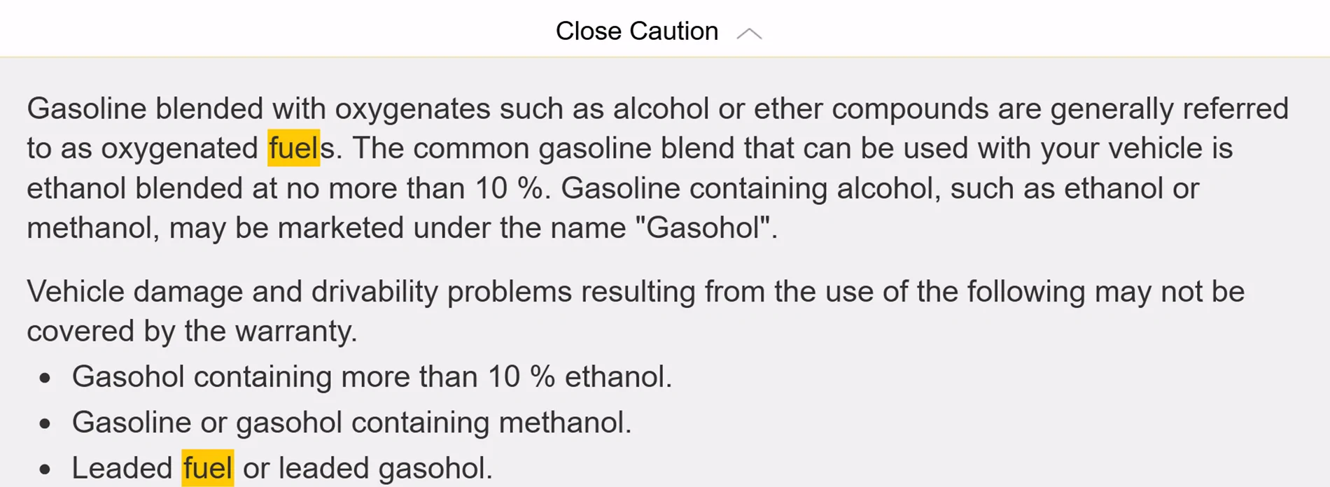

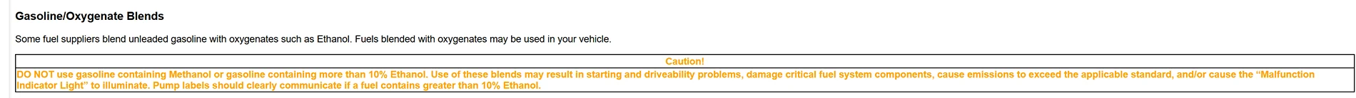

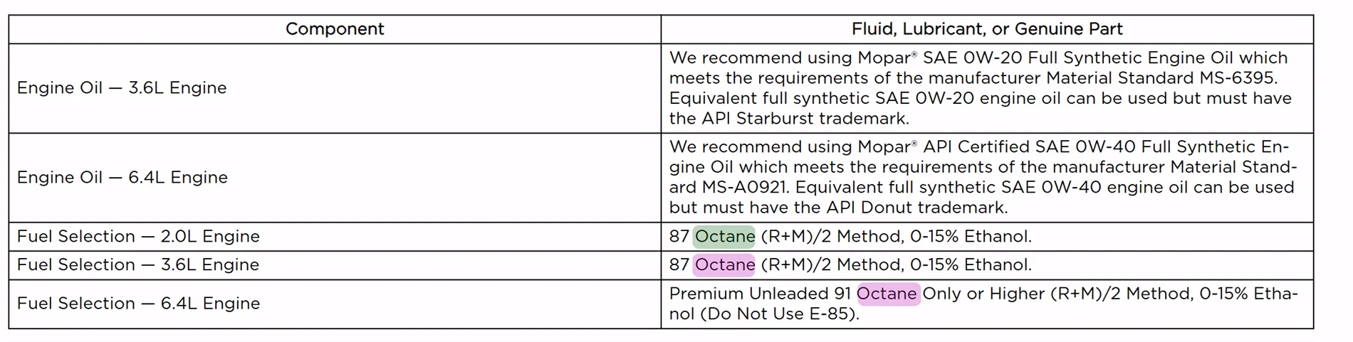

READ YOUR OWNERS MANUAL. Many vehicles (such at the JL) are approved up to 15% ethanol.
Some, such as the current generation miata, are only approved for 10%.
If your owners manual states 10%, DO NOT use 15% ethanol. I'm not getting into politics, but whomever decided to release 15% ethanol in place of normal 10% has absolutely no idea the damage this will cause. It's pure ignorance. Ethanol is great but it requires PCM programming, and in some cases flex fuel sensors, to properly run.
JL:
Jeep Wrangler JL 15% Ethanol Starting May 1st? 1777420541480-9r
This is from my Miata's owners manual:
Jeep Wrangler JL 15% Ethanol Starting May 1st? 1777420582008-6t
edit; older vehicles such as the 3.8l JK also require 10% or less:
Jeep Wrangler JL 15% Ethanol Starting May 1st? 1777420859267-3o
This is more of an issue for older vehicles than newer ones, be sure to check your manual.
