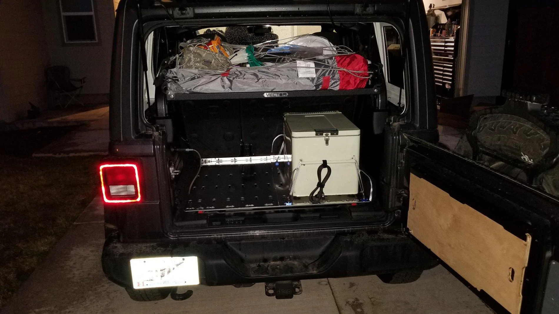

I have been running mine off of the 12v outlet in the back 24/7 for a couple months and have zero issues. The only thing I don't like is the plug sticking out - takes room/feel like its going to get broken while off roading - from being smashed by fridge - just ordered the ARB fridge wire kit so I can mount it out of the way and lock my fridge down to the tie down spots.Is anyone running theirs off the factory 12v outlet in the back, any problems? I have the ARB fridge and was wondering if I'll need to run a dedicated power from the battery once my JLUR comes in.
How did the ARB wire kit work out, did you wire it thru the aux panel on the dash?I have been running mine off of the 12v outlet in the back 24/7 for a couple months and have zero issues. The only thing I don't like is the plug sticking out - takes room/feel like its going to get broken while off roading - from being smashed by fridge - just ordered the ARB fridge wire kit so I can mount it out of the way and lock my fridge down to the tie down spots.
haha, good question. I have been too busy to get around to it. Its been sitting in my garage for a few weeks now.How did the ARB wire kit work out, did you wire it thru the aux panel on the dash?
We used the arb wiring with our snomaster cooler. It’s 8ga and designed to be ran from the battery. We did that and mounted the plug in the cargo tray under the cool. Drilled a small hole for the plug and it’s tucked out of the way. Works great. The rear plug will work (kinda). There’s a bunch of loss in the factory wiring.How did the ARB wire kit work out, did you wire it thru the aux panel on the dash?
