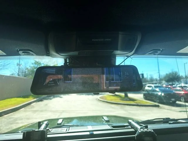

1. The display that mounts to the rearview mirror is 12" long. This view is of the rear camera.

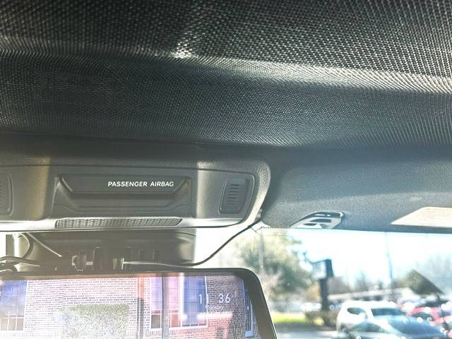

2. The camera power cable, GPS cable, and rear camera cable all are routed through the overhead console, down the passenger A-frame pillar, behind the dashboard and glove box, and down to the floorboard. The rear camera cord is routed down the passenger side trim, under the carpet and to the back panel, and out the grommet on the rear door. The power cord is routed from behind the glovebox, down into the passenger floorboard under the carpet. I am using the 12 Volt plug in to power the camera.

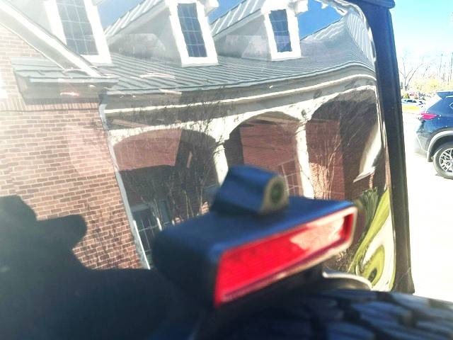

3. The rear camera is mounted on top of the third brake light with 3M heavy duty tape. It has stayed secure through all sorts of weather here in southeast Texas.
