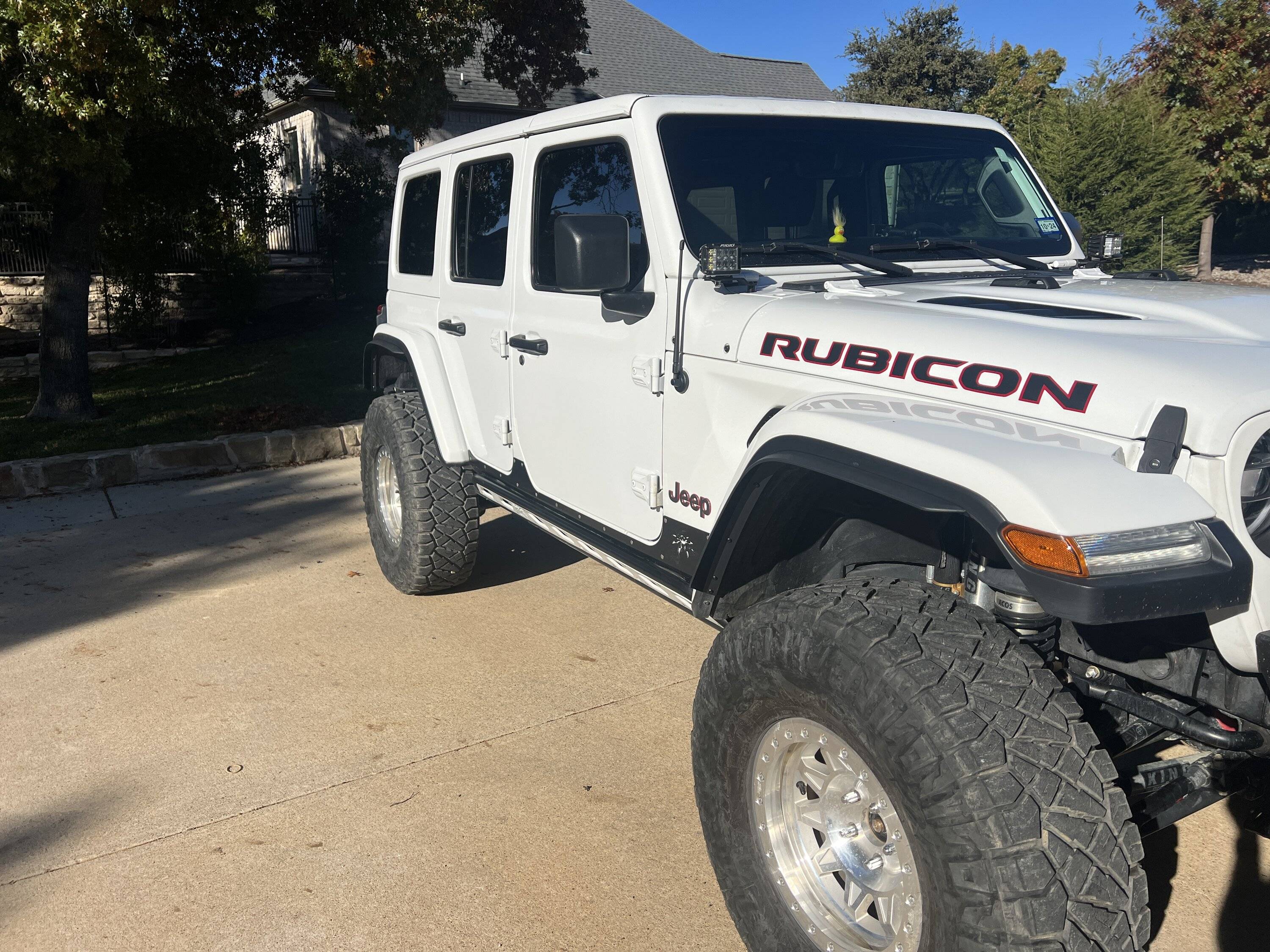

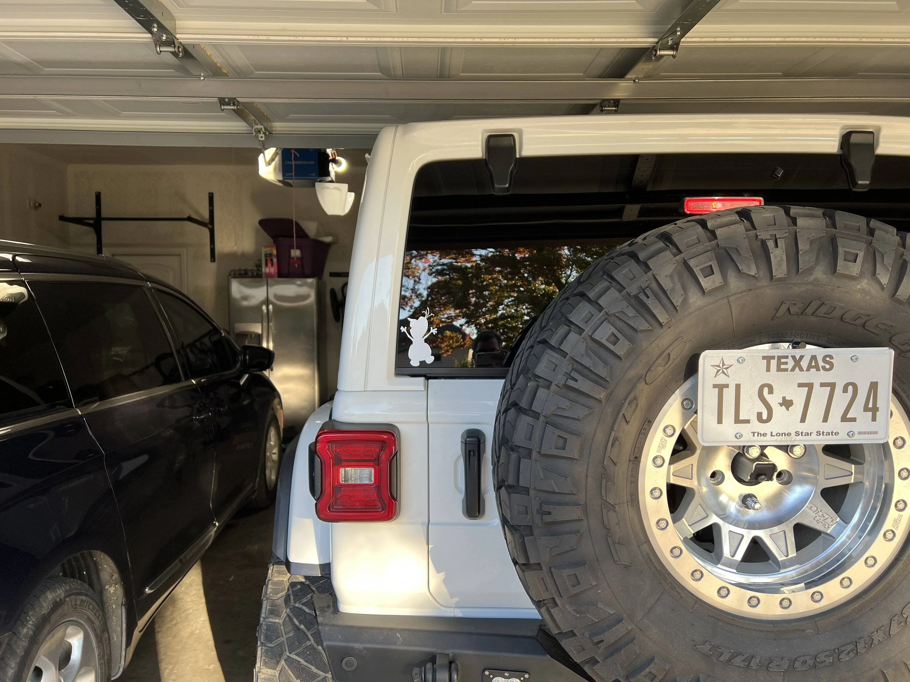

I am the second owner of Olaf; I purchased him just 48 hours after discovering my first Jeep, Dory the 392XR, was stolen from DFW airport. The previous owner, @iddpaul, built a great rig and took immaculate care of Olaf, but needed to upsize to a Gladiator to tow a new trailer and posted Olaf on the forum classifieds. Olaf had not sold after a couple of weeks and was set to be traded in at the dealership, destined for a future of underappreciation. I discovered my 392 stolen on a Tuesday, found Olaf here on the classifieds on Wednesday, flew from DFW to Tampa, FL, on Thursday afternoon to purchase, and then drove it 17hrs home on Friday.
Upgrades made by Paul before my purchase:
  • Full XPEL PPF on front, hood, pillars, front and rear fenders, plus full ceramic coating and front window tint
  • 17" Dirty Life Roadkill Beadlock Wheels, 4.45 Backspace, 37/12.5/17 Nitto Ridge Grapplers
  • EVO MFG 3.5" Enforcer Overland, Stage 4 Plus, w EVO Spec Kings
  • King Steering Stabilizer
  • RK Front Spring Pad Correction
  • Synergy HD Sway Bar End Links
  • Synergy Front Track Bar Brace & Sector Shaft Brace
  • JKS ACOS Front and Rear Adjustable Coil Spacers
  • Steersmarts Yeti Tie Rod and Drag Link
  • Adams 1350 Front and Rear Driveshafts
  • Reid Racing knuckles
  • Currie LP60 and HD60 semi float 1 ton axles (4:88/elockers)
  • EVO extended stainless brake lines
  • Savvy Magnaflow axle back exhaust
  • FabFour Stubby Front Bumper
  • Next Venture Motorsports Rimrocker Rear Bumper
  • Maximus3 Spare Tire Carrier
  • Currie axle skid plates / covers
  • Poison Spyder Rocker Knockers / Body Armor
  • Rigid Front Bumper Floods / Pillar Rigid D-SS Pro
  • Warn EVO 12-S Winch / Synthetic Rope
  • Factor55
  • Genesis Dual Battery / Gen 3 Power Hub
  • Tazer JL Mini, Tazer Z-Locker Controller

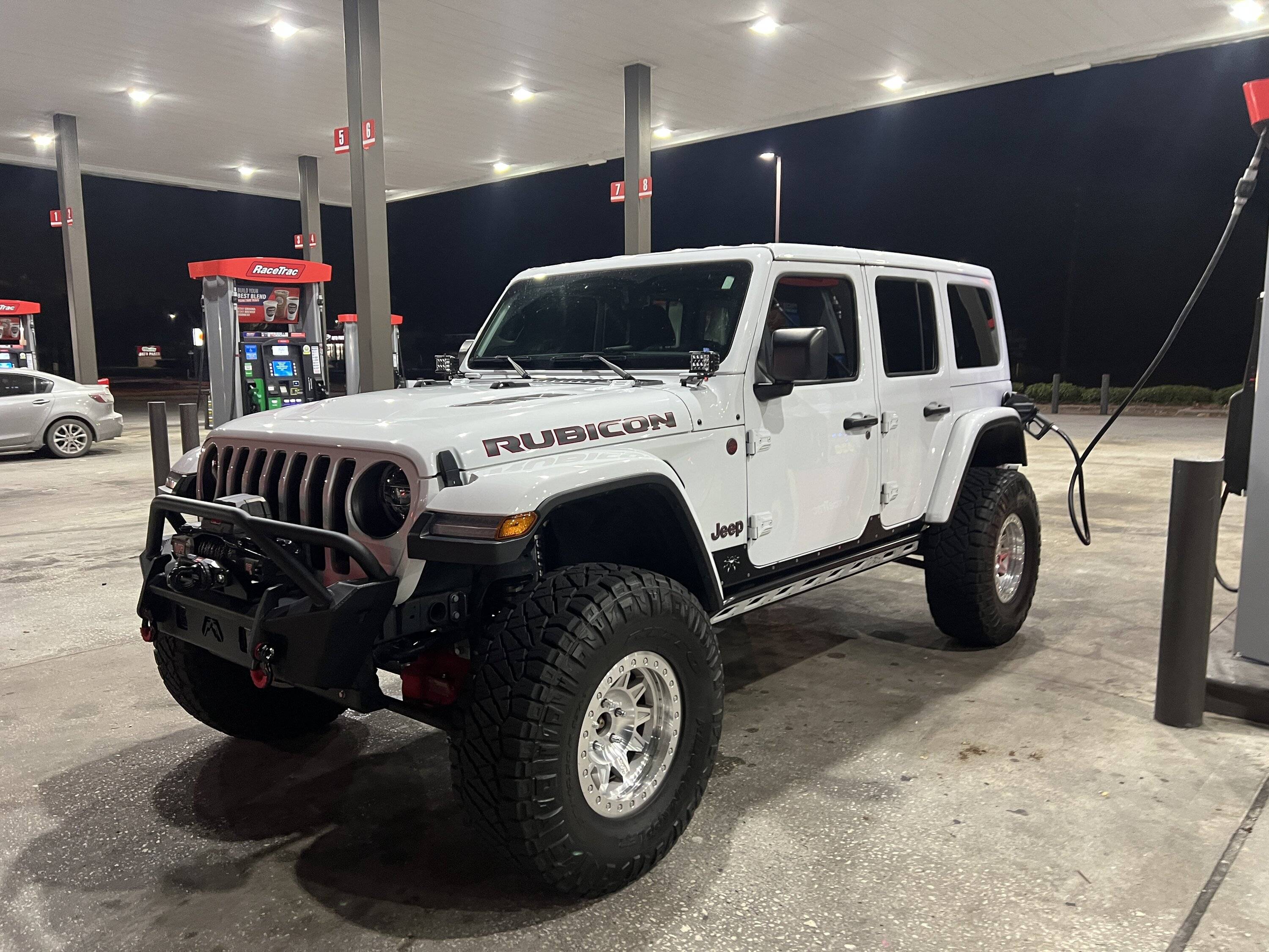

First fill up before starting the 17hr drive back to Texas!

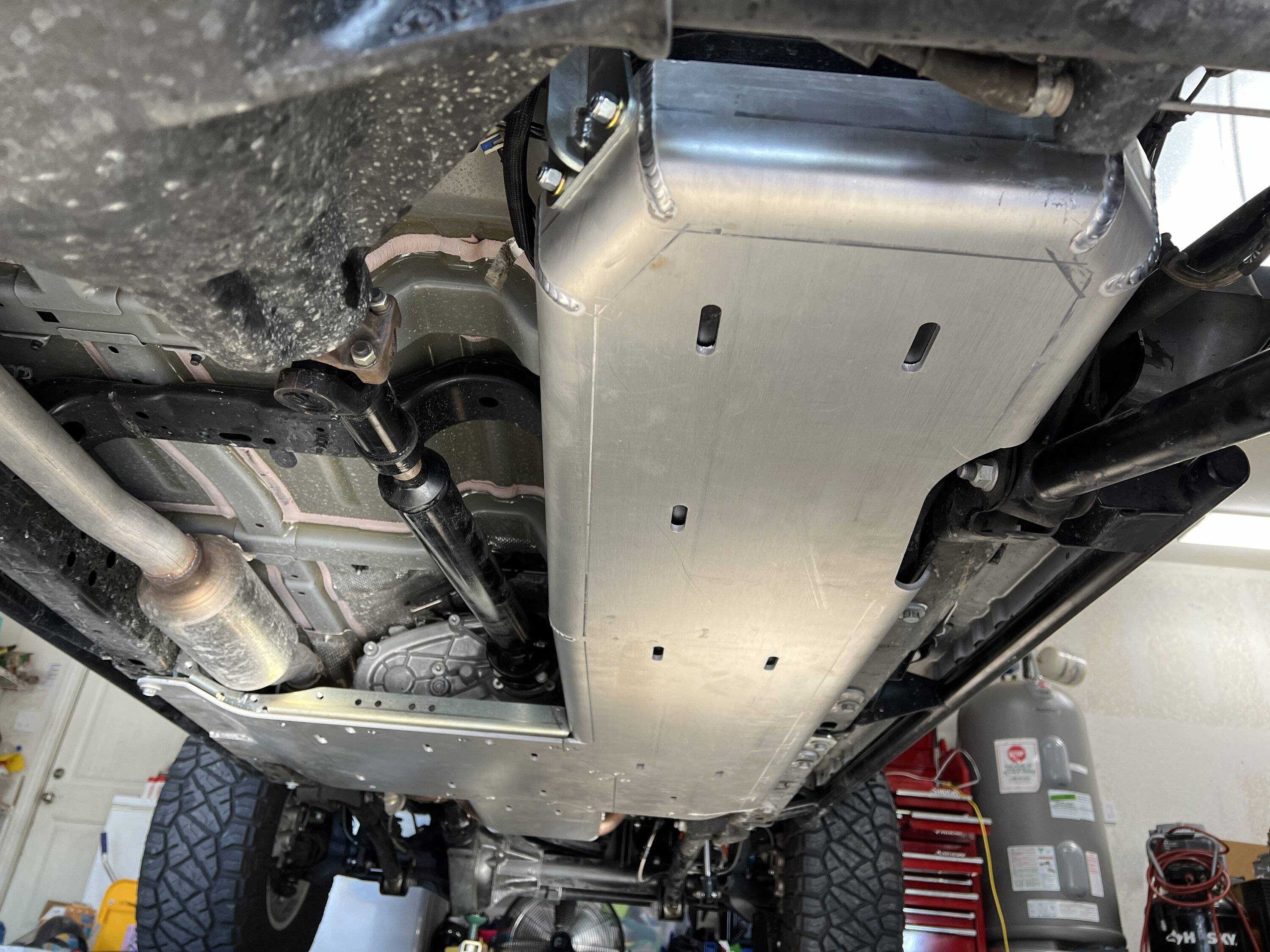

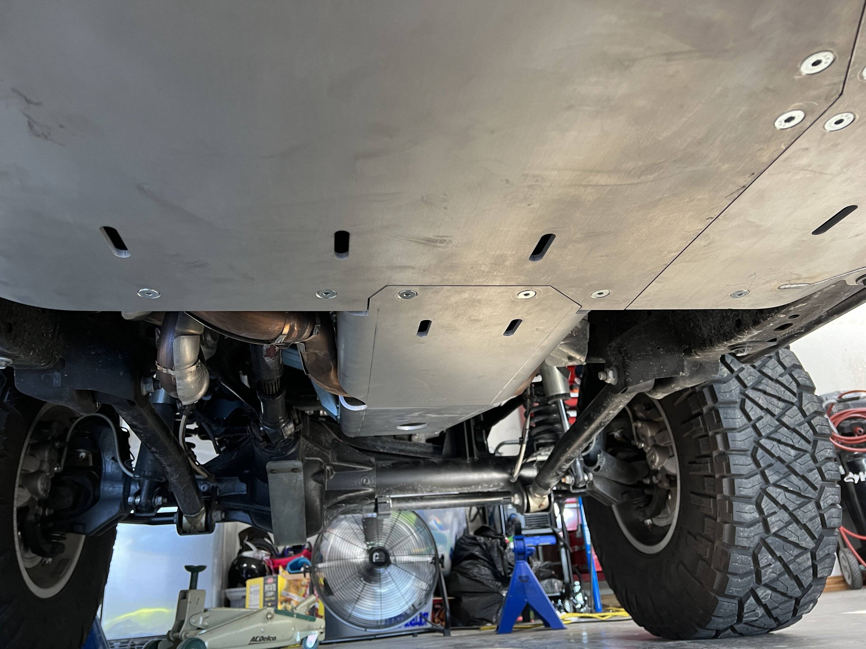

Paul had purchased but not installed a full Artec Aluminum belly skid kit. I am impressed with the quality of the skids and hardware; the instructions were also very detailed. The installation went well, with no major hiccups. I'm looking forward to getting these scratched up in Hot Springs next week!

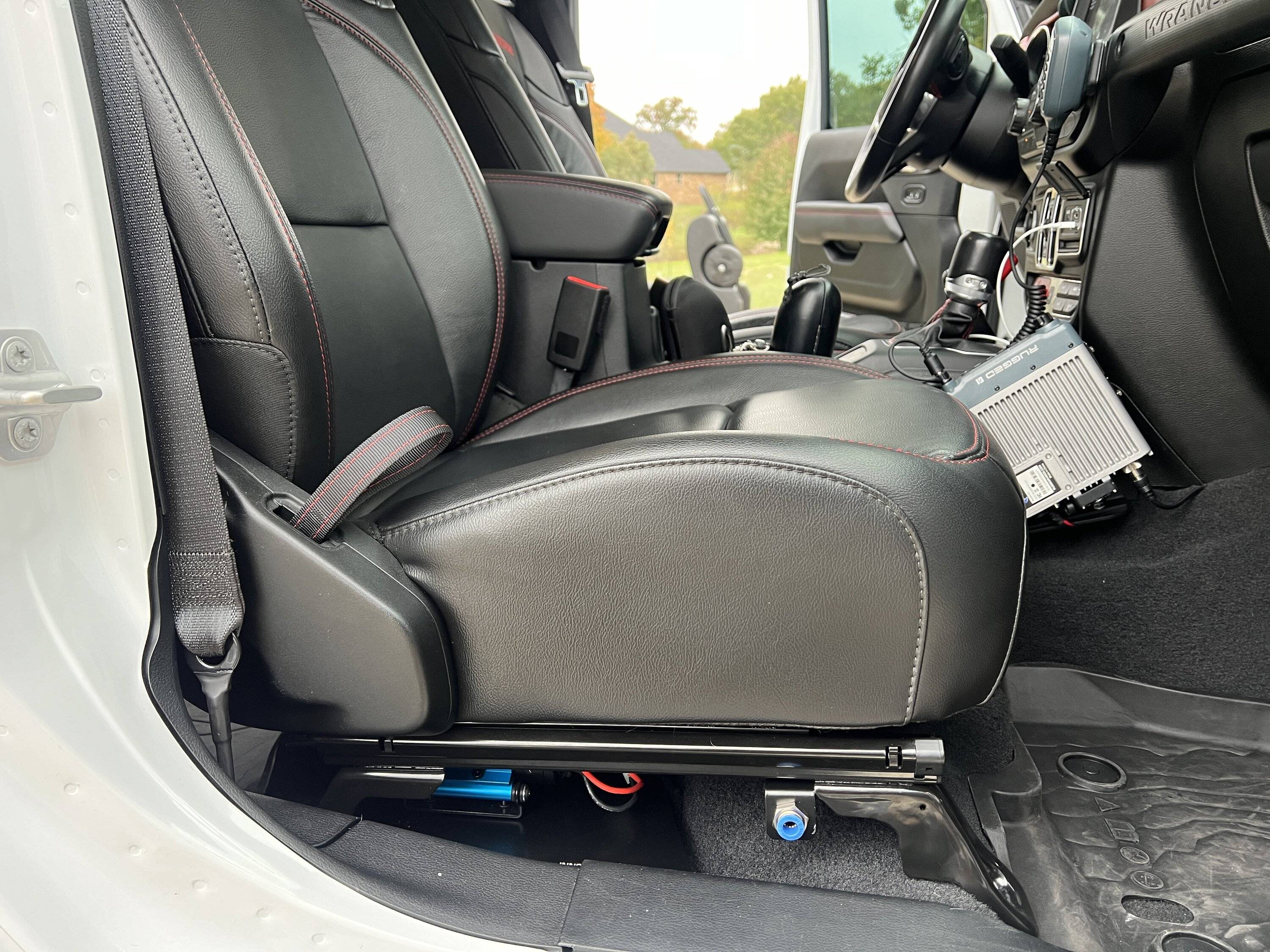

I completed the first round of mods for our first major outing in Olaf to Hot Springs, AR.

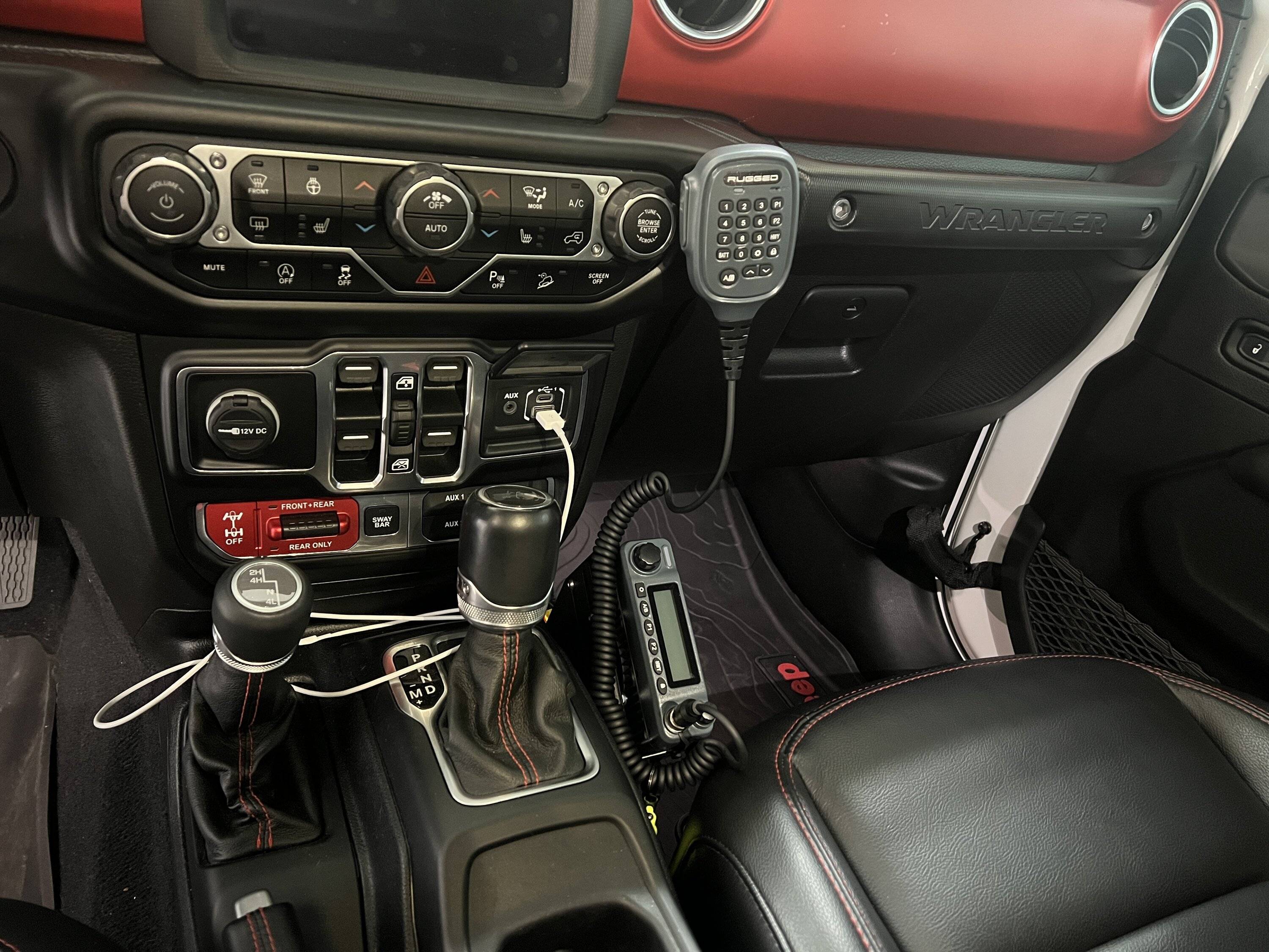

  • Rugged G1 ADVENTURE SERIES Waterproof GMRS Mobile Radio JL Kit
    • Overall, I'm impressed with the radio's audio quality, and the customized harness for JL installation is a nice feature. I am not experiencing rouge interference like I was with my GM25 that was installed on Dory.
    • Jeep Wrangler JL Olaf: The 2020 JLUR Rebound Jeep IMG_5968
  • Innovative AT Products 4-Tire Air System (Bluetooth) with ARB Twin Compressor
    • I had the non-Bluetooth version of this inflation system in Dory, and I absolutely loved it. This kit has received some minor improvements to equipment and installation techniques since my first purchase. No more drilling holes in your seat frames, and the air line routing has improved.
    • The ARB compressor control module and app are nice, though not perfect. The air-down process is notably slower than using the manual version of the kit or using a valve stem-removing deflator. The app's benefit is that you can set it and forget it. If you know you won't be wheeling for a while, you can use the app to set the deflation pressure and then walk away. The system will automatically stop deflating at the desired psi, even if you are nowhere near the vehicle.
    • Airing tires up with the app is essentially the same time as doing it manually of the ARB Twin compressor. Again, the primary feature is setting the desired pressure and walking away. You can also set the app to max pressure and use the compressor as you would without the app/module.

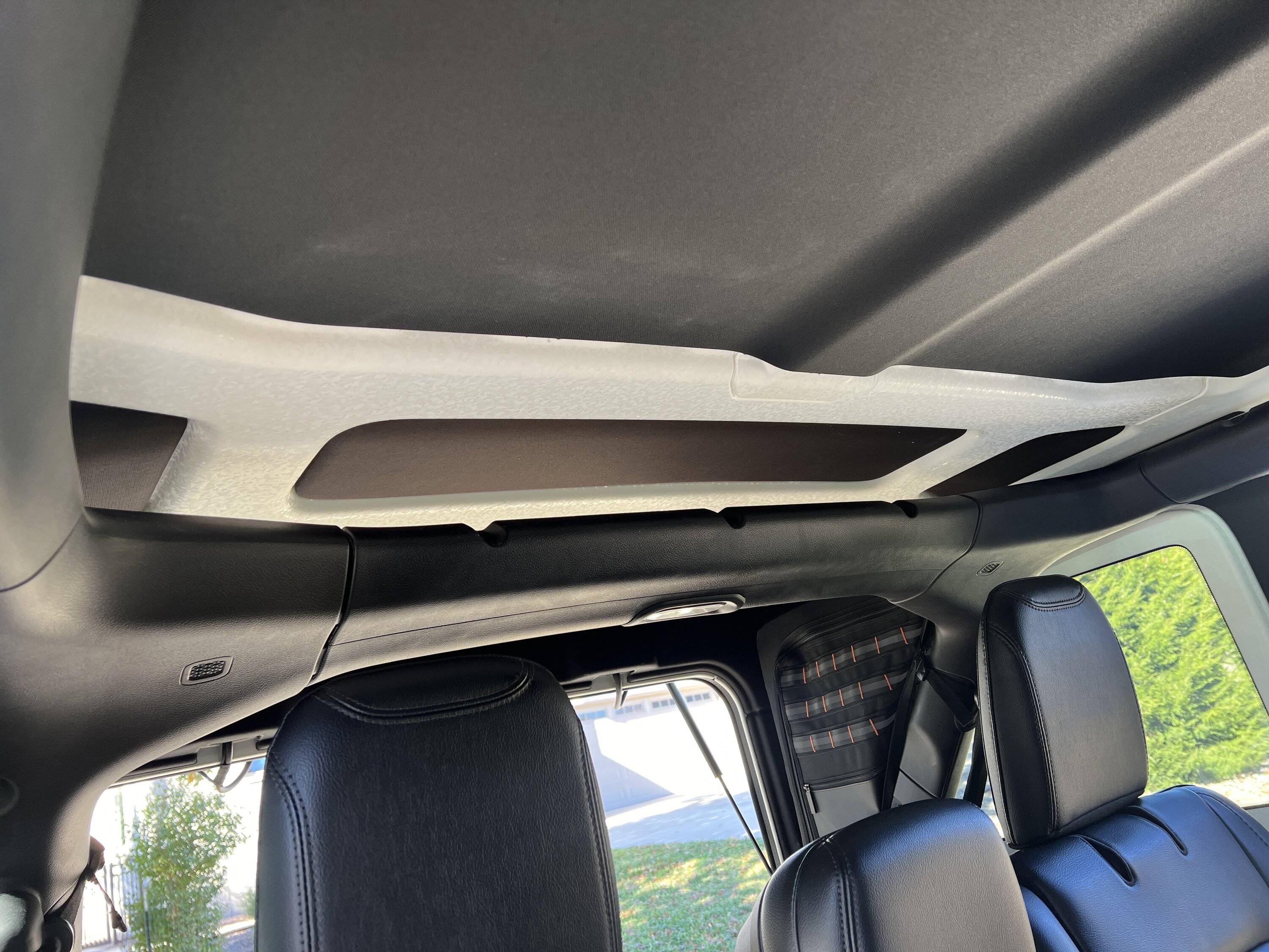

  • Hot Heads Headliners OEM Headliner Completion Kit
    • Color matching looks better in real life than in the photo. Please give me as much sound deadening and thermal insulation as possible.

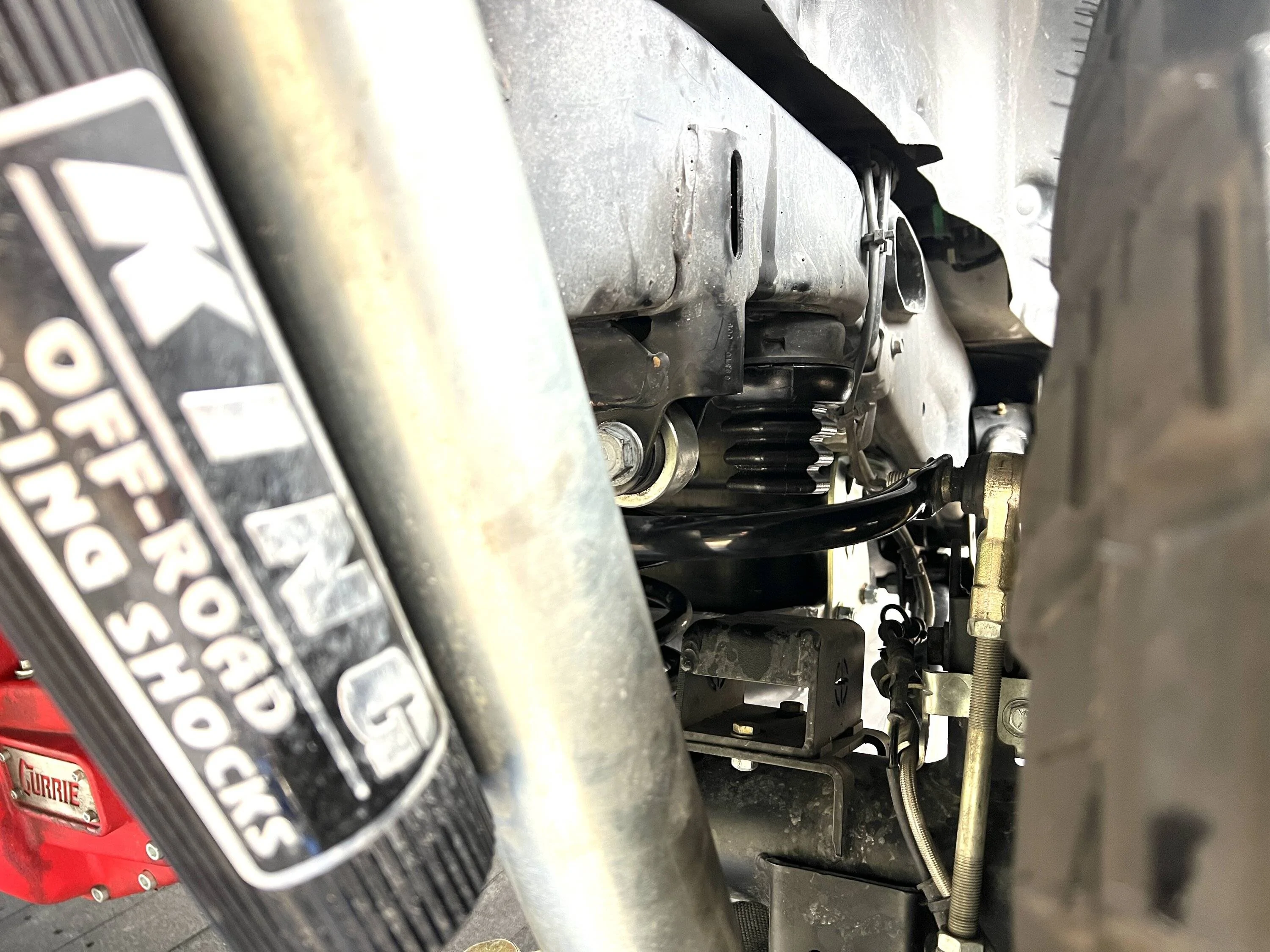

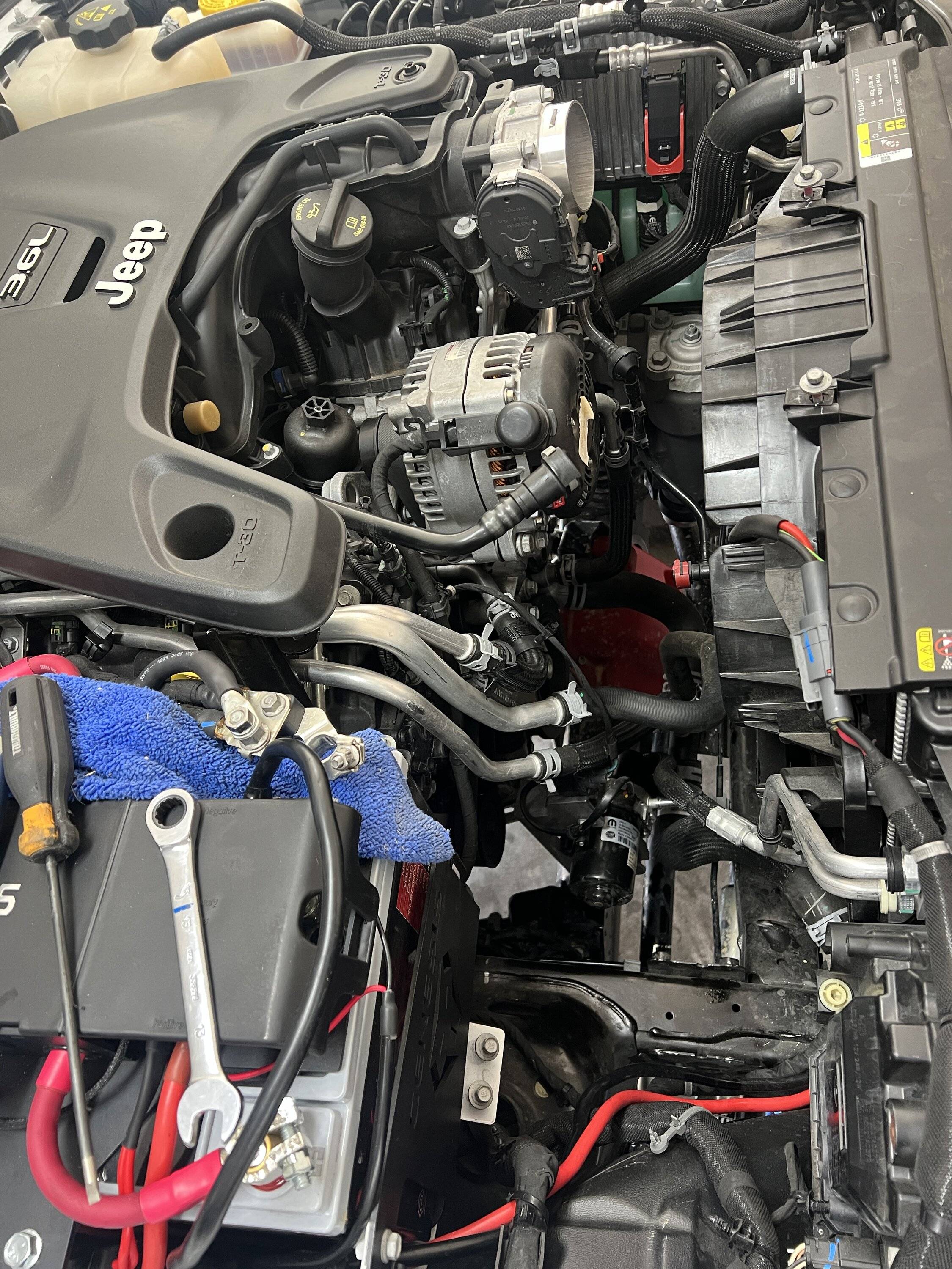

After our first big trip in Olaf to Hot Springs I observed my wife struggling to steer the 37s at 9psi whenever we were in situations where there was pressure on the front of the Jeep. “Her” LJ already has hydro assist steering and since we trade Jeeps back and forth when wheeling as a family I determined I must upgrade my Jeep “for her”…so…
I’m about 8hrs into installing a PSC cylinder assist steering kit. I called PSC and asked about the pros and cons of the electronic pump kit vs the mechanical pulley pump kit and they steered me directly to the mechanical route.
PSC used to be located about 50yds from my office, but they have now moved north, and I had to drive a few miles to go pick up the kit. I ordered over the phone and drove over to pick it up, you can’t beat that!
Jeep Wrangler JL Olaf: The 2020 JLUR Rebound Jeep IMG_6006
Electronic pump out!
