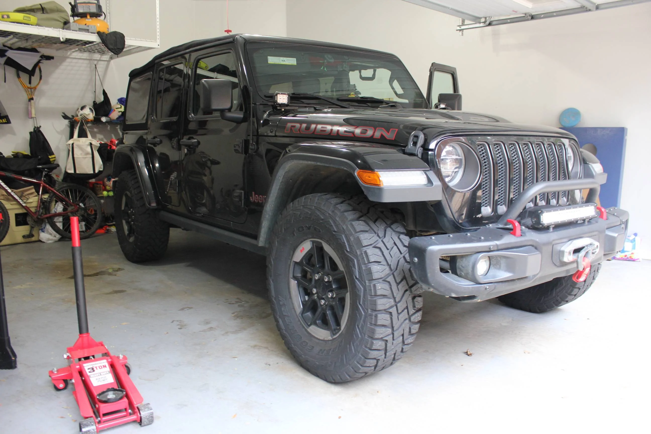

A before, during, and after pic for your enjoyment.
Before:

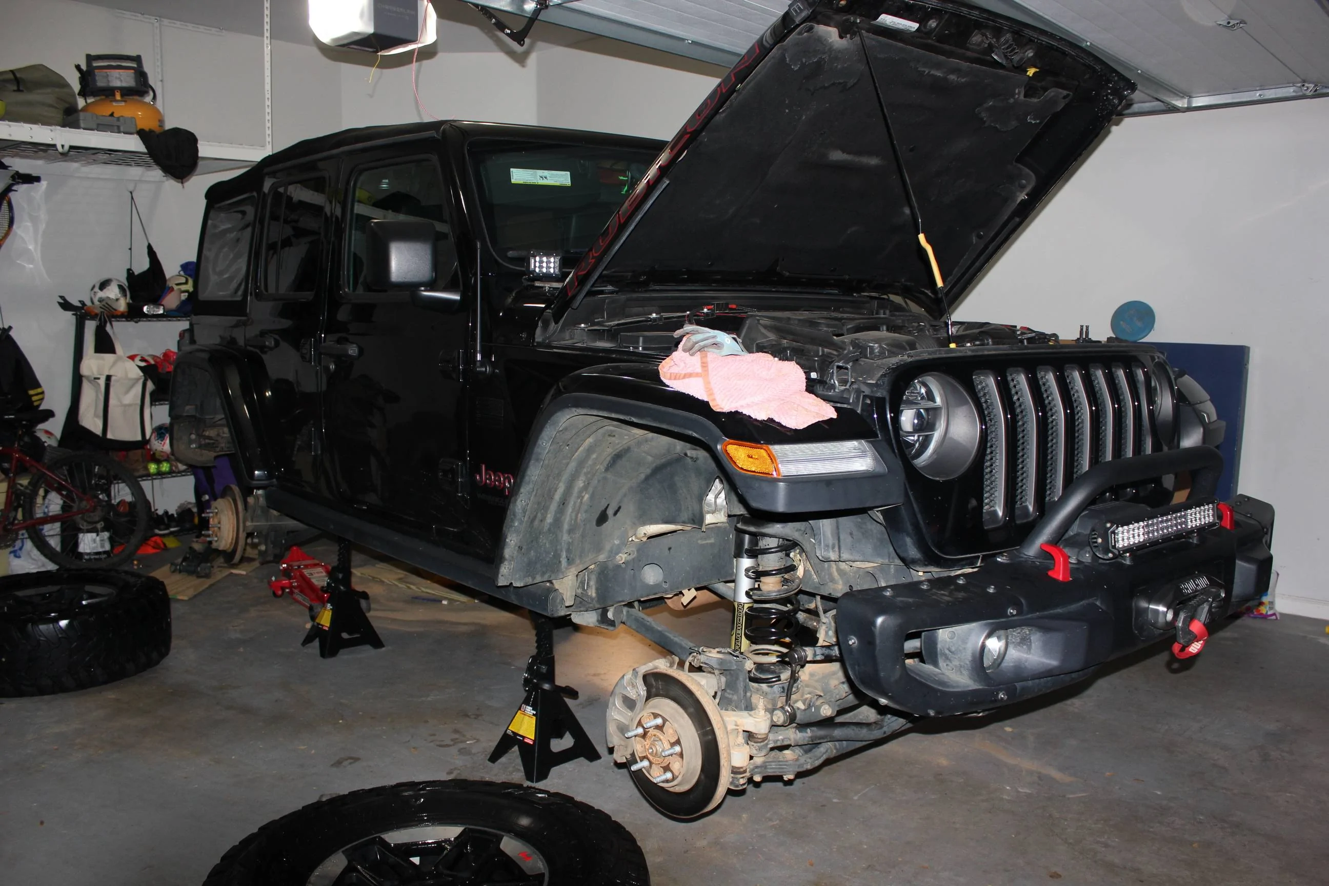

During:
Jeep Wrangler JL Tips for 392 Suspension Install on Standard JLU Rubicon IMG_2918

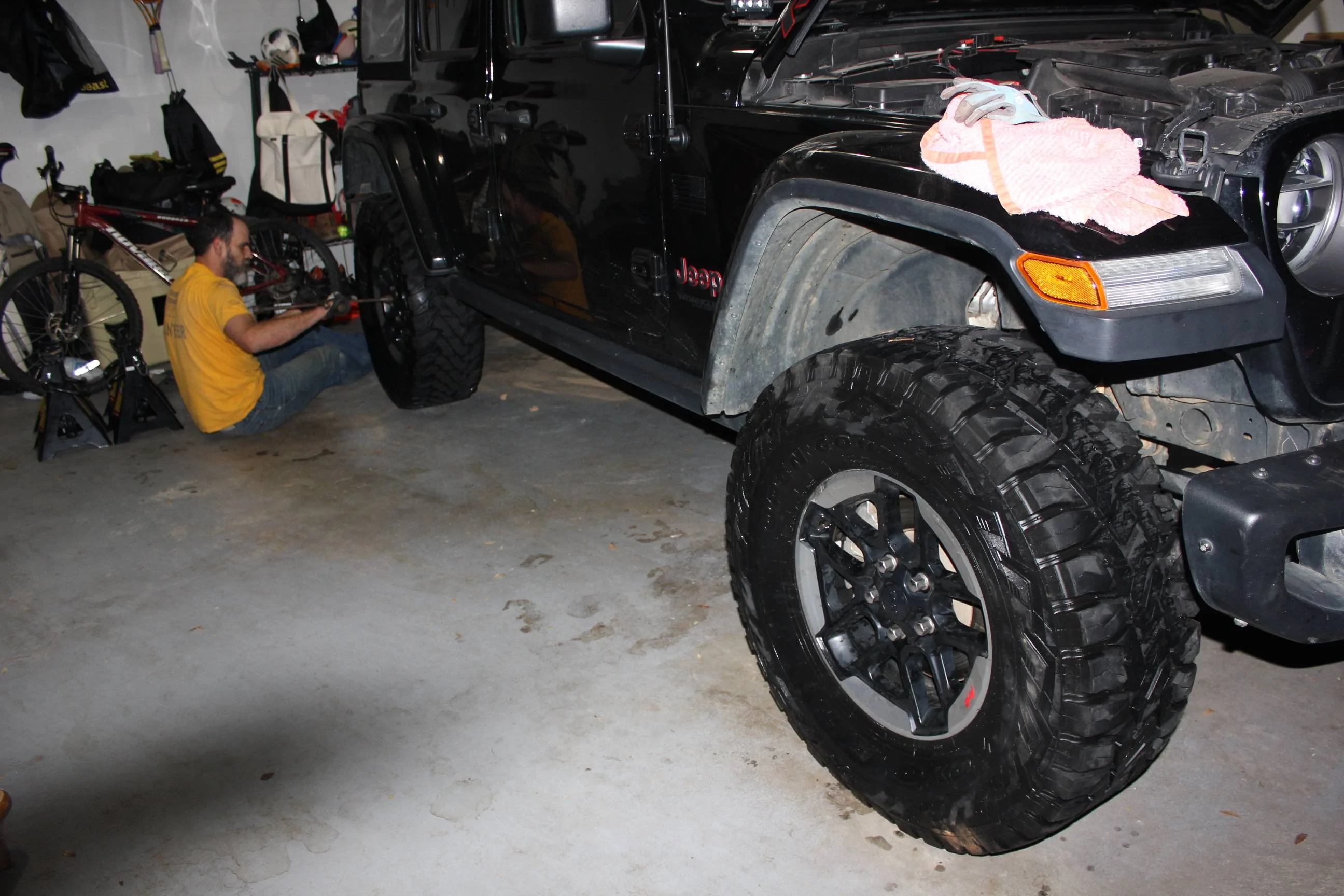

After:
Jeep Wrangler JL Tips for 392 Suspension Install on Standard JLU Rubicon IMG_2926
