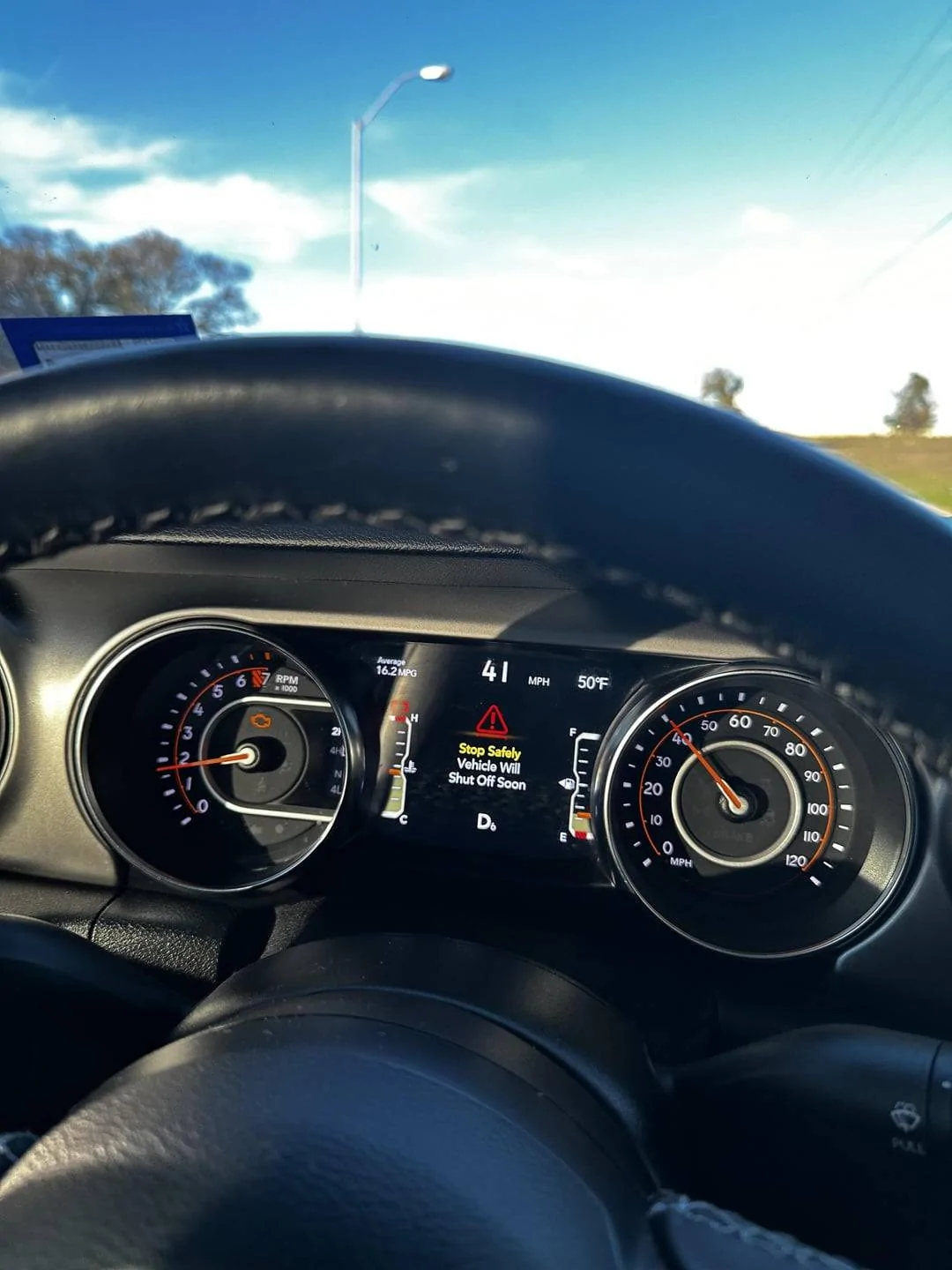

Jeep Wrangler JL Your Jeep is pretty complex safely-vehicle-will-shut-off-soon-v0-jadx5ixeau2c1

Any actual reports of this happening off road? Seems like they've only been noted to happen on road.
Either way, totally fixable on the trail. Mopar Z fuse array, no biggie install. If you're worried about it carry a spare.
Edit: even without a spare, can just swap N3 fuse to N4.
It was my understanding that this was caused by the "STAR" connector behind the dash and not the Z fuse. That being the case, it would seem to be MORE likely to happen off-road, not less.
But see this is where we are getting into territory that was foreign to me until owning a Jeep. With no other brand vehicle have I ever had to carry SPARE VEHICLE ELECTRONICS on board on any adventure where I wanted to be prepared for issues. Spare tire, tools, recovery equipment, food, clothing, shelter...spare ECM, TCM, BCM, main harness, laptop with satellite uplink for firmware download...
Yes this is embellishment but really, some of the stuff that Jeep guys propose carrying on adventures would be taken as clearly a joke elsewhere.
Actually, you just need to wiggle the fuses and make sure they're seated fully ;)
So, I know you're not like a wheeling culture person, but spare fuses are common for off road vehicles that actually get wheeled of all makes. Off road lights, winches, aftermarket electric cooling fans, etc can cause a lot of draw on systems, and a lot of folks are really bad at picking good circuits. Most folks who wheel really hard carry wiring bags with lots of spare stuff for trail fixes. More common in older vehicles with lots of stuff grafted into existing circuits, but still eminently fixable on the trail.
Nobody says to carry a spare ECM/TCM, main harness, or laptop though. I've never heard anyone actually recommend that - Jeep, Toyota, or any other make.
The STAR connector, however, is just making sure the pins are seated or replacing the cheap part. Pretty rare failure too though, not overly common at all. And you can just wiggle it often times to get the Jeep started again, so also trail fixable. But again - if you're worried about that part, it's a small spare that fits in the glove box and just takes a little time and knowhow to fix, and can easily be done on the trail.
