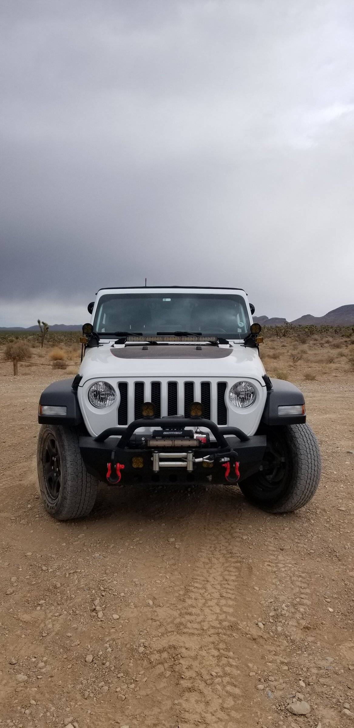

Sure have. A lot. In fact, the valley has been pretty socked with fog over the last few days, so I've been driving in the fog with both low beams and high beams as recently as yesterday.
My point is really that you should do what you want, based on how they look, since you're likely to do that anyway and the difference in "performance" will be insignificant.
I have had the DD pro fogs for at least a year now and as long as they aren't mounted sideways or backwards, they'll be help full.

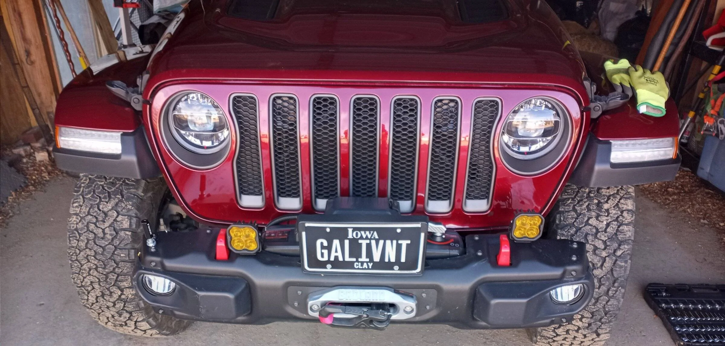

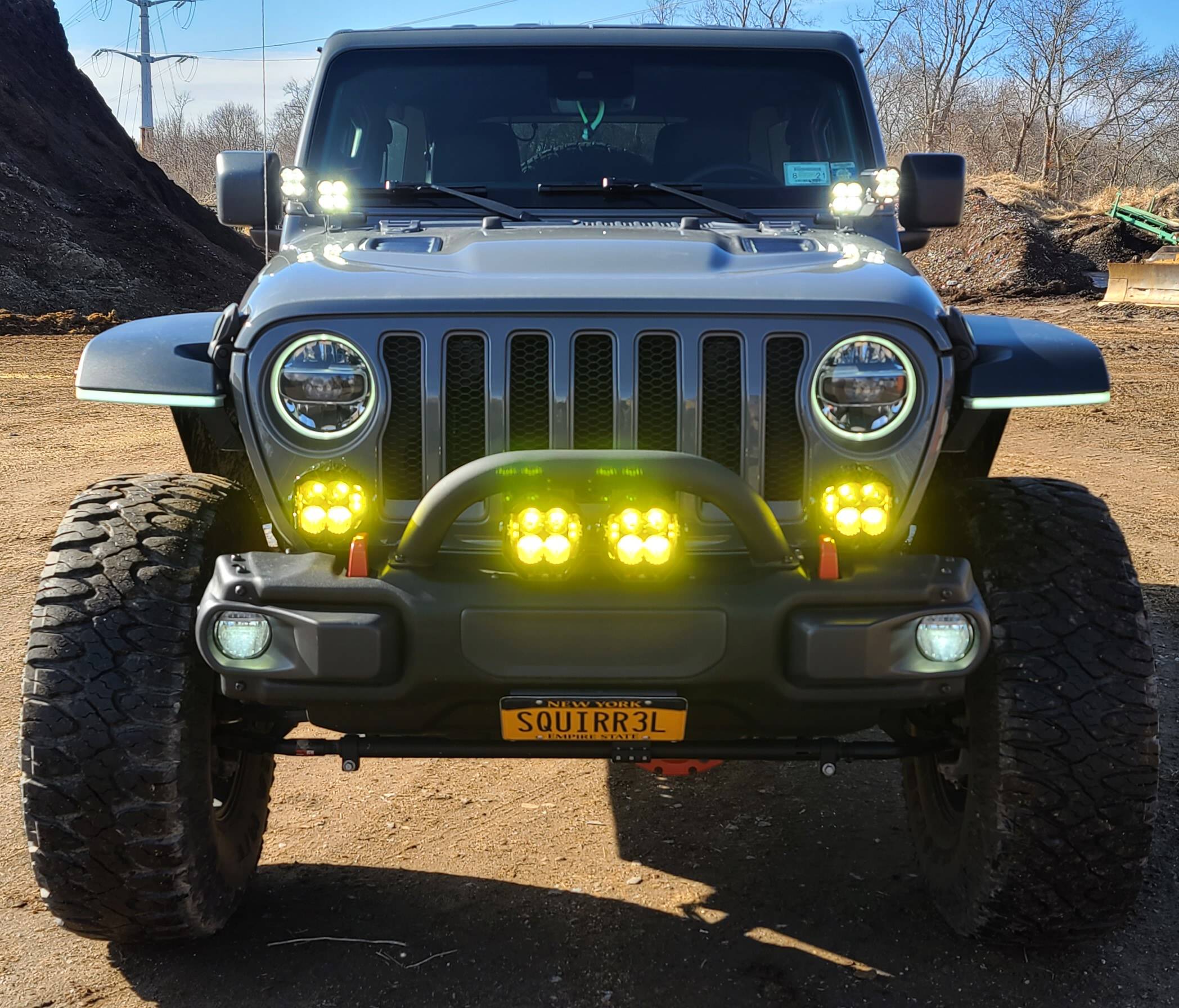

"The golden rule of fog lights installation says that the perfect fog light setup is between 10 and 24inches above the ground."
"Despite its appearance, the fog usually does not touch the ground, but hovers about 18 inches above the surface."
Above are two of MANY similar quotes about fog and fog light height. I have at least 3 possibilities where to mount mine:
A: Passenger side as shown. This is the lowest spot at 17 inches above ground. They have a quick detach plug so I could always disconnect them when off road & if necessary. This would be the riskiest spot to put them BUT also the most effective by conventional wisdom. Even when on road, in the winter, drifts are an issue here in Iowa so I can see damage there too.
B: Drivers side as shown (dis-like this look the most) at 24" above ground.
C: On top of the bumper, on the visible bolts just to the inside of each tow hook. This will be the safest spot but 28" off the ground.
I can't believe this is bothering me so much. I know it will ultimately be a tradeoff of functionality vs safety vs appearances.
Does anyone have personal experience with:
Yellow fogs...mounted higher than 24"...and actually using them in fog, blowing snow and/or rain? Mainly asking because I believe they will look the best on top of the bumper, NOT in either of the 2 places I have them sitting ATM. THX in advance.

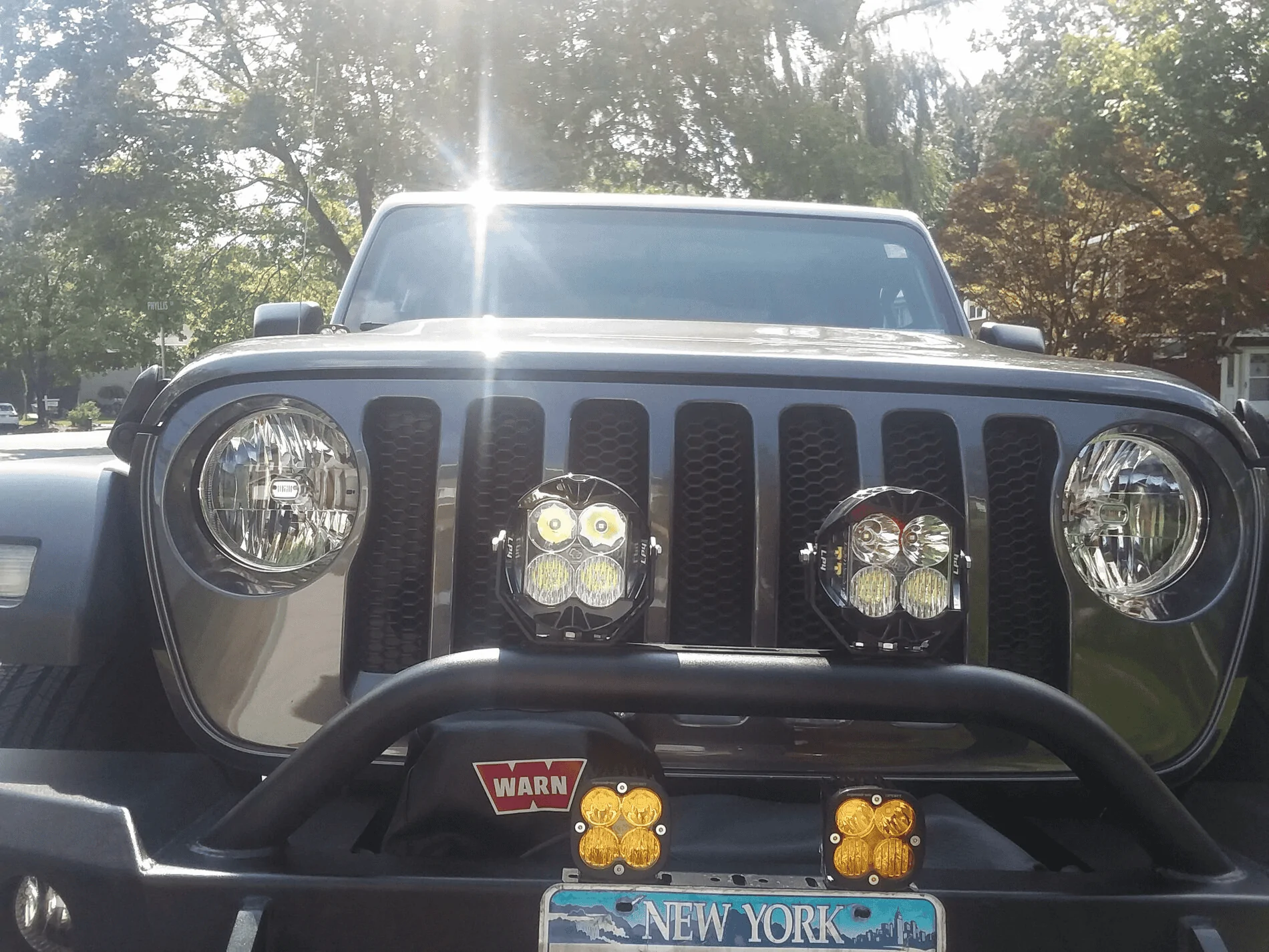

i have the baja design squadron sport driving combo in amber. so far its working good in the location shown in the pic. the lights puts out a nice spread of light on the road. the top lights are the lp4.
