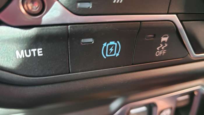

So, here it is. I've been using the Max Regen button as much as possible instead of breaking manually. For most of the time, (Highway driving) I leave it off. Around local streets I engage the button when approaching a stop light, stop sign or stopped traffic. Upon accelerating, I release the button. I do this multiple times driving around town. Basically, I'm using it in order to avoid constantly using my brake pedal. So, my question is, am I doing more harm than good by engaging then releasing the Max Regen numerous time during a trip around town? Should I just leave it on or should I just use my brake pedal? I'm just not sure if I should be constantly turning it on to aide in braking then turn if off, then on, then off....
Any thoughts and suggestions would be greatly appreciated. Thanks!

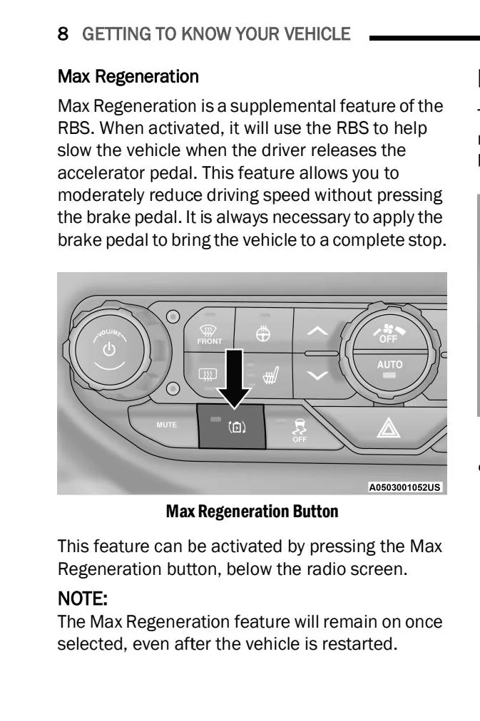

As I understand, all that button does is turn your gas pedal into more of a "one pedal drive" situation - it doesn't boost the brake. Normally, when you step on the brake pedal the car will actually use the electric motor to slow you down at first, then engage the mechanical brakes when appropriate. With the button on, you are basically telling the vehicle to slow you down as you let off the gas rather than when you step on the brake pedal.

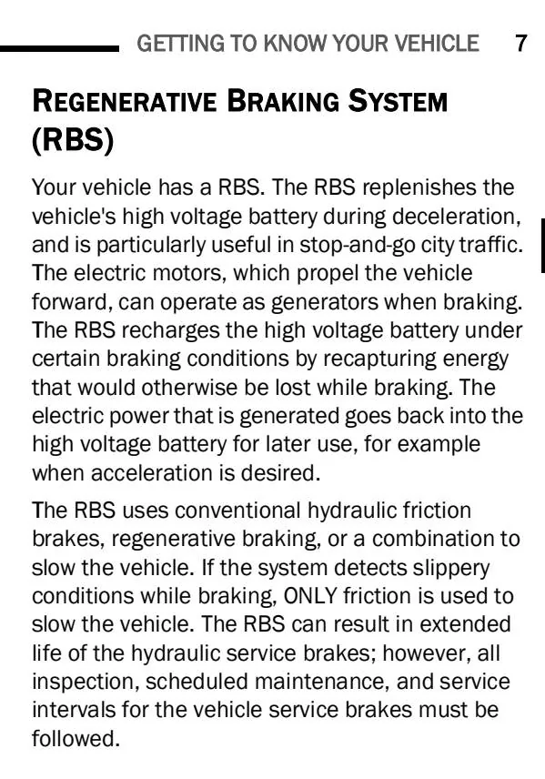

No, nothing to do with brakes. It is akin to engine braking with a stick. Many of us downshift a manual transmission as we approach a stop or want to slow - engine braking.
With these, it uses the generator to get the same effect and to help regenerate/recharge the battery while you are slowing.
We leave ours in max regen all the time - it helps get more miles out of the battery by a little amount, and is important when on long drives where you don't have a lot of slowing or stops that would regenerate or recharge the battery.
Never saw a reason to take it out of max regen, sales guy said the employees there who drive 'em leave it in that mode all the time.
Once ours was turned on - the button pressed, it's never been turned off.
I can't understand why one would be shutting that off, then back on, then off, then back on and so on. Either use it and leave it on, or don't and leave it off.
It doesn't apply or utilize the brakes in any way, think of it like a downshift and engine braking - and at the same time, keeping that battery up.
A hybrid on a long highway trip with little braking and no down-hills can use all the help it can get keeping the battery up, IMO.
You can slow WAAY down with it, but for a complete stop, you must use the brakes. Even the owners manual explains that pretty well.

thank you for the explanation - i didn't see anything like that in the owners manual...i will go back and look - Thanks Again :)
