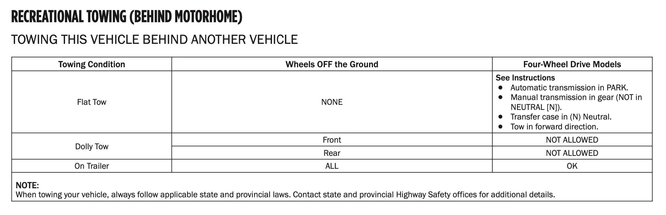

I don't knw what year the Jeep was, but I don't think it was a JL, may have even been a TJ, so this may not apply, but here is an excerpt from the 2024 Owner's Manual:
Jeep Wrangler JL Wrangler on a Tow Dolly? Recreational Towing

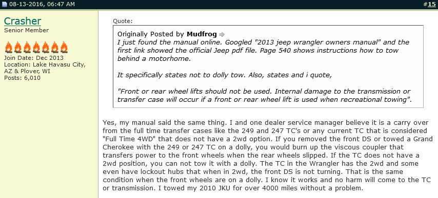

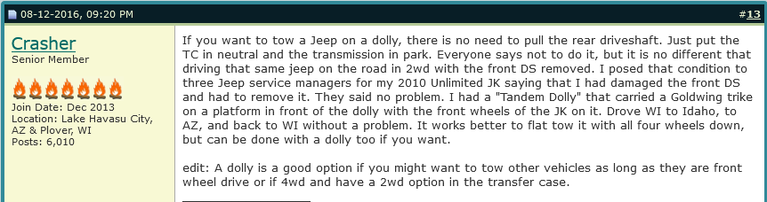

With the transfer case in Neutral and BOTH the front and rear spinning the transfer case will be completely lubricated.
Not trying to argue, but if the front axle is not engaged (4wd FAD), isn't the front shaft not spinning?
Edit- here is a guy talking about a JK on the RV forum, he's done it and says it's ok. I realize their front axle operates differently but the transfer cases are similar.
