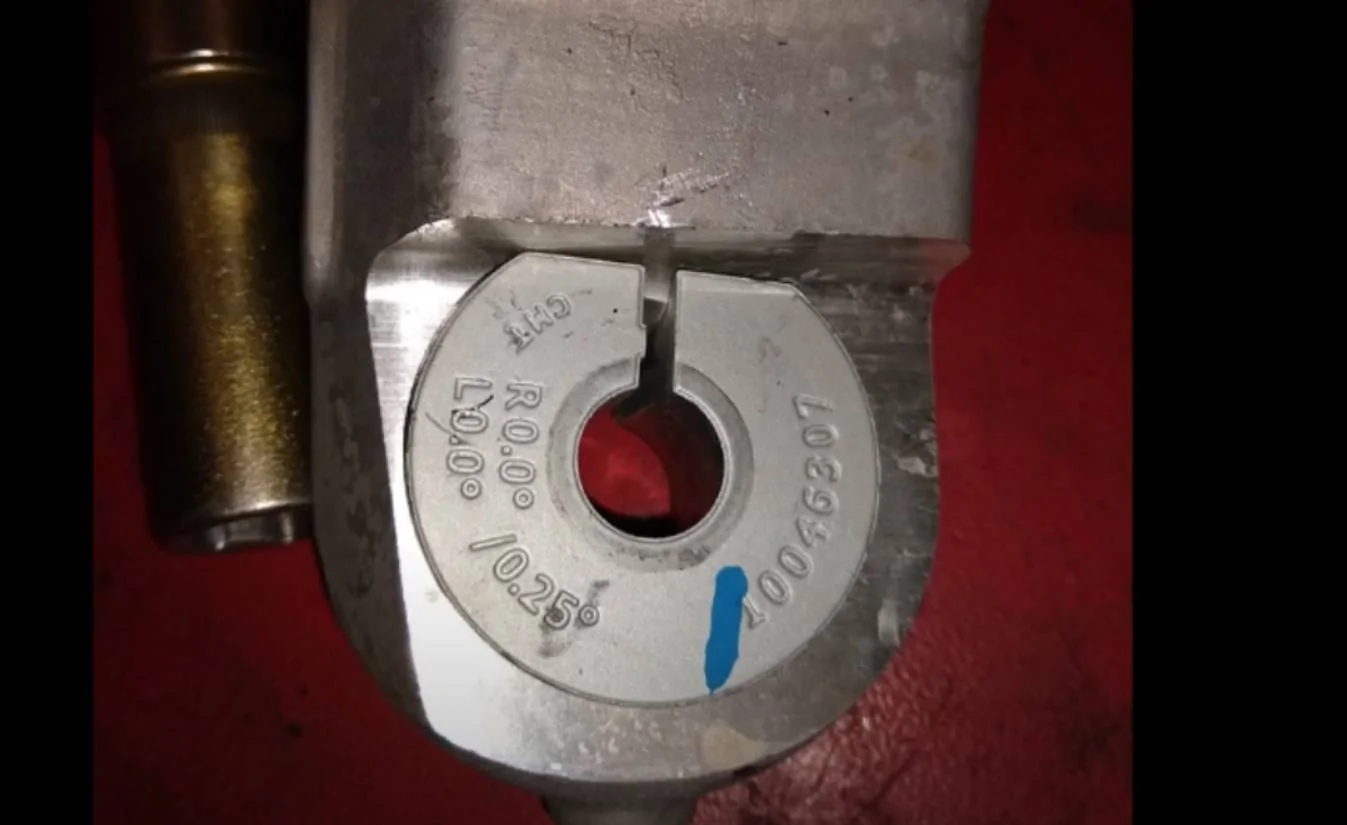

After some poking around, I found a video from SPC that shows the OEM sleeve markings as well as how to change it, for those that haven't done balljoint work before. I think you can see the markings while its installed.

Those still show the cut on the wrong side. The cut should be on the side with the flat portion.
Hmmm. Looks like they believe splitting the side with the largest flange is more important than splitting the thick part of the bushing. Has anyone actually tried to install them and had an issue?
