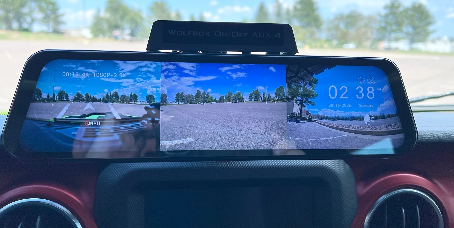

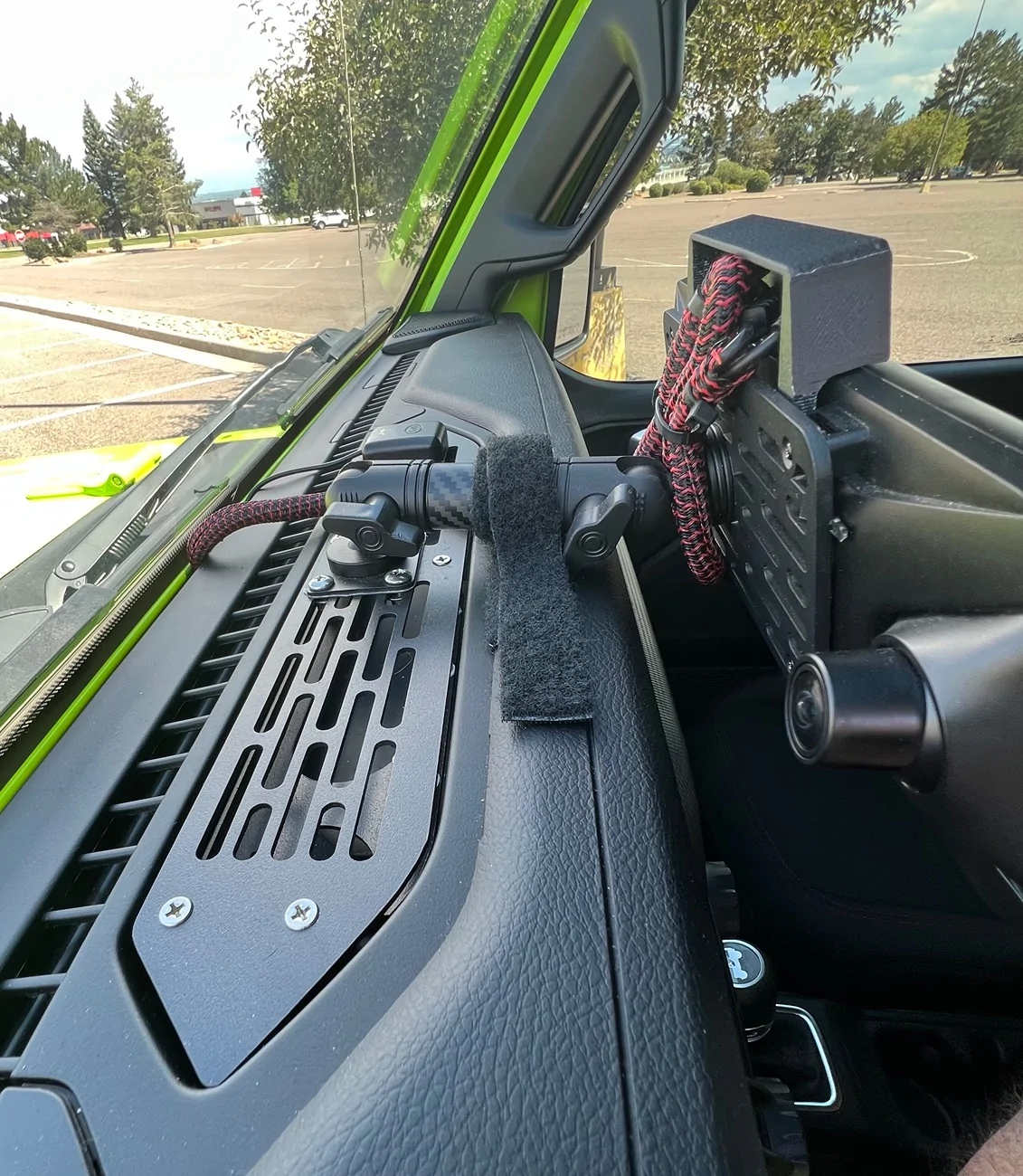

I have a 2021 Jeep Wrangler JL 2 Door and installed the Wolfbox G900 Tri Pro Bumper Camera, When it came to mounting this I decided on using a Wolfbox Rearview Mirror Display Mount with 20mm Ball from Bulletpoint Mounting Solutions & Alex Tech Black/Red 1/4 inch Cord Protector Wire Loom Tubing Cable Sleeve Split Sleeving to help hide the cables, 4cm Carbon Fiber/Kevlar Hybrid Mount Arm all mounted onto a RubiGrid Multi-Device Platform Dash Mount. When it came to running the power I used theWolfbox 4A USB-C Hardwire Kit WOLFBOX 4A USB-C Hardwire Kit and wired it to the factory AUX 4 Switch all ran behind the dash, the front bumper cam is installed on a Mopar steel bumper in a position that makes it great for use when on the trail as does the rear cam is installed in a position where it’s also useful on the trail, I also use the OEM backup camera daily so didn’t need another one so made useful use of both cameras, and the mirror itself is mounted lower on the dash and not the Rear View Mirror as this makes it easy to remove when needed, doesn’t bounce around at all, I did use Velcro to help keep it from moving side to side but that was just a minor issue. Just thought I would share my experience and hope to see others.
