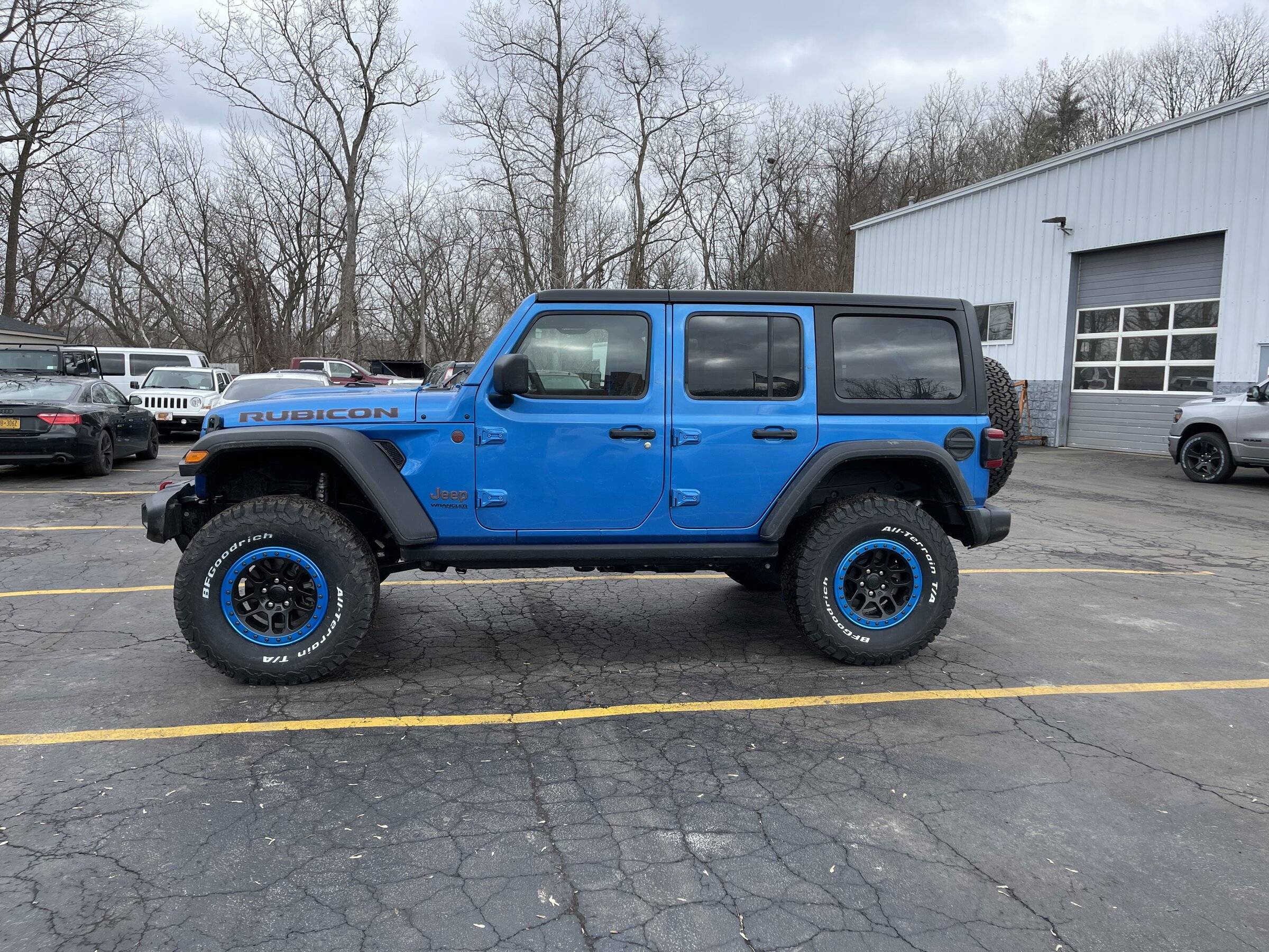

Because I only picked it up two weeks ago. I still have to get the bumper installed and it’s a little cold here in WNY
Jeep Wrangler JL Wiring Driving Lights 01528F9C-E93D-4EF6-88FB-AEADD8B5018D
BDinTX
Brad
Jul 18, 2020
49
2,949
5,465
Dallas, Tx
That bad boy looks nice! Congrats!
