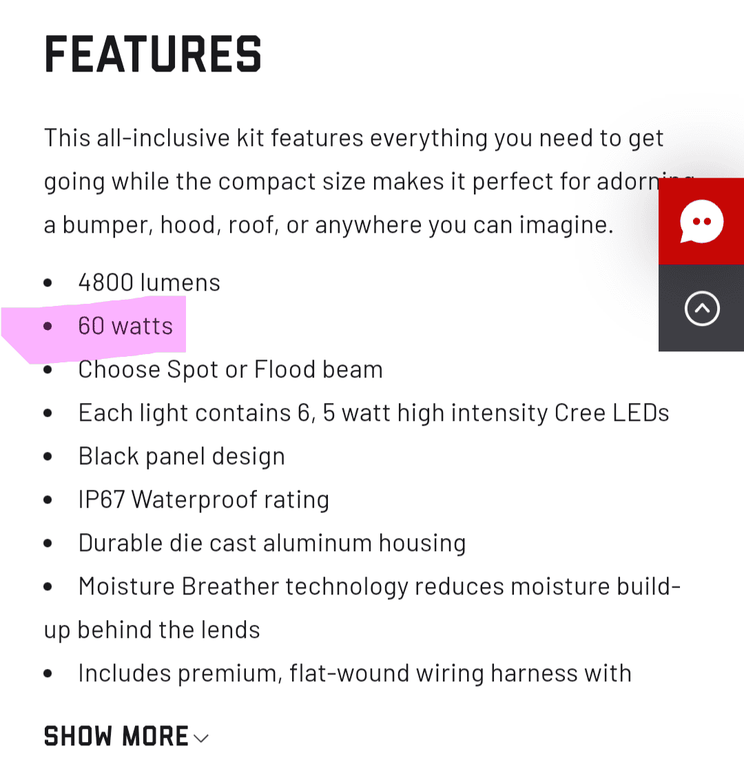

They came with my Rough Country front bumper, so I wired them into the fog light harness.
Jeep Wrangler JL auxiliary driving lights Screenshot_20240511-224208-704
As you can see they run 60 watts total, 30 each cube and I can tell you for a fact that they are plenty bright. I'm not sure if they're maxing out the wire or the fuse, but they are significantly brighter than the OEM factories even after I replaced the halogen bulb with a LED bulb.

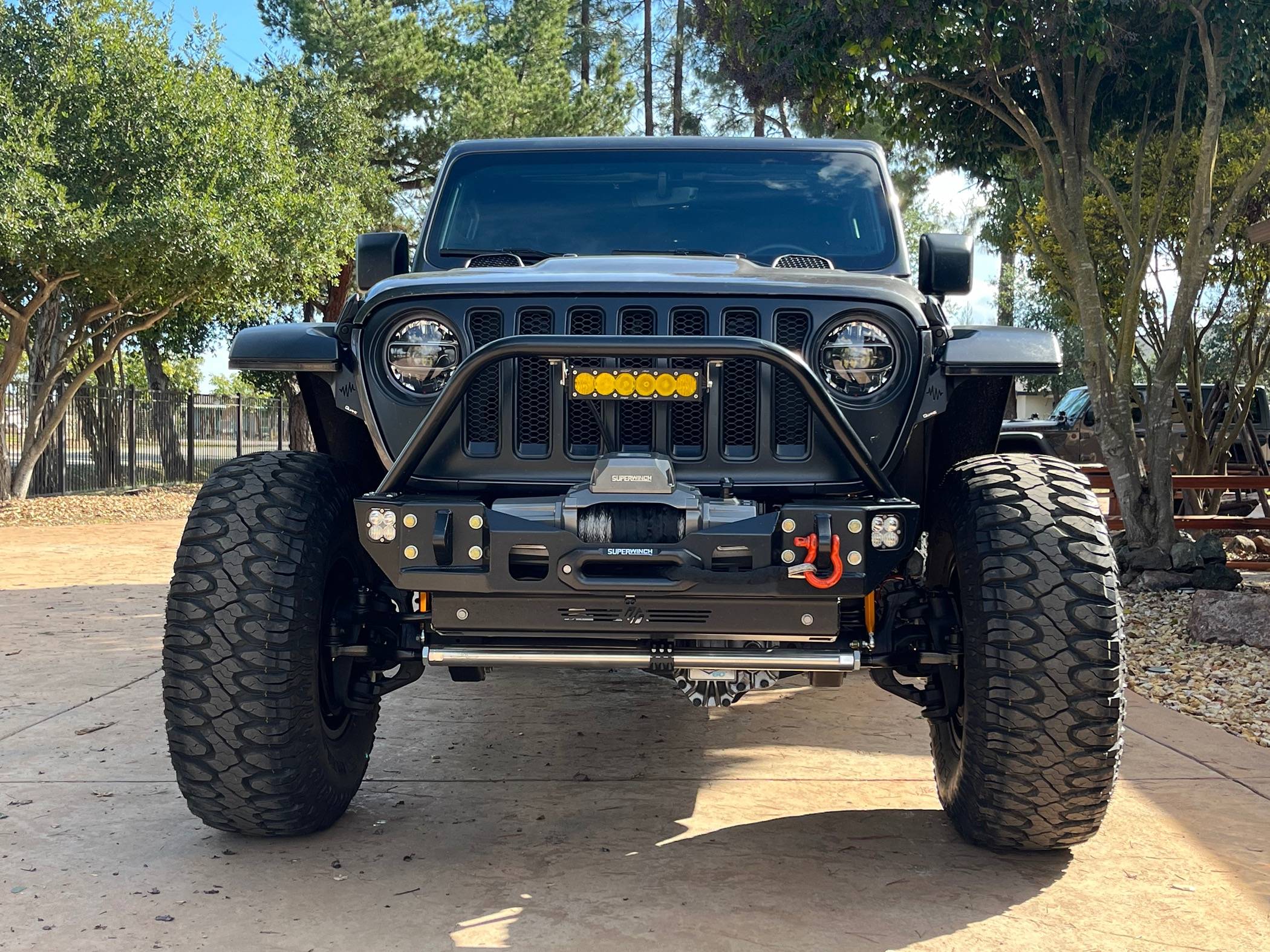

I wired my Baja Design sport lights directly to the factory fog light harness. They include an extra Doetsch connector in the box and I just swapped it for the factory connector. Been running it that way for 3 years without issues.
