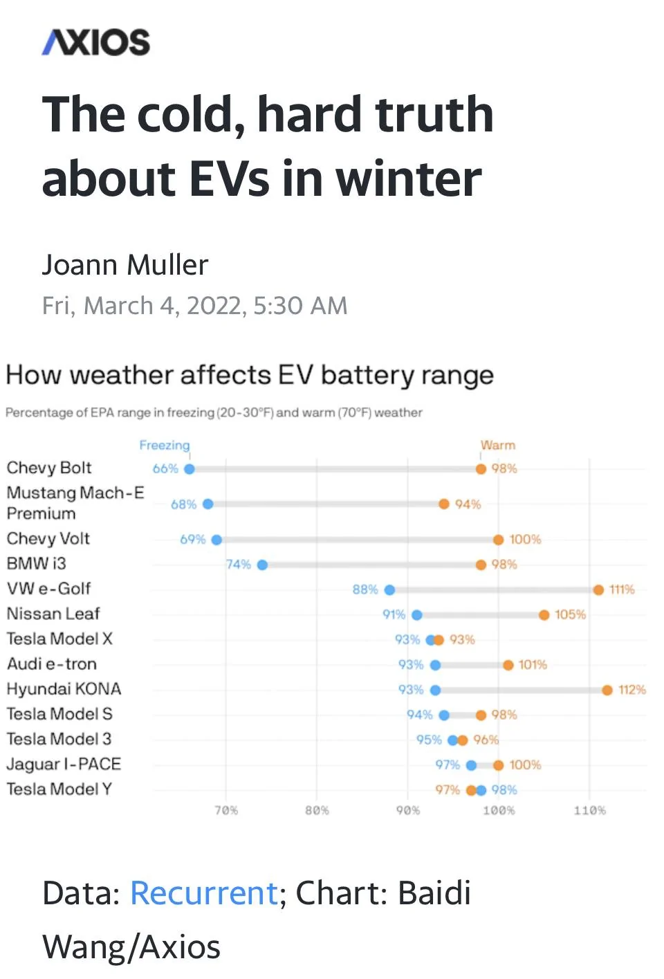

Im on my 6th JL and also have had a Tesla Model Y for a year now. The Tesla battery gets absolutely murdered in the cold. I lifted it and have Fallen Wildpeaks on it so that hurts the distance but the cold will hurt it more than anything.
Yeah, this is a huge problem with any EV or hybrid - batteries simply don't do well in the extreme cold. It is one of the reasons that ICE engines will continue to be with us for a few more decades at least. Barring a major leap in battery technology, EVs simply don't work
