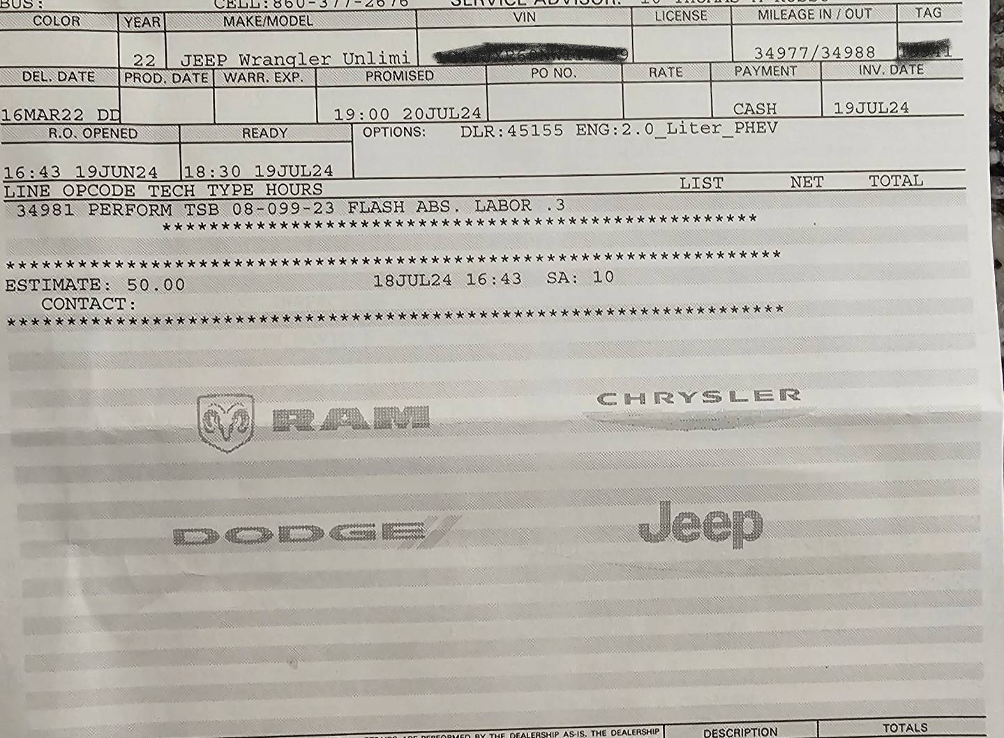

I got the software update TSB today from my local dealership. Time to regear for those 40s 💪
