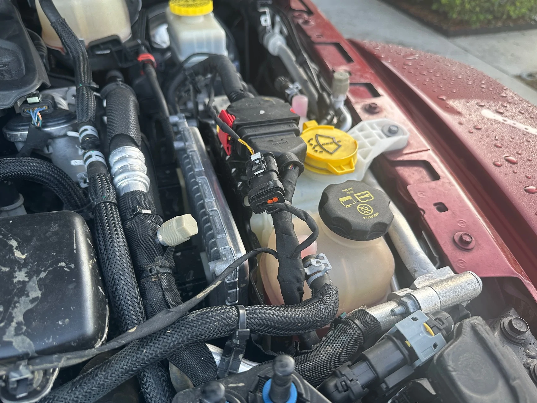

My pump took a dump too. Prolly rainx.
Jeep Wrangler JL Windshield washer pump on but no flow IMG_3217
How did you get to the pump? I thought I could get to it from the wheel well but can not. Did you pull the ECU and was it trickier than disconnecting the wiring and 2 bolts? Was hoping for a 10 minute fix but it may be more.
Thanks.
